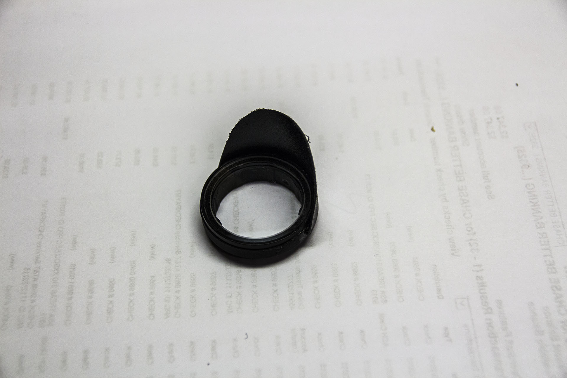

I used two washers super glued together and velcro total weight is 6ozs. The reason for using the weight was the extra weight of the hero4 black camera versus the hero 3+ black and the lens protector/sun hood see photo. The sun hood cut prop shadow when flying into the high noon sun.
