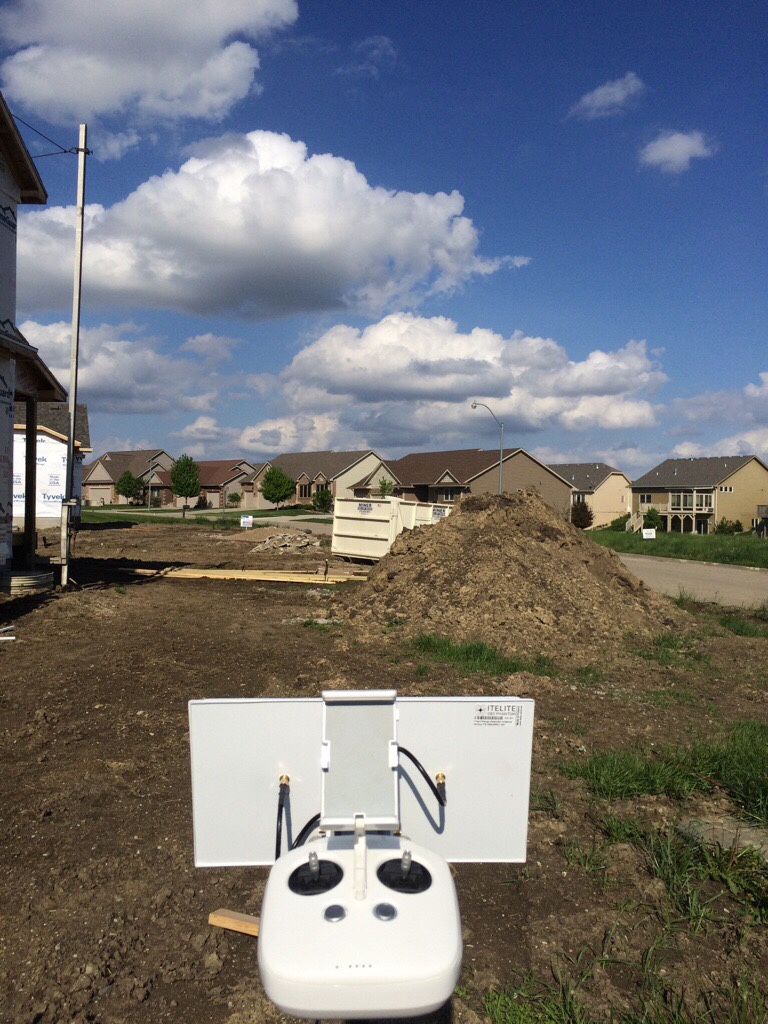

I only call it poor performance because I took the maxxrange and the terminator out those distances flying from inside the pocket in this photo which basically placed 100 houses between me and the bird. I thought for unboosted this was incredible and the subdivision full of Wi-Fi and houses. So would be interesting to see what you got with good cables. That was with controller 300B by the way
