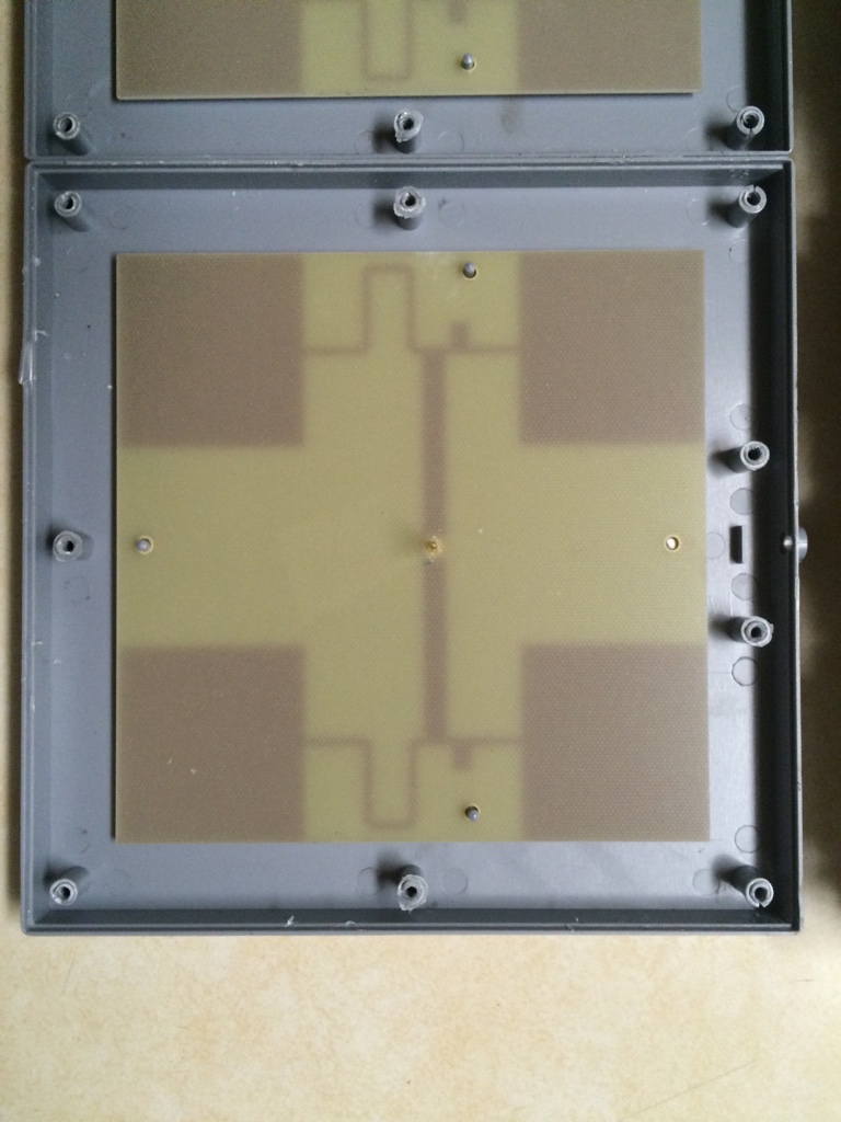

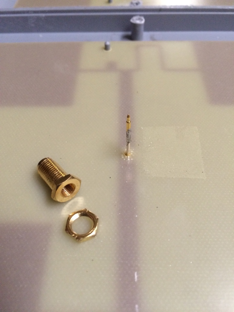

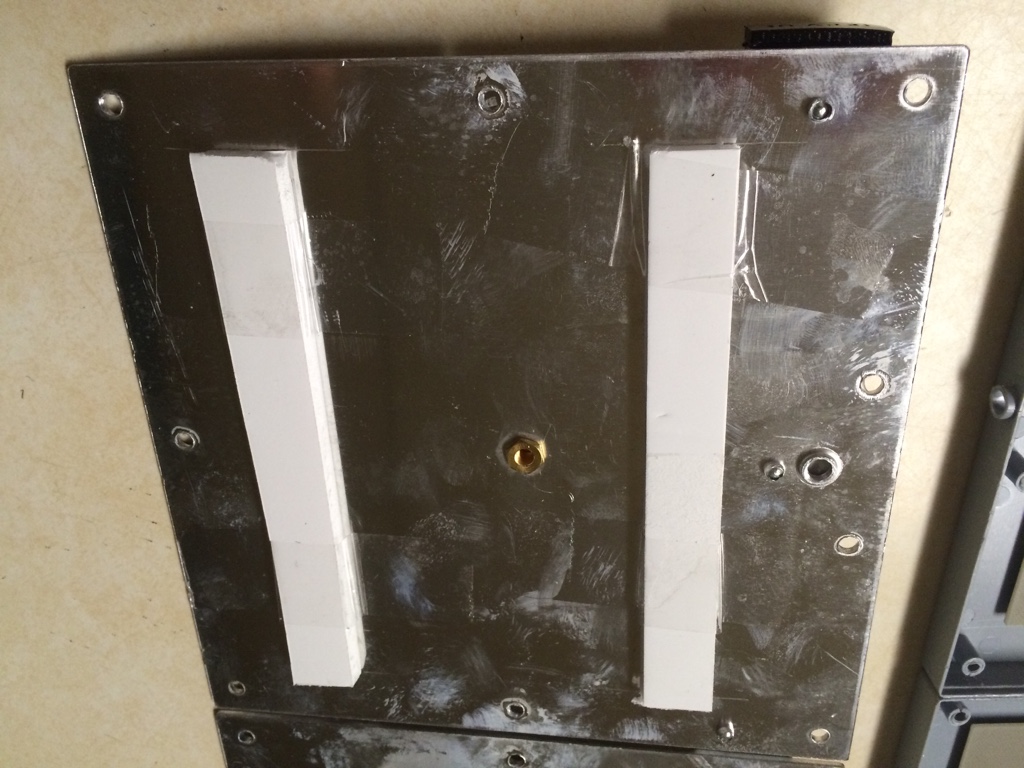

Hey Max since me and you are the only ones who put numbers with these panels i think its safe to say these cheap china panels cant compete with the panels that have proven their distance like some people seem to think...im just going to turn this into a build
So plugged the bottom holes and prepped and painted...my connectors were supposed to be here today but they didnt come.....here they are..hell i might even airbrush some skulls or something and cut some decals..also these things are heavy and uts because of the metal backplate so i might replace it with 28awg galvanized steel....or do it on the next set.

Good job pro very professional cant wait to see the results:cool:

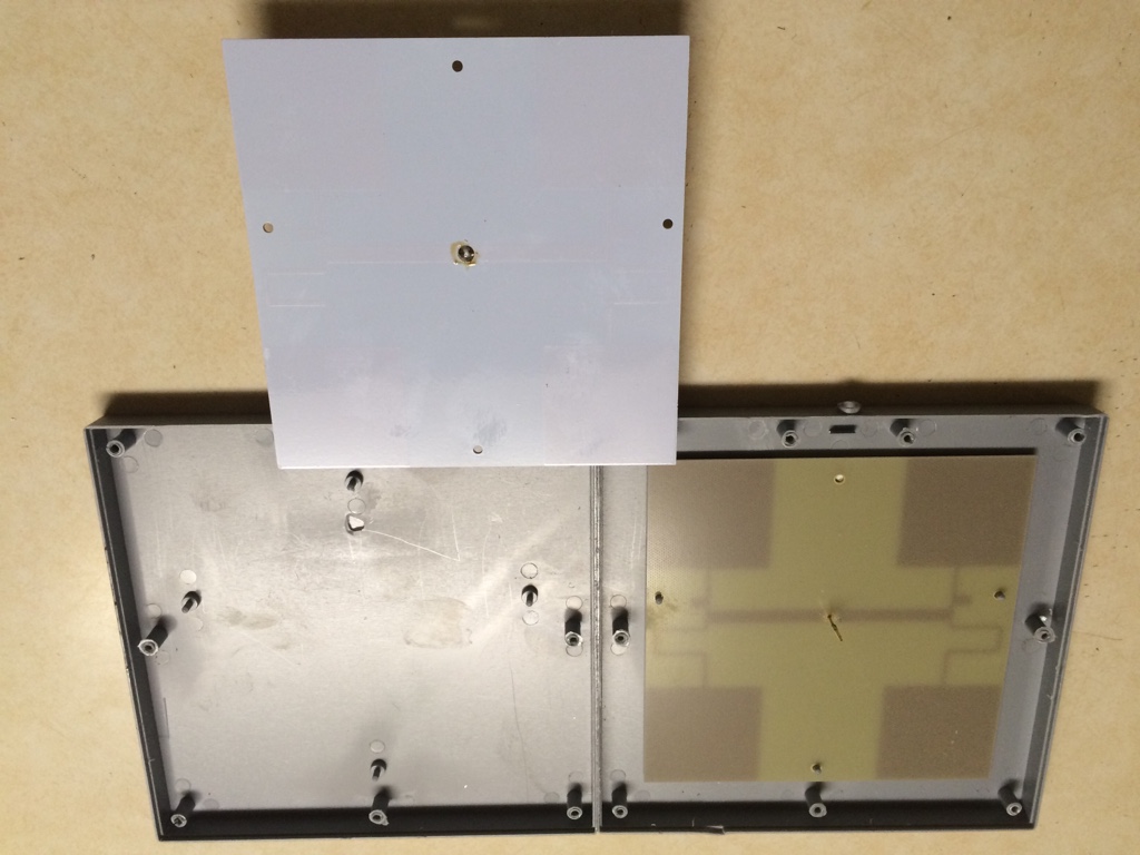

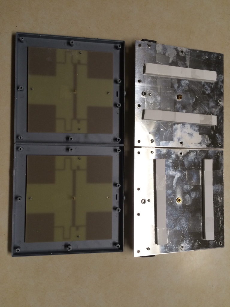

I took my CCP apart ,looks just like yours. some more sticky tape is needed.

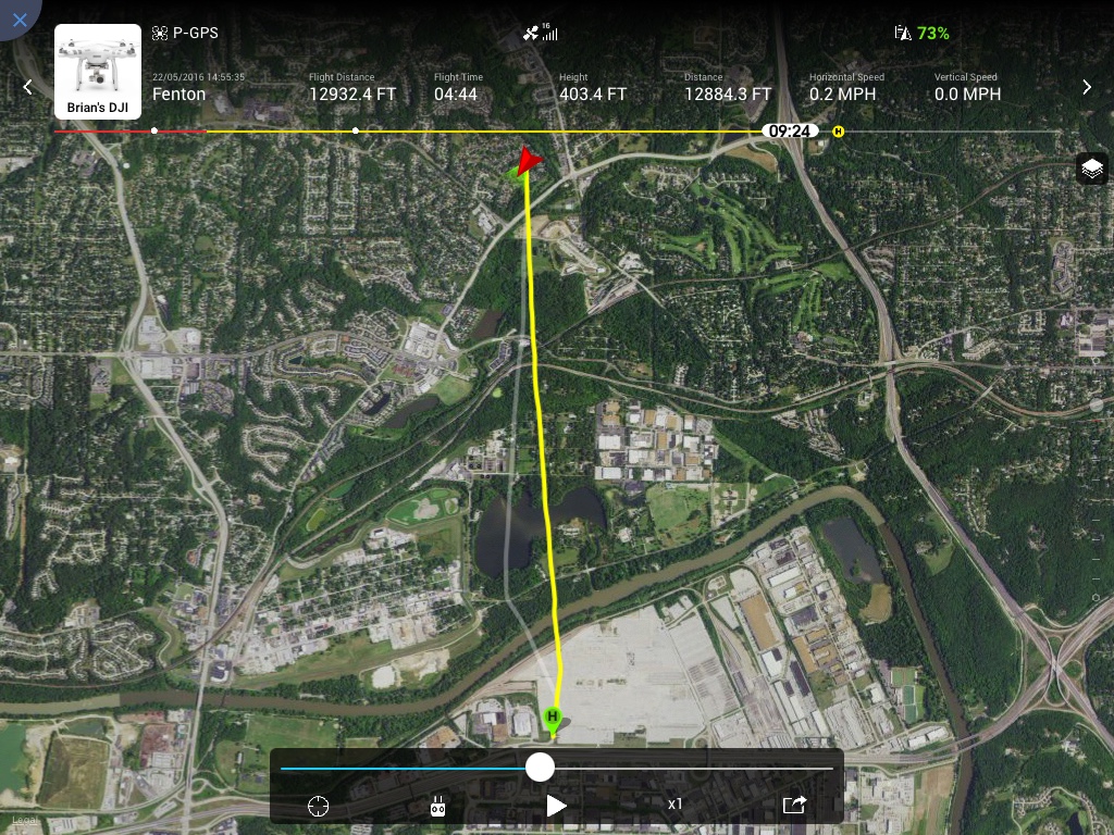

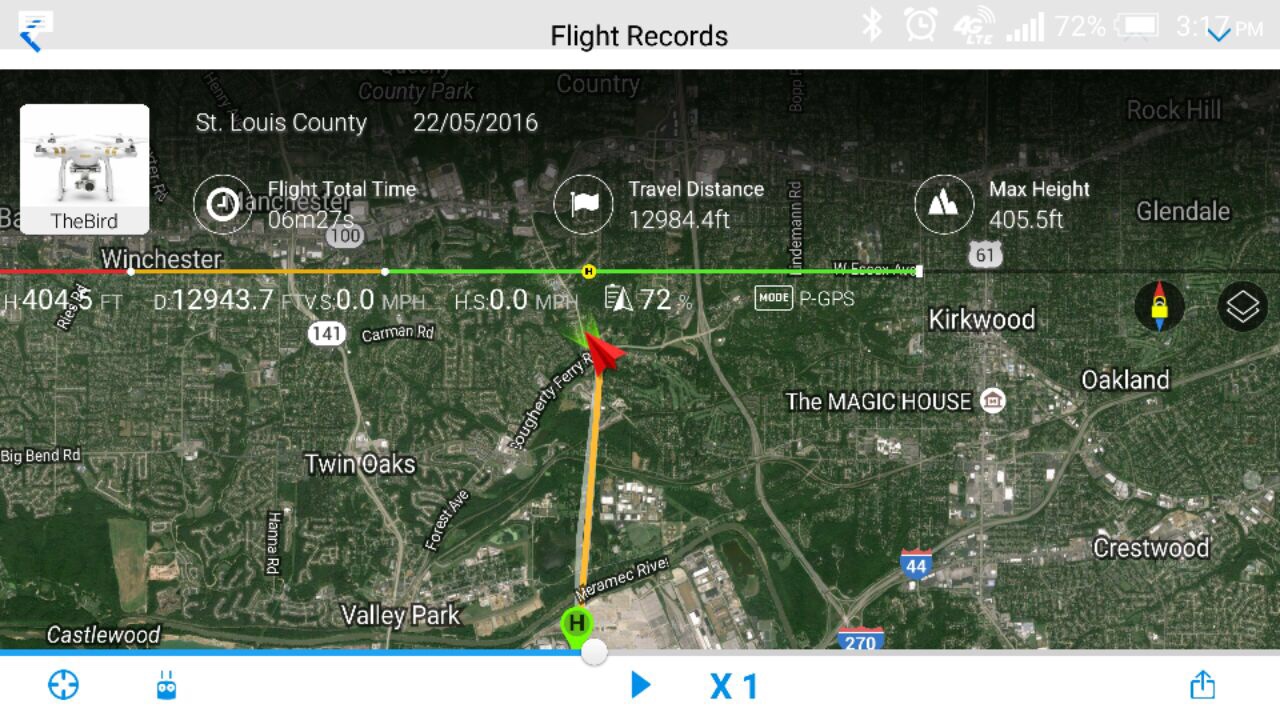

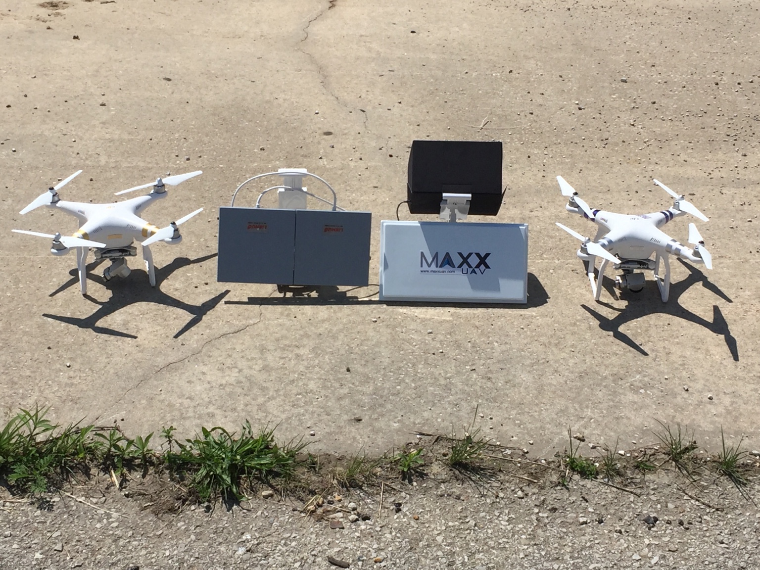

My post 828 on May 22, 2016 in the Maxx VS Terminator. Long distance antenna shootout! thread. I called the Liehou Chinese panels the Governator.
Test 1 (performed sided by side at the same time) (no screenshots)
P3p Governator Unboosted (using c model controller) 12044.3'
P3a MaxxRange Unboosted (using b model controller) 10803.0'
Test 2 (performed sided by side at the same time) (see screenshots)
P3p Governator Unboosted (using c model controller) 12943.7'
P3a MaxxRange Unboosted (using b model controller) 12932.4'

Excellent work! These are the results I remember seeing when I started posting in the Maxx vs Terminator thread. Glad there is a thread for this now as I'm very interested in the results people will be getting. Hopefully questions will be better received here, the other thread seems extremely hostile towards them. Based on the screenshots it looks like you were in a pretty heavily populated urban environment is that an accurate assumption?
Thanks! Yes, we were flying over a bunch of houses, and there were industrial businesses and warehouses near the start point as well.
Though it's hard to tell, our start point was in a valley and we were flying uphill.
Hey B have you tried them on the same controller yet? I know the the different model tx's have different power outputs. Do you plan on or have you opened the govenator up yet? Lol like the decal btw
Yes, I got pretty much the same results in doing back to back runs with the MaxxRange and the Governator and they were neck and neck and not much different. Shortly after, I found that my cable inside the controller was coming loose and was experiencing signal loss, so I wasn't sure if my results would be skewed because of that and maybe that's why I didn't go further with the Maxxrange. I replaced the cable but haven't had time and the weather has been terrible (heat), so I haven't done the back to back again.
I just remembered that my controller is the b model, and my buddy's is the c model. I failed to include that, and will edit my post to include that info. Thanks for indirectly reminding me!
I did open it up, but left it soldered in the middle. After seeing DB's opened up, I am 100% convinced the only difference between the Terminator and the Governator is the foam and connector in the center. The boards are identical.
