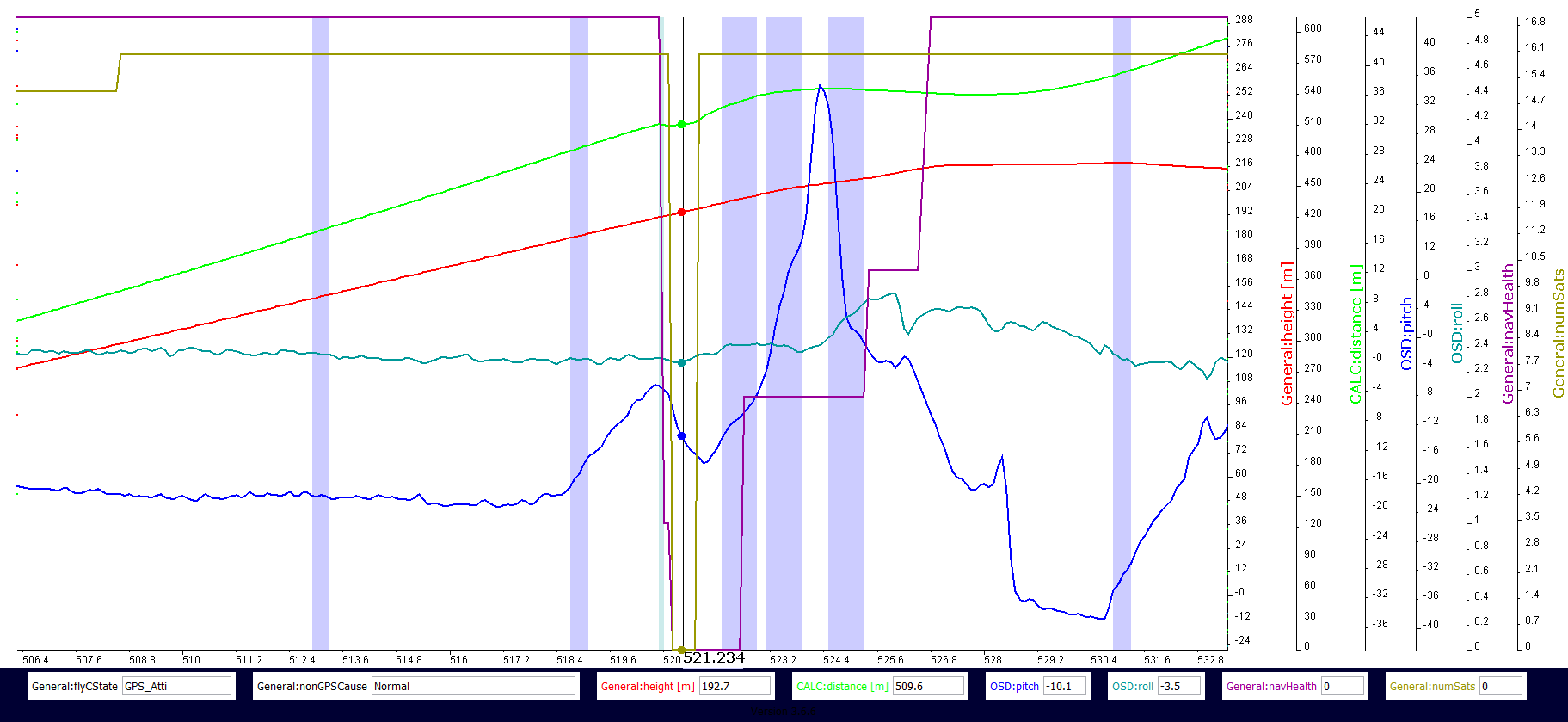

While filming a mountain peak recently, I suddenly lost control of my drone for a few seconds, but quickly regained control and managed to save the drone just before hitting the mountain. Later, when I watched the footage, I thought that this might be due to a bird attack or strong wind. But I may be wrong. What do you think? Thanks.

I would up load your flight log from your mobile device to here: DJI Flight Log Viewer | Phantom Help
Share the result url back here if you want somebody to look at at.

Wow, another P4 with zero satellite count, I don't know if this means diddly but it sure is weird.
Your log at: 8min 41s

When the number of satellites is zero, the drone appears to be exactly where I lost control. I think that explains everything. Still, I'd appreciate it if I could get a comment from the masters.
Reactions: RodPad
@OOO .....Agreed as above. The sudden "bump" you noticed was the recovery from a GPS dropout. The aircraft never switched to ATTI and recovered. You can see the pitch down then large pitch up when GPS recovered.
Thank you very much. Is it a normal behavior during GPS loss? And why drone did not switch into ATTI mode? I remember that I responded very quickly to save the drone. But I really don’t remember what were my stick moves before the event.

@OOO,
"And why drone did not switch into ATTI mode?"
I think it was some kind of timing issue, it was only .5 seconds.
Maybe not enough time to give you a warning and or message.
If you want more info? Supply the .dat file from the Phantoms Black Box "SD Card"
