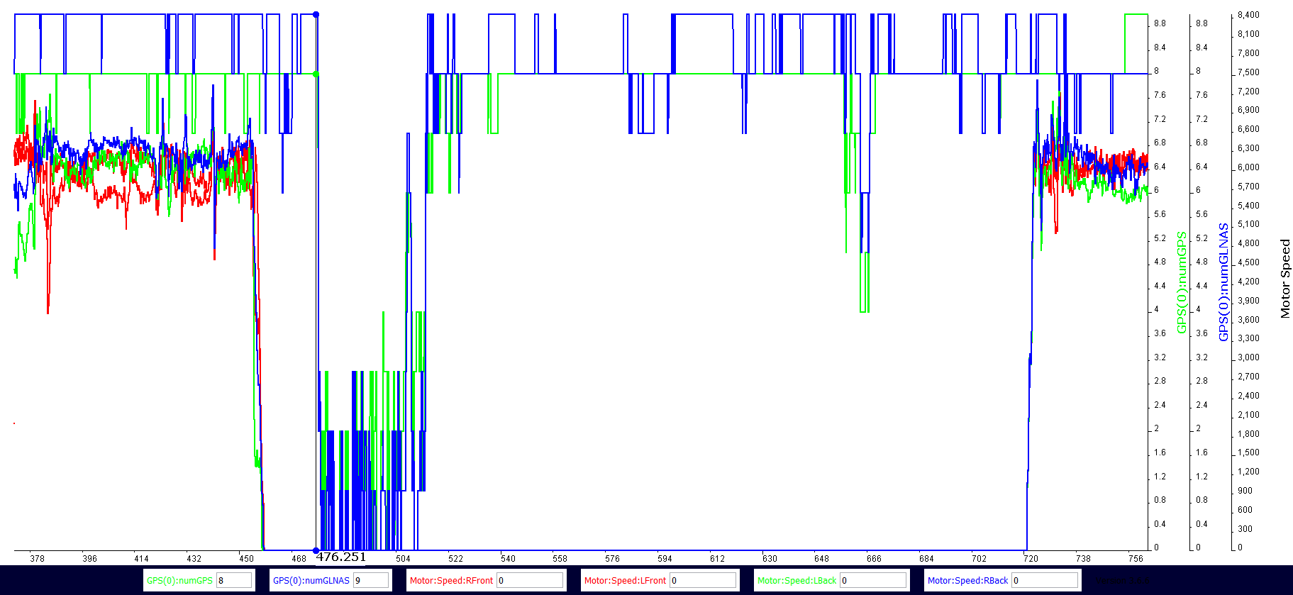

@BudWalker ..Hmmm....Something else happened just before the Nav Health Drop....Why would the motors stop reporting for so long??? There is more data missing as well, but that was the most obvious.
Reactions: OOO
@OOO .... Did you land , shut off the motors, then re-start again in this flight? This data is confusing. They are not matching up, time wise. Unless I am looking at this wrong.

No. Could it be the wrong dat file? Because the date of dat file and flight log is not the same.
The text log says it is FLY533 so apparently it is correct.

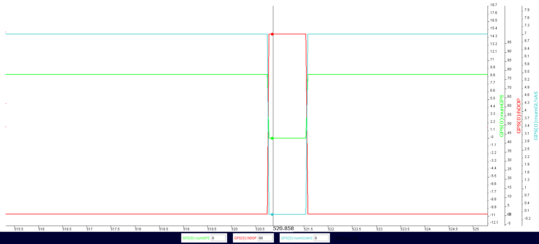

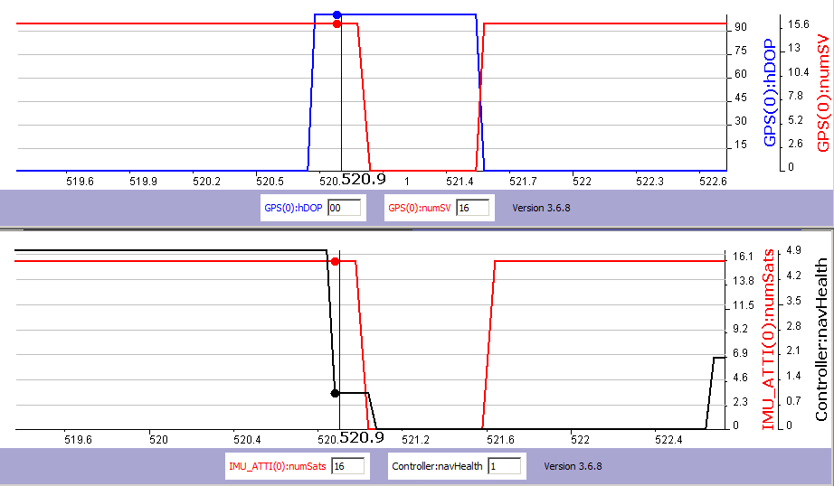

@OOO ....Just so he knows @BudWalker FLY352 is the correct .dat. The GPS dropout shows there as well. Immediately followed by the hdop going to max. This lasted almost prcisely one second before the GPS recovered.
Reactions: OOO
It seems that something is wrong with GPS unit. May I ask what hdop stands for? One more question, do you see any user/piloting error in this flight. Thank you for all your efforts to clarify the situation.
So, this was all caused by a problem with the GPS unit. More specifically, the hDOP went to the max value which caused the FC to reduce navHealth to 1 then 0.
Also, numSats went to 0 after hDOP maxed out. It's not clear to me if the numSats actually went to 0. It's possible that the GPS unit or the FC could have set the numSats to 0.
The following is from the eventLog stream suggests the GPS unit encountered a HW problem
520.756 : 28543 [L-GPS]<GPS ERROR>m8_check_hash_failed[1] gps [0][0]||
520.880 : 28550 [L-FDI]NS(0) GPS(0): fault on , abrupt
521.080 : 28560 [L-FDI]NS(0) GPS(0): fault off, abrupt
@OOO this is clearly a HW issue and not a pilot error. As for your question regarding hDOP @Fly Dawg knows more about this than I do.

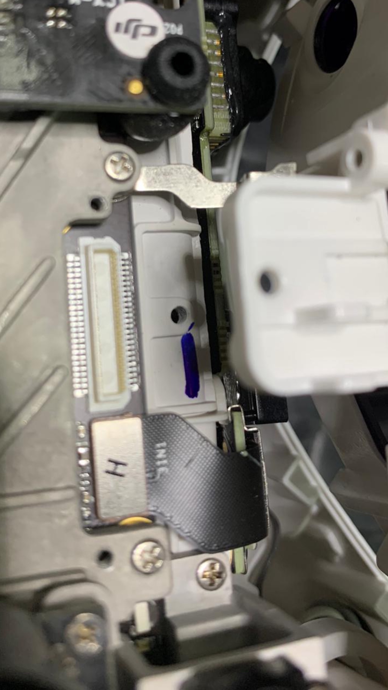

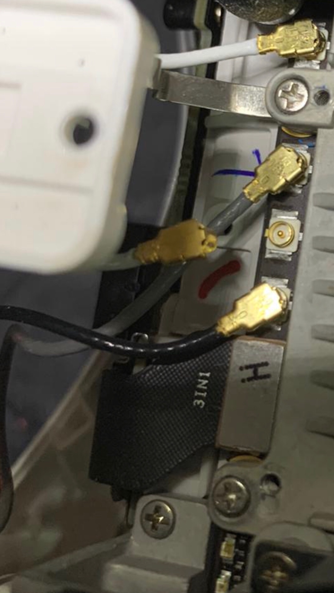

I learned a lot from this thread and the others, not sure if know any more, but there is a GPS hardware problem on the P4s. I can't tell from the picts what is the defect. So I don't know if others that want to look inside there P4s are going to know what to look for?
