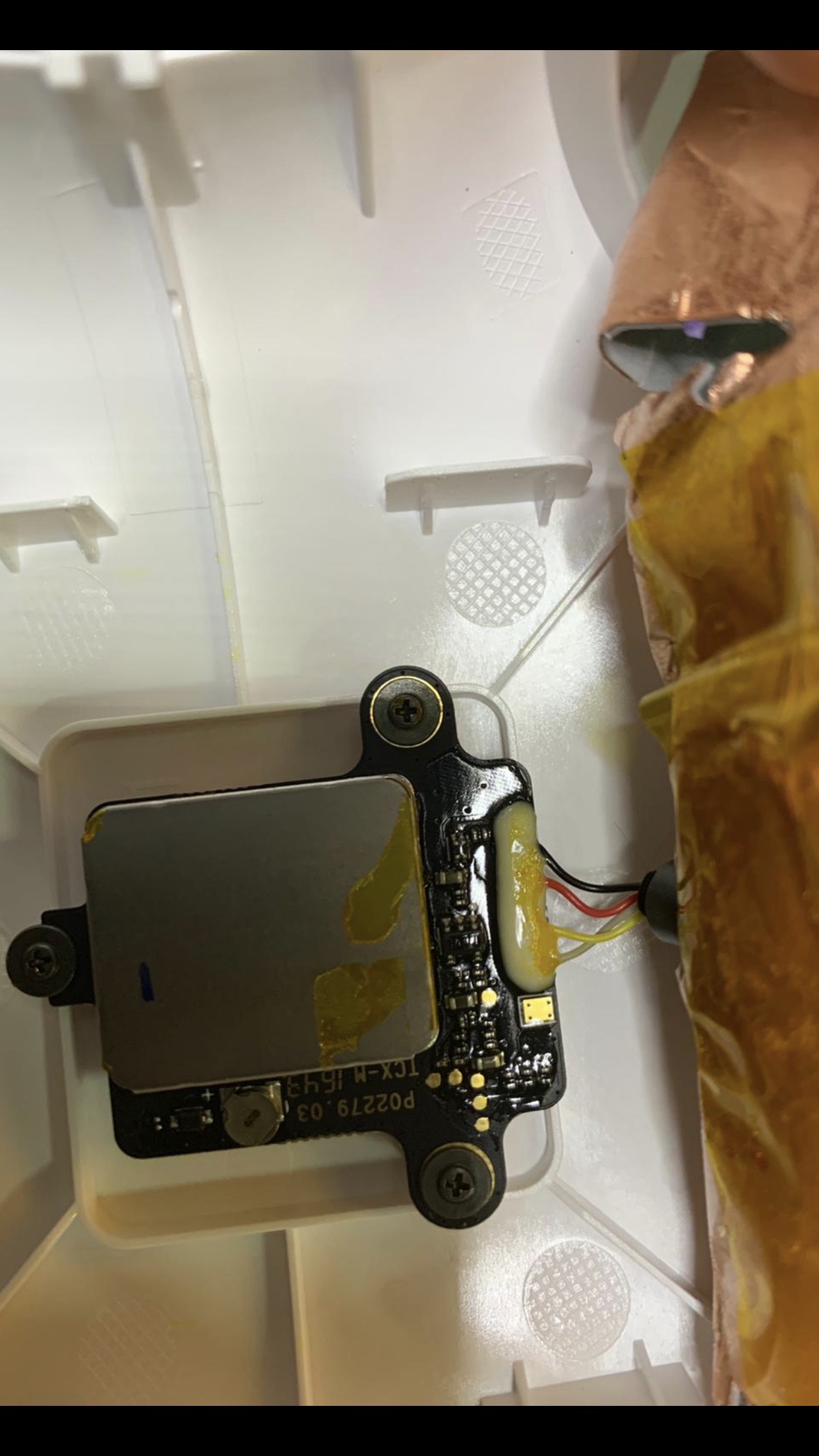

Hey I do have question about the plug show that's not conected,,,does this have something to do with GPS module,,,I just ask that cause GPS has different connection on it,,a 5 pin plug.....if anything gets replaced I be asking for the old one so I know it been done

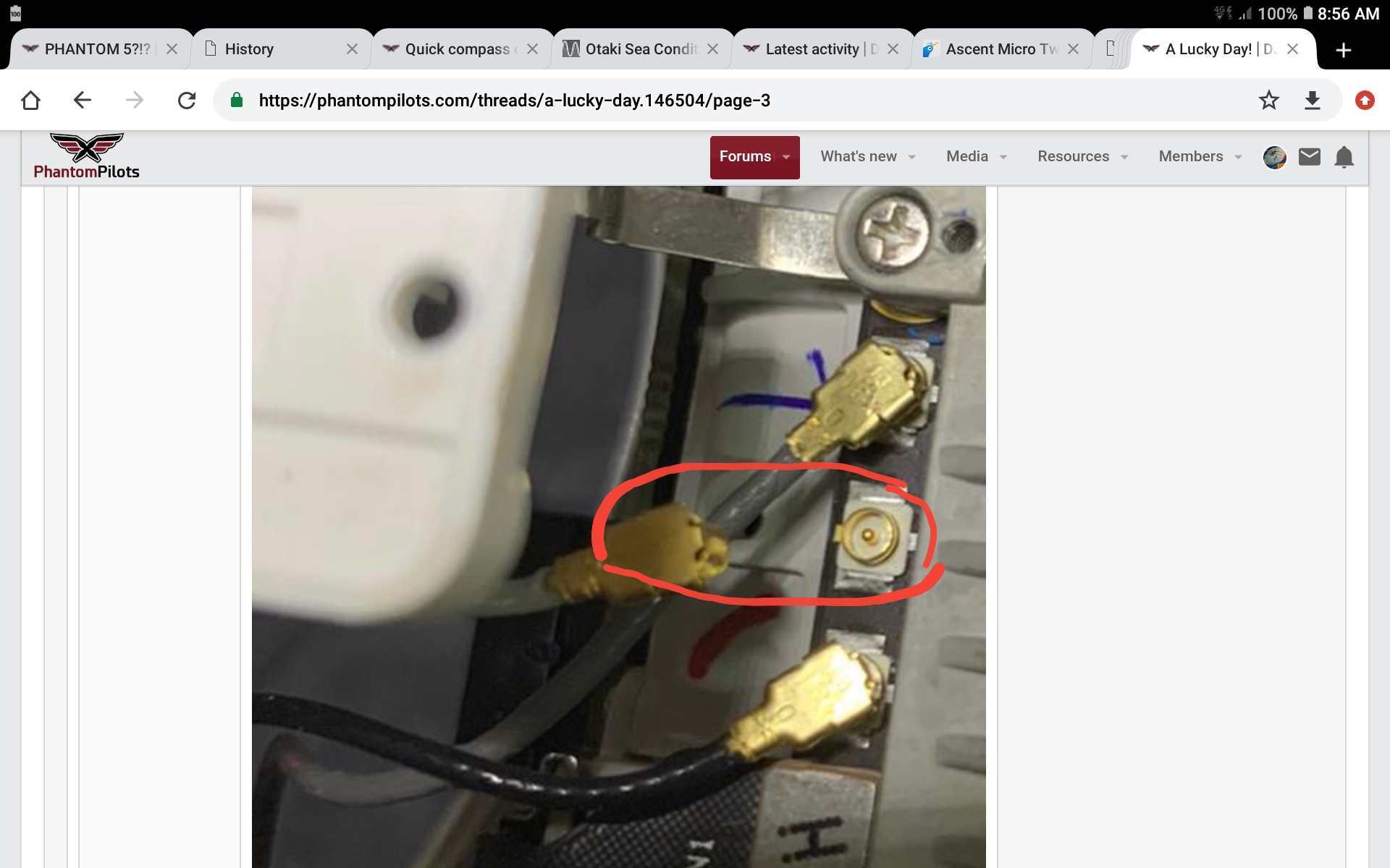

I've never opened a drone myself. Thus I really can't answer this question. But maybe @Fly Dawg and @BudWalker can help us with that. Do you see anything wrong in the following photo?
Um it looks ok but without another to try it's a guess,,I have just learnt the pro and the standed p4 have different plug,,,p4s has 5 pin and pro has 4 pin plug on GPS,, if that wire shop take picture of that unplugged either compass or antenna wire could be the issue of fault,like sats dropping out but this is just a thought,,as mention if they do change GPS make sure they show old one or you could be getting charge for something that not been replaced,,I'm heading towards that wire is a compass wire being it white in colour but that would bring a compass error ,,and same with GPS module I presume ???still stratching me head on this,,,
