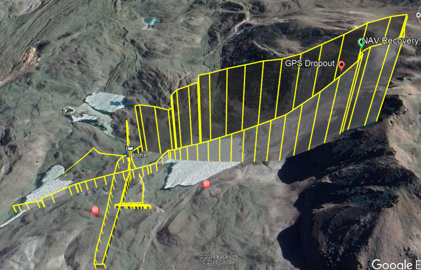

Just for the sake of notation, below is your flight path which shows where the GPS dropout occurred. The sat count recovered in less than 1 second, however, the NavHealth took a bit longer. Generally when that number drops below 4 the aircraft will switch to ATTI, but in this case it did not. It could be firmware related such as a change in the timing interval, but this I am unsure of.
Very nice work! Again many thanks for your efforts. When the drone goes into ATTI mode it usually takes much longer to recover. But it this case it occurred in less than one second. This is strange. I didn’t notice any “aircraft disconnected” message during the flight. I don’t know if the drone responded my stick moves correctly during the event. But as soon as I realized that it was about to hit the mountain, I immediately push the left stick all the way up and the drone responded accordingly. Do you see any other abnormal behavior in this flight? Any piloting error?

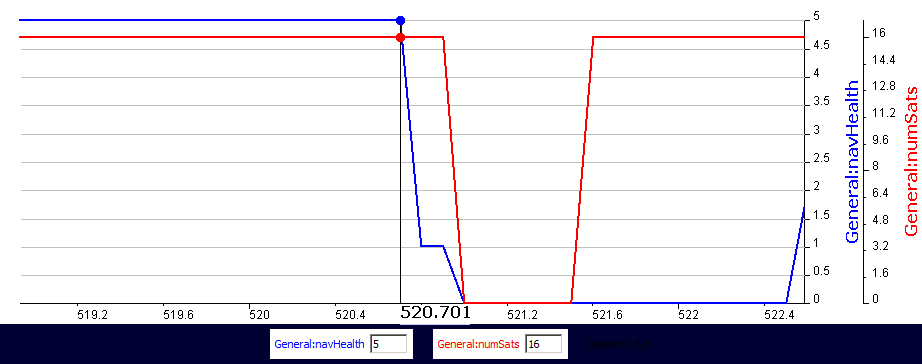

GPS wasn't lost in this incident. Instead navHealth went to 0 which then caused the Go App to stop reporting the the number of satellites. The .DAT will show actual numSats

FLY533.DAT is the correct .DAT file.
