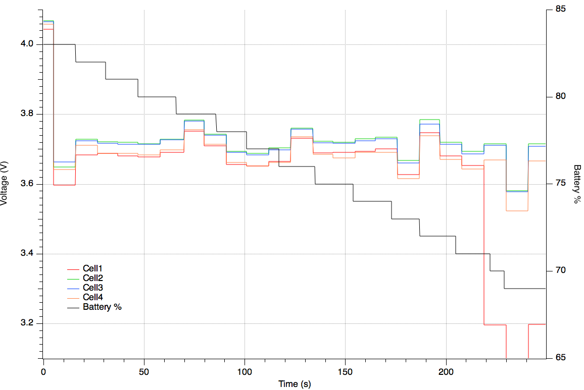

Was a very short flight ( 4 minutes) to video some ice fishermen. Using Litchi (as I always do). Was just finishing up when a Battery warning came on! Noted "Battery, Cell #1" can't remember the whole warning. Lost connection at that point. Waited for Return Home as it has always done in the past. Never came back. Went about 100 yards out on the ice and there it was. Upside down. No lights on the battery. I turned the battery on and the craft made the starting sound and one prop moved. How do I check batteries? Any thoughts?

I agree that taking off with a partially discharged battery is a bad idea, if only because the SMART estimate of remaining capacity tends to be incorrect. I'm not sure that it explains the anomalous and sudden drop in voltage on one cell though - I've looked at a number of partial battery discharge curves and that is the first time that I've seen that behavior. Do you have any similar examples?

That looks like a faulty battery. Cell 1 collapsed at 219 seconds and dropped the voltage below the protection shutoff level. The battery only had 50 cycles, I would ask DJI to cover it.
Looks like a bad battery to me. Was it an aftermarket battery? How many flights did it have on the battery?

In any case - I've seen several flight logs where the flight was started at less than full charge and the estimated capacity was clearly wrong. The starting voltages were too low for the initial estimate, and the result was that the estimated capacity decreased non-linearly. However, the individual cell voltages still tracked each other fairly well. This is the first log I've seen with such a major deviation on one cell.
Agreed, this is looking like a bad battery.

But personal experience is, by its nature, a limited dataset. My suspicion is that partially discharged batteries (either flown or auto-discharged) usually work fine. The events reported here that we get to examine and analyze are the less common behaviors, but I've never seen such a large cell deviation in such a short time.

You can add that good list of errors...... taking off with a cold battery. If that battery was exposed to freezing temperature very long, primarily before take-off, that can impair the chemistry of the outside cell that's exposed to the cold the most. In the battery plot posted it appears the RED LINE CELL #1 cell dropped below 3.0V (it went off the chart low). I've always heard the TI microcontroller inside the battery has a 3.0V cutoff, not 3.2V. If any cell gets below 3.0V, the "smarts" will turn off the battery, whether it's flying or not (not too smart if you ask me).
In cold climates it's essential that you enable the battery cell voltage level to display in the Go4 screen (upper right corner). There's a setting in for that. That voltage, when displayed, is always the lowest voltage of each of the 4 cells. If you get close to 3.0 V you are in dangerous range and you should gingerly RTH as smooth as possible WITHOUT giving it full throttle. I would worry at 3.3V because that's abnormal for P4/P4P craft to get that low on a typical flight. When flying in warm weather (70C), I will often have 3.6V readings for the lowest cell when the battery is depleted to 25%. This changes in freezing cold weather if the battery is allowed to get very cold before take-off, because LiPo chemistry likes warmer temps.

Battery showed OK, then suddenly one cell dropped in voltage.
What do the logs show the battery temp was?
