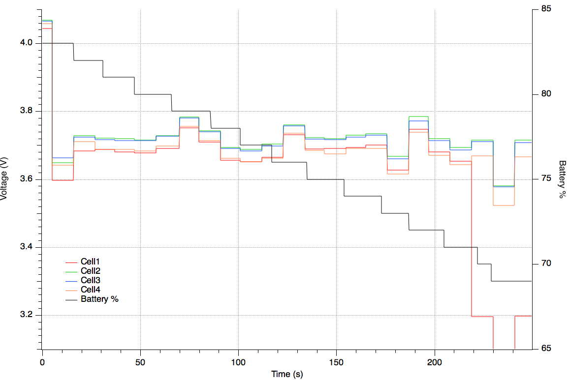

That looks like a faulty battery. Cell 1 collapsed at 219 seconds and dropped the voltage below the protection shutoff level. The battery only had 50 cycles, I would ask DJI to cover it.
So immediately after take off the battery voltage dropped to just above 3.6v per cell when loaded. Is that normal?
Seems a bit low to me.
Was a very short flight ( 4 minutes) to video some ice fishermen. Using Litchi (as I always do). Was just finishing up when a Battery warning came on! Noted "Battery, Cell #1" can't remember the whole warning. Lost connection at that point. Waited for Return Home as it has always done in the past. Never came back. Went about 100 yards out on the ice and there it was. Upside down. No lights on the battery. I turned the battery on and the craft made the starting sound and one prop moved. How do I check batteries? Any thoughts?

83% is still pretty well charged though.
The remaining capacity falls with voltage but its not linear because as you go down in voltage any given voltage fall has more impact on remaining capacity.
Li-Po voltage range is 3.2- 4.2 volts per cell with 3.7 volts nominal, centre of the range.
The BMS will turn off the cell at 3.2 volts.
But you are never meant to get anywhere near that, a forced landing will leave you with more than 3.2v, so I would expect a voltage of 3.6 volts per cell to read much less than half capacity remaining.
In this incident at 3.6v the % remaining never went below 70%. Its like the battery was not calibrated. The battery temperature seemed normal throughout, 18-27ºC.
Was this battery ever deep cycled to 8% or even low voltage cutoff and then fully charged? The alleged method of calibration? I know there is some debate as to whether or not this is good practice. DJI seem to have changed their mind on the issue.
These batteries often give misleading starting percentages when flown from other than fully charged, so I don't think that was particularly a problem with this flight. The major deviation of one cell was the problem - that is definitely abnormal and I doubt that a discharge and charge will fix that, but it's worth a shot.

Thanks everyone for the input! Think I will get a Cell Tester! I had trouble charging that battery a week ago. Lights kept blinking in sequence, wouldn't turn off. Next day it charged fine and flew it with this battery 4 times. Should have taken the warning!
