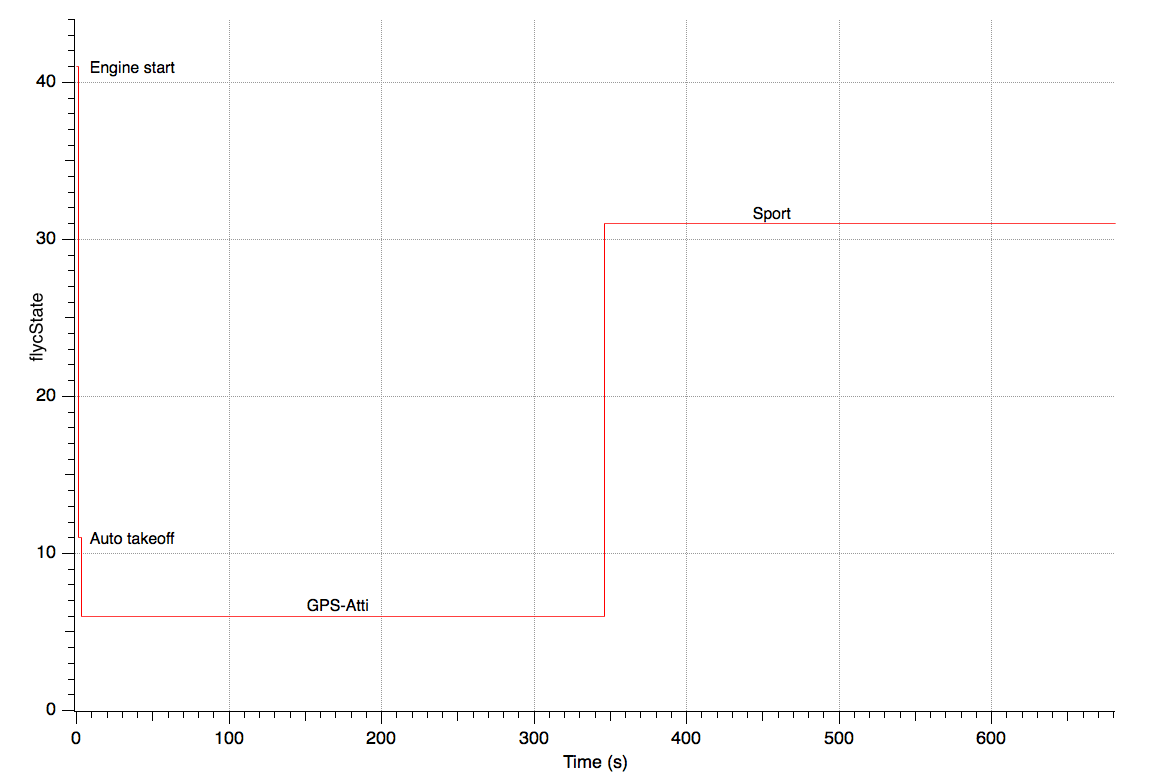

Your recollection is not quite correct. Firstly, the aircraft never disconnected from the RC (uplink and downlink were fine throughout) and never entered RTH. And your log is complete all the way to splashdown, so the mobile device was also connected.

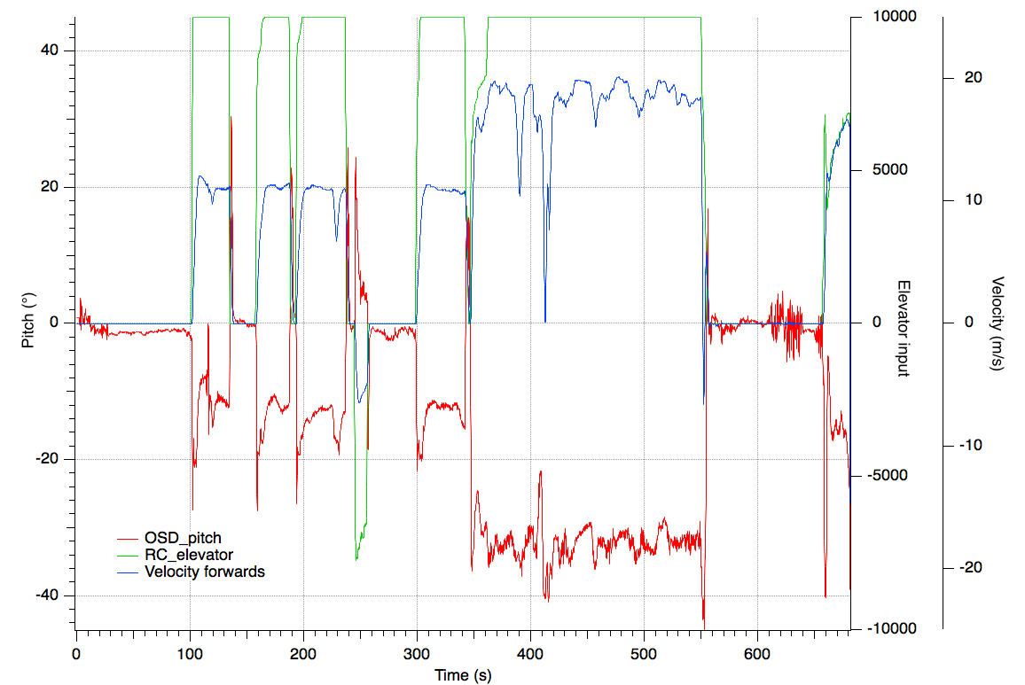

And the aircraft responded appropriately to all your stick commands throughout the flight. The following plot shows elevator input, the resulting pitch, and forward velocity:

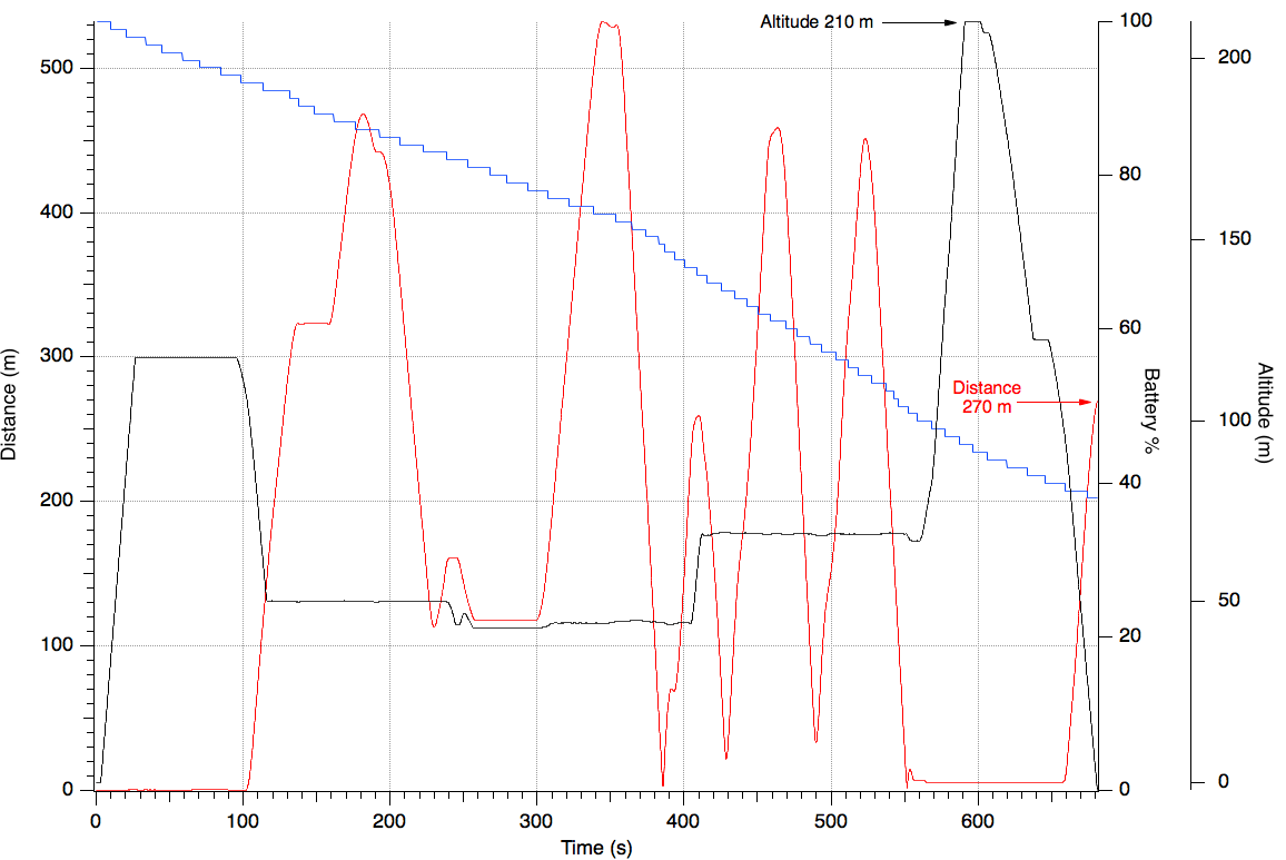

Looking at distance, altitude and battery:
At around 600 seconds it was almost directly over the homepoint at an altitude of 210 m, after which it headed out again while descending. It kept moving away and was still doing so when it hit the water at 681 s.

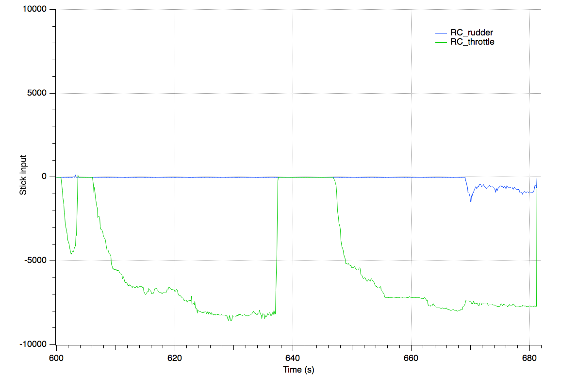

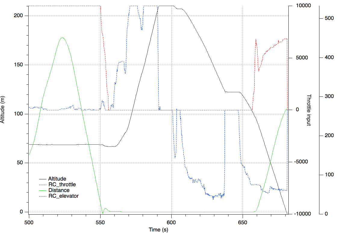

Both the horizontal movement and the vertical movement were directly driven by your stick inputs:
I have to concur with the previous opinions that this was entirely pilot error.

The rudder was commanding a slow left turn at the end, but the throttle was clearly down. I guess it's always possible that it malfunctioned, but it doesn't look like that to me - those look like real signals in terms of the signal pattern (only full or zero stick is ever perfectly smooth).

There's a steady descent from 400 to 170 ft where you started circling, but also continued descending.
Here's what part of the data shows for the start and end of the descent:
