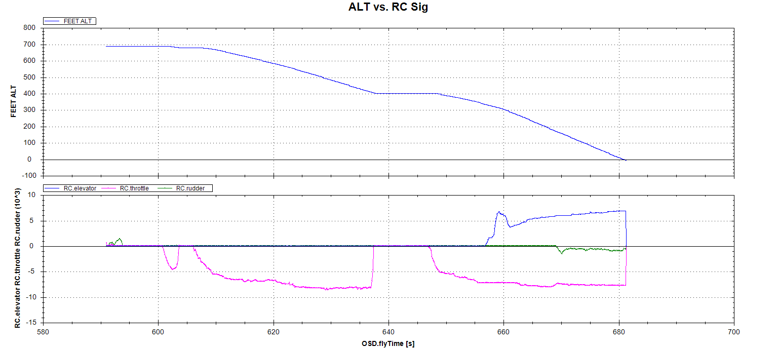

Agreed to all the above data. Didn't get a chance yesterday to look in detail, but did today. Can't see this being an RC issue either. Just throttled down over the water with forward elevator.......splash....

Another thought on this.You don't suppose the USB cable disconnected do you? That might be the cause of the disconnected message, and in the heat of the moment, you reversed the sticks in your head. Your first instinct might be to climb and bring the AC back to you. The data shows the opposite, commanding decent and fwd elevator. You didn't say what device you were using so just a thought.

One last thing. 700ft Altitude? Really? Not meaning to preach but wow. The other data shows the same as previous.

If the cable had disconnected then the txt log would be incomplete.

Correct. What was I thinking.....:oops::oops: I wasn't I suppose...

As I mentioned above - that is not the explanation because it would have interrupted the log on the mobile device.

the altitude is explained because i'm flying in the mountains . the peak next to the lake here is 2000' so from take off a few hundred feet to the north the mountain climbs rapidly then coming back over toward the lake the elevation drops again . I do know now that what my story was about the incident was correct except that while i was distracted with the mom and kid i must have inadvertently held the elevator down and lost my mind never seeing the drone hit the water even on the screen . at that point just seeing aircraft disconnect . which lead me to believe something else was going on when in fact the drone was sinking . it sucks and have never had this brain fart before . but i bow to the flight logs . after 199 flight i screwed up on flight 200 . it was getting dark and just got the last peak of sunlight ,when this all happened . had adjusted the camera setting so i could see the screen . it really sucks as my bird though I've had a couple glitches during the 200 flights was a solid drone . now i will take a gamble on another one and hope it's as good as this one was .

I understand that, however the altitude is based on AGL from the takeoff point. According to GE data, your launch point was approximatey 6 to 10ft below the point in which the aircraft was lost. The lake in this instance would be considered basically ground level. Had you been attempting to lets say climb to the top of a mountain from that point, as long as you were 400ft from the ground level on said mountain your description would be correct and the actual altitude would be fine. This was not the case here. That said, hope you get back on the flying trail again.
