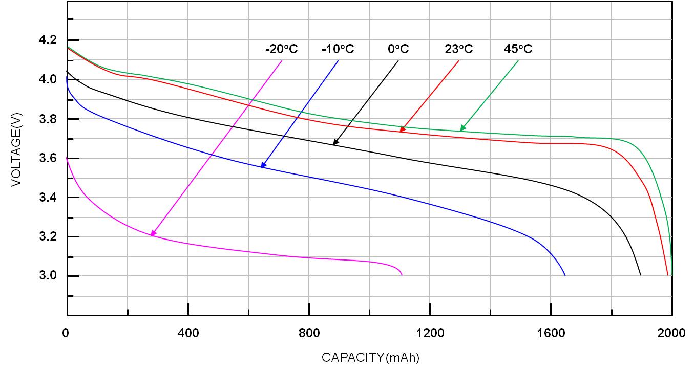

"First please look at the attached image, this should really explain all you need to know on how cold effects capacity. Once you understand this, most of the other pieces come together.
Now that we understand what cold does to capacity let us talk about overall discharge.
Most of us know that C is based on overall capacity, so if your capacity goes down, so will your C rating. Unfortunately, DJI does not use batteries that have much overhead, this is mostly due to keep the weight down at a certain price point. So, when we start to pull from this cold battery a few things can happen. If the pack has not been preheated, it will start to preheat itself. You are probably asking; well if that’s the case, why do I have to worry about preheating?
Well, if the battery is too cold and C rating has been affected, it will not be able to supply enough output (required C), going over its current C rating due to loss of capacity. This starts heating the pack up rapidly. Which in turn makes the pack quickly go past normal operating temperatures, which will also decrease output. This will cause immediate damage and more than likely a cell failure under extreme conditions. This is called thermal runaway.

Appreciate you sharing this info BigAl07, thanks. Something I've noticed flying in cold weather is any small cell deviations that the battery may have become more exaggerated the colder the temps are. Adding another reason to not run the batt down as far as one would in warmer temps.
In general, this is a fairly common phenomenon for many lithium-ion batteries, but my gratitude for such a study specifically on these samples - it personally gave me a couple of ideas on how to solve this problem
