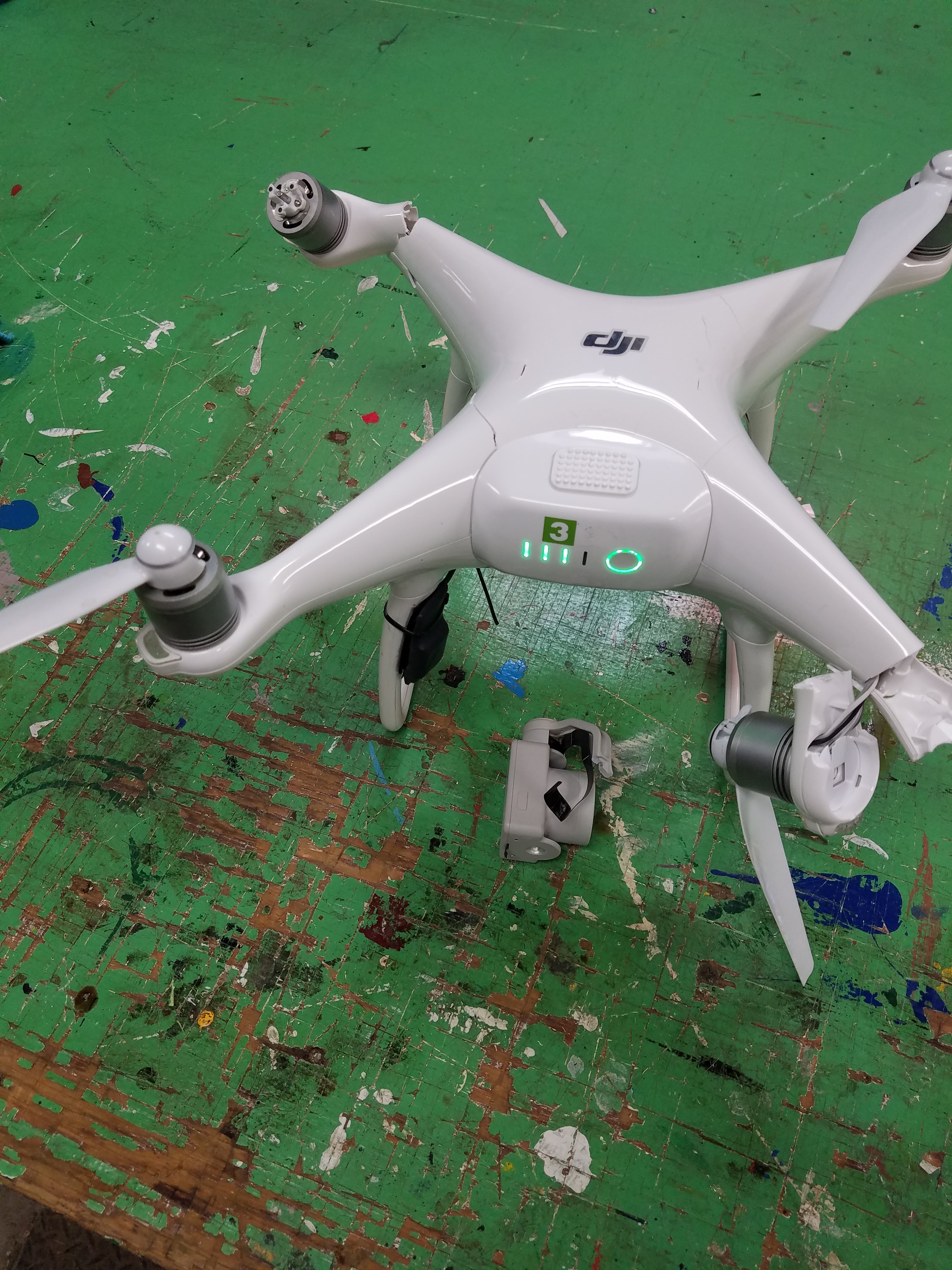

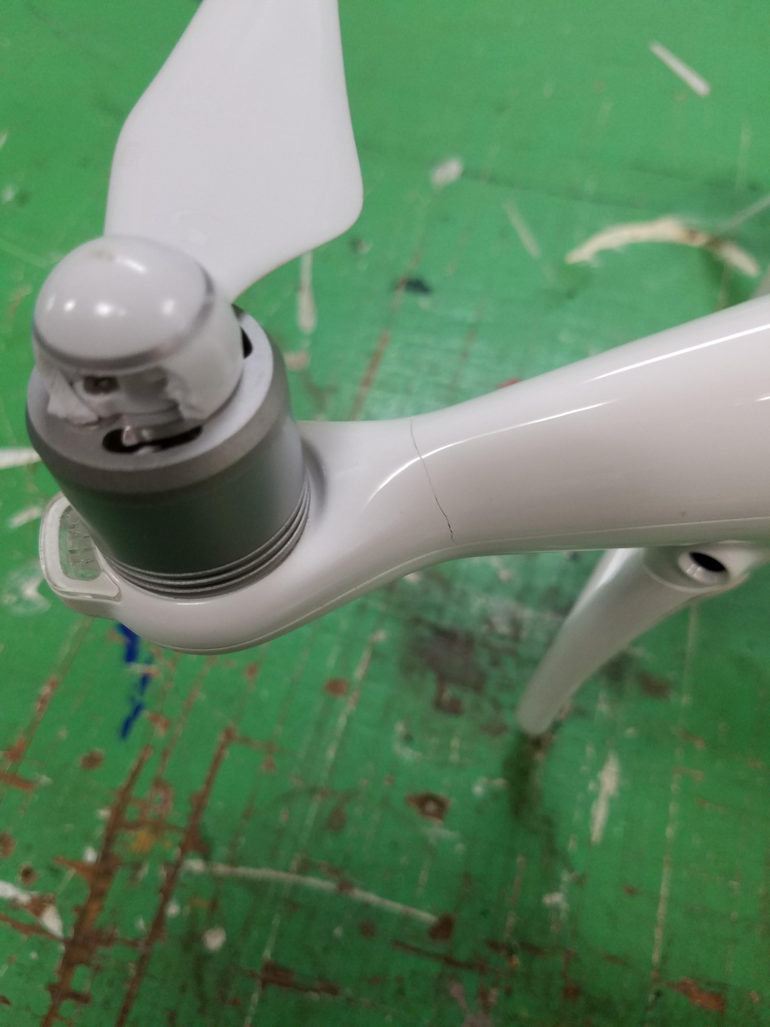

Was a very short flight ( 4 minutes) to video some ice fishermen. Using Litchi (as I always do). Was just finishing up when a Battery warning came on! Noted "Battery, Cell #1" can't remember the whole warning. Lost connection at that point. Waited for Return Home as it has always done in the past. Never came back. Went about 100 yards out on the ice and there it was. Upside down. No lights on the battery. I turned the battery on and the craft made the starting sound and one prop moved. How do I check batteries? Any thoughts?

I notice there is no evidence of one of the props in the photos.
Again lack of redundancy makes it fall if a prop takes a walk off the map.
Will be interesting to see the conclusion of the investigation!
Good catch
