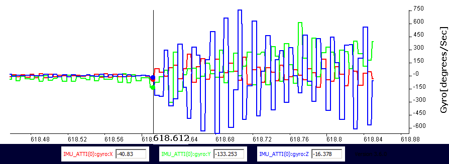

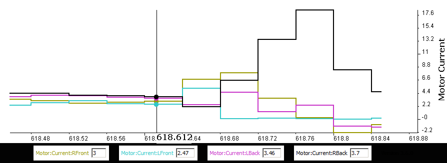

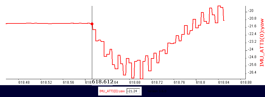

@Kissthesky is there any evidence that the battery was hit by the rightBack prop? The reason I'm asking is that 140 millisecs before the voltage drop (618.612 secs) the Z axis gyro and Yaw look like what could be expected if one of the props was hitting something.
I'm supposing it might be the rightBack because that motor shows increased current

Is the hypothesis that the battery slid out and contacted the rear props? The rate gyros and accelerometers all register the first sign of the anomaly at 618.61 and the voltage drop first registers at 618.76. But to hit the props the disconnect would have to have happened first, prior to 618.61, followed by a time interval for the battery to move far enough to hit the props, which leaves a rather long gap between disconnect and voltage collapse.
Or could a failed prop have hit the battery and caused the disconnect?
