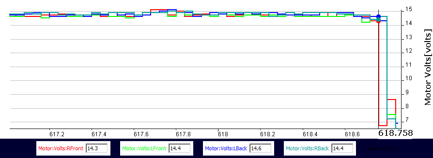

FLY036 is the incident flight. The motorVolts data shows that there was an abrupt loss of power at the very end as the volts signal dropped from around 14.8 volts to 7 volts in 0.04 secs.

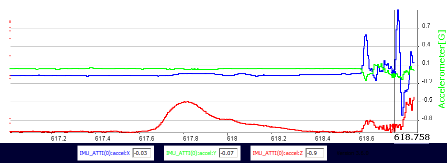

Usually I would say that the .DAT data can't distinguish between a battery disconnect, or a battery failure. But, the control and accel data shows that full throttle and elevator was being applied and then released abruptly which caused the Z axis accelerometer to decrease 0.5 G. One sec later there some more abrupt accelerations involving all three accelerometers followed by the power loss. IMHO, this data means the battery came loose.
