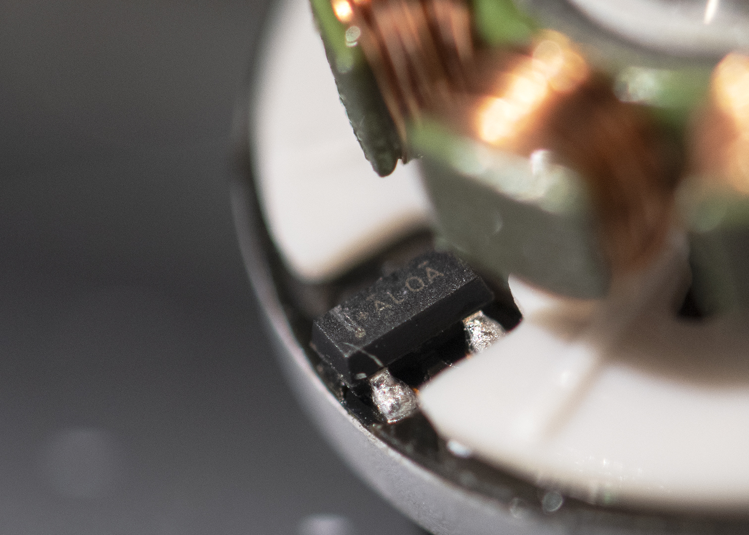

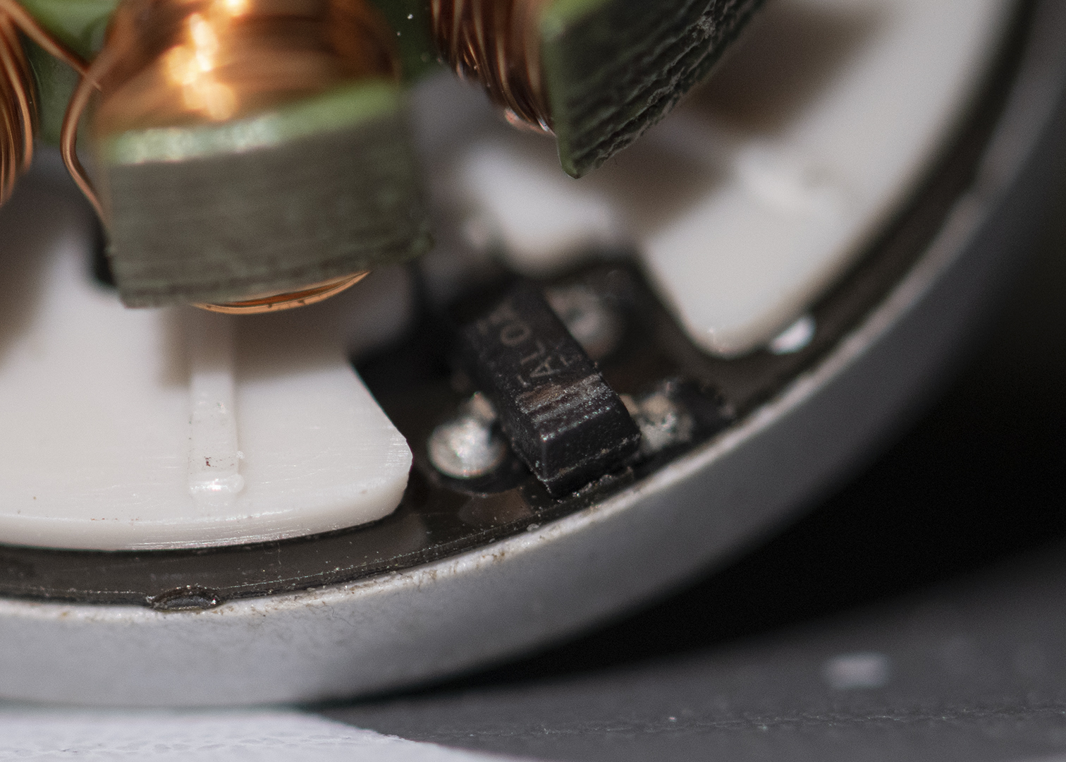

Hi folks. Both sensors in the yaw motor are scratched. Here's what they look like. I haven't looked at the other two motors yet but I guess I'll be swapping this one out.
Reactions: Droneted
Hi folks. Both sensors in the yaw motor are scratched. Here's what they look like. I haven't looked at the other two motors yet but I guess I'll be swapping this one out.View attachment 123632View attachment 123631
I would be willing to bet that is the only bad motor. Make sure you reuse the yaw motor drum. I have a YouTube video that shows how to do it
Yup, I've watched that video. Just need to find a replacement that's in good shape. Was just typing you an email...stand by for that.
