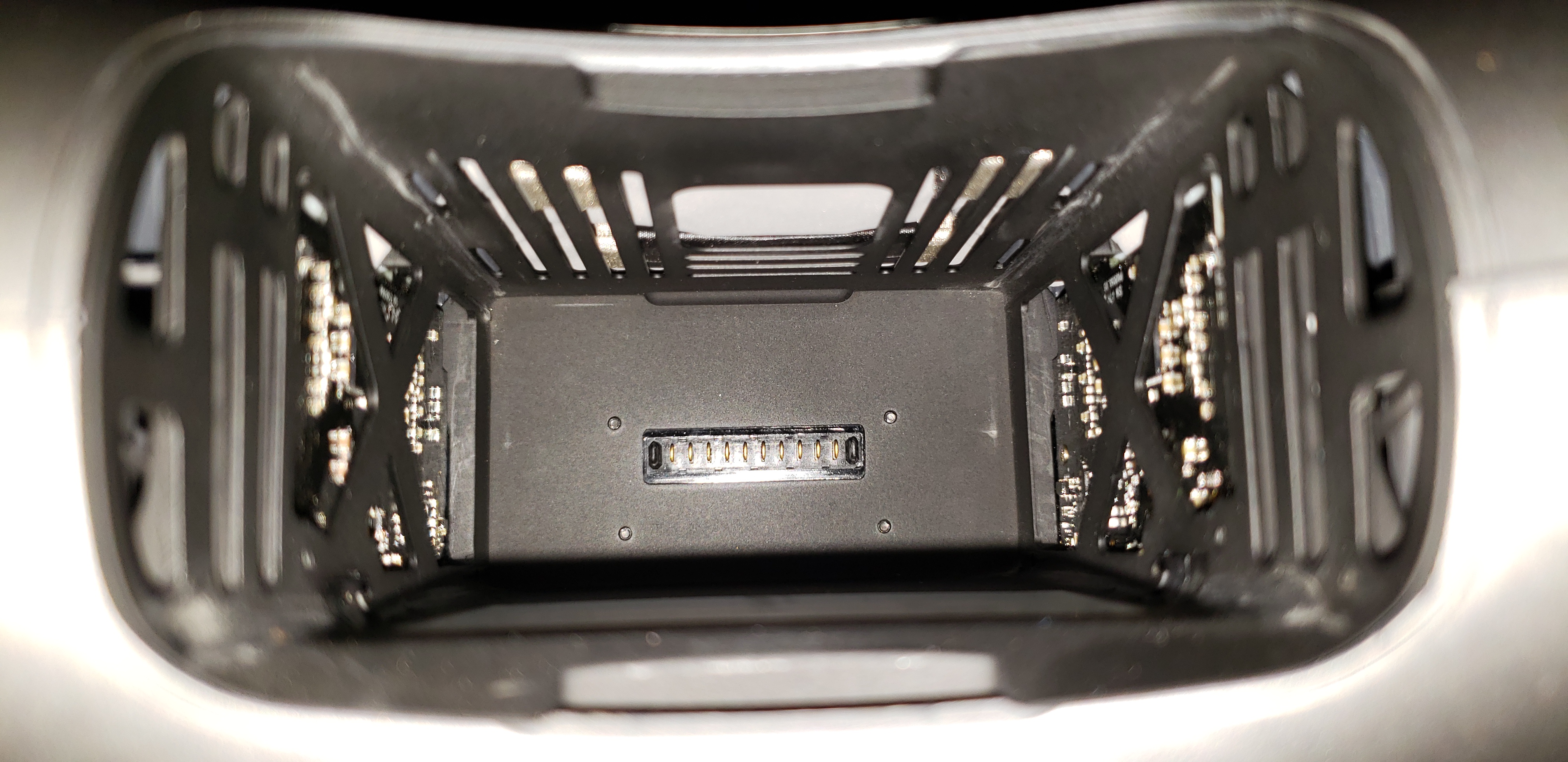

The clicking noise may have been arcing at the battery connections as well. Arcing would leave evidence if you view the contacts, it can be quite loud.
Reactions: Kissthesky
They look exactly the same minus the color
I'll definitely look! It WAS loud!
