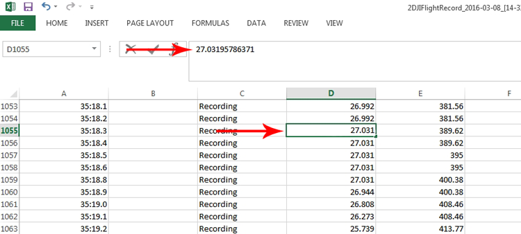

Also I have one more request if you don't mind. This would be....leaving the CUSTOM.hSpeed column to display in thousandths, but when a field is highlighted set it to show the full number in the upper description area. Example shown in image below. As a reminder, the long number display only appears when highlighted.
Btw, that reminds me, @ferraript thanks for the update on the displayed Speed. However, it appears that "CUSTOM.hSpeed" in Column "D" is corrupt. Some of the fields are showing the same pack of numbers repetitively. Such as, 0.141, 0.224, 0.316, 0.412, and many more.
