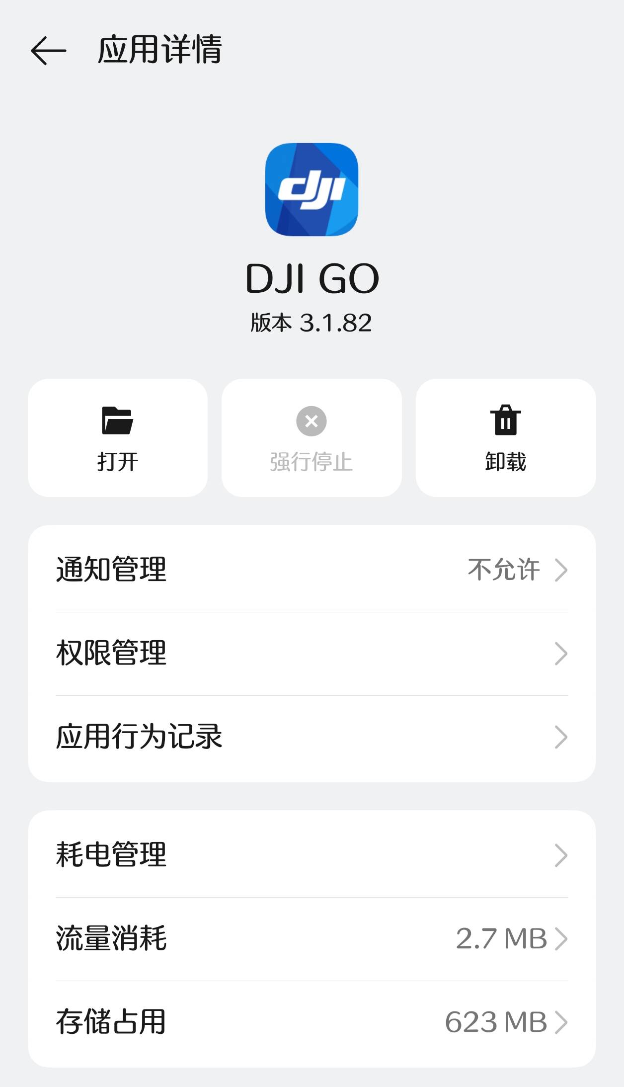

I don't know if anyone will still working with DJI PHANTOM 3 series in 2025, but right now there is a fully functional FCC patch based on DJI GO 3.1.82, as shown in the screenshot
This is built from CN 3.1.82, 64-bit libraries, works on Android 16. The latest version on the EN website seems to be 3.1.80, and I'm not sure if some features like map work in another place
1) DJI GO version

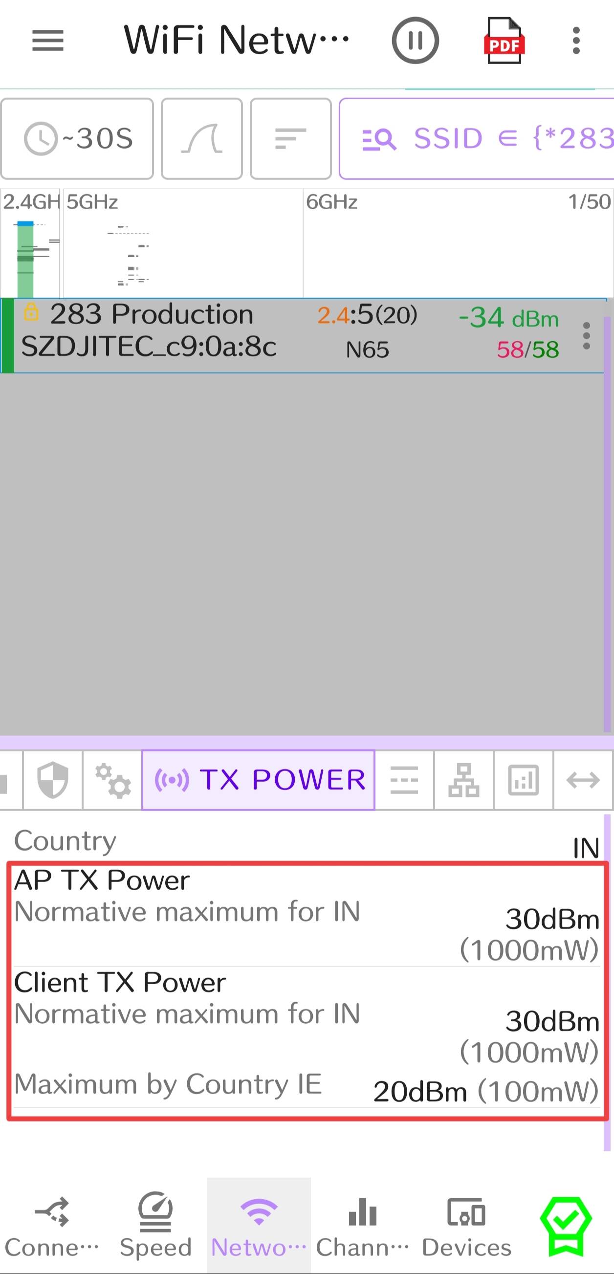

2) Screenshot from analiti. You can also use this app to check WiFi freq, power, country code. A reliable method! Seeing is believing

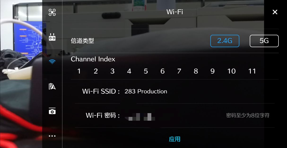

3) Screenshot from DJI GO. In FCC mode, 2.4 GHz band has 11 channels

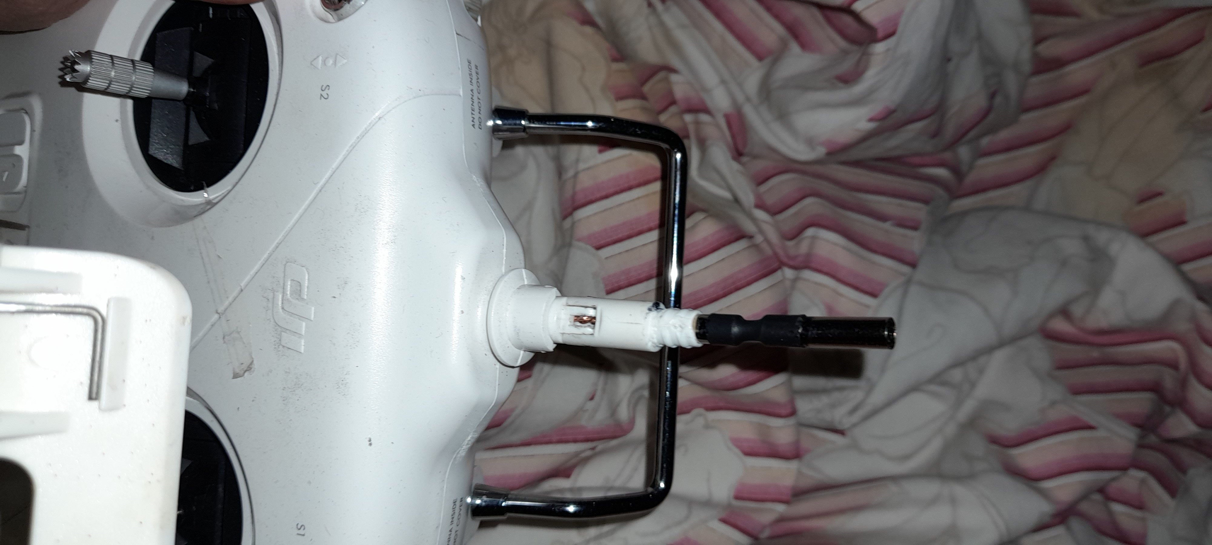

Im in Western Australia, Perth.
Yes I'm using Litchi.
Signal loss was pretty much straight away as Antenna was damaged, outside wire sheath (-)ground was torn and almost completely separate bottom half to top. I repaired it best as I could manage. I checked the antenna tip and it looked to be correct length soldered point still solid. Im not sure if it's common practice but DJI cover the 5.8ghz tip with some heatshrink and add another metal antenna tube end situated upside-down, then heatshrink it together.. I think its to protect the live antenna tip😑 I found it strange as u have the plastic antenna tube that covers the lot for protection.
Reactions: RodPad
That took me longer than I like to admit to write, but I i should of just taken a picture 😑lol
