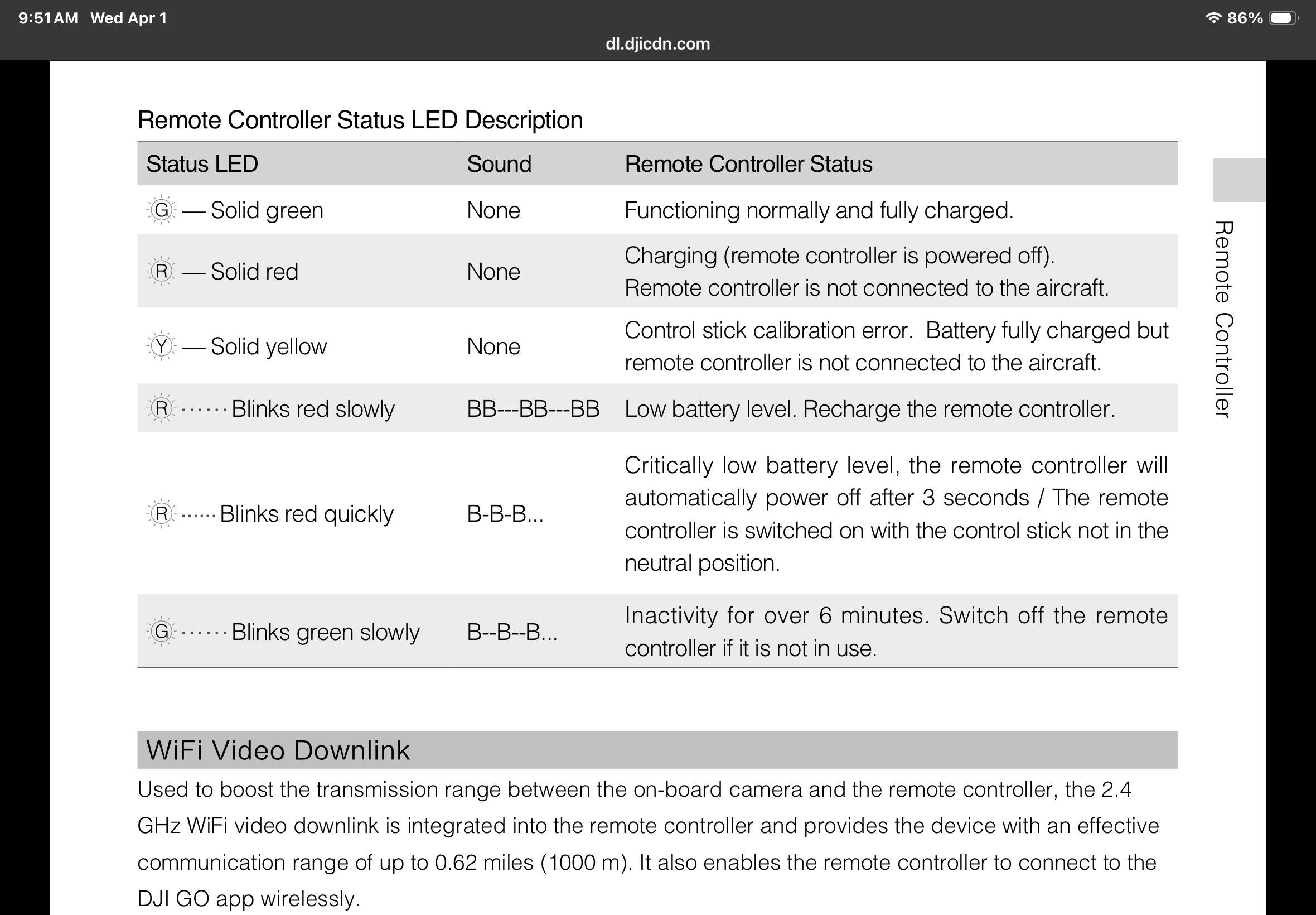

You mention that the RC Status light is red. Are you sure you are linked to the drone ? IMG_8640.png
Reactions: 1EagleDave

Regarding the connection between the controller and the drone: I believe it's OK. The LED on the side of the drone is green (indicating connection) and I can control the drone within the safe flight range, even without visibility through the app. The app shows "disconnected" in the upper center of the screen.
I believe the red LED on the controller indicates some problem that I can't identify.
