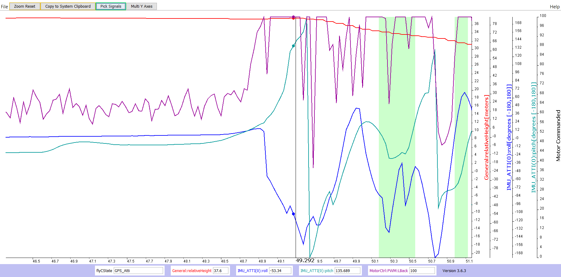

That’s where SAR got to in his analysis (post 7).
Correct.....That's why he mentioned the original .dat and that is where the graph in Post#20 came from as more of confirmation of the assessment.
Probably. That’s where SAR got to in his analysis (post 7).

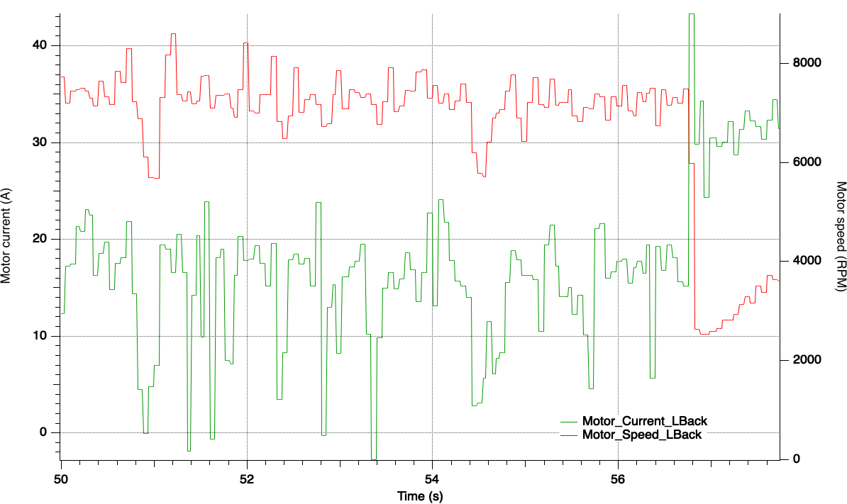

Agreed, but based on the DAT data I'm not sure that the cause was a broken prop. If you look at motor speed and motor current data:

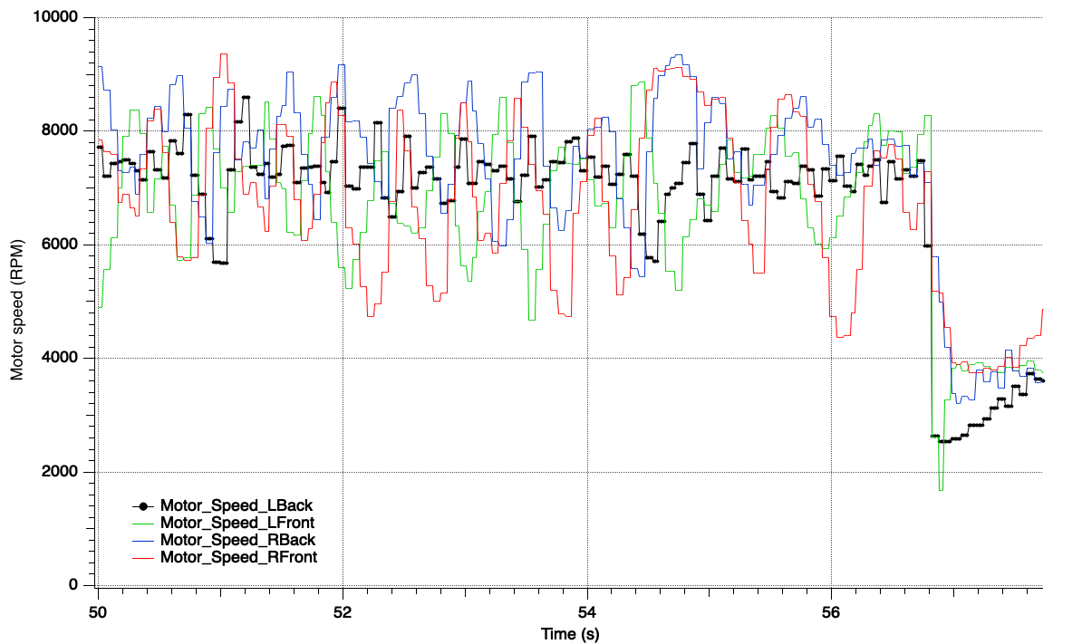

The left back motor is clearly behaving strangely, but not how one would expect for a lost or partially lost prop, which would reduce lift and moment of inertia. Looking at those combined for the left back motor:
It's clear that the motor current spikes while the motor speed drops. That implies a motor obstruction or other issue, since a lost or partially lost prop would result in an increase in motor speed, not a decrease, especially since the current increases significantly.
The observation being in the absence of the .dat the initial attitude and yaw changes observed at the suspected issue presentation seem to be proving very reliable in identifying the cause.
I'd say that they are pretty reliable but, on a few occasions, and for no reason that I could ever determine, they led me to identify the wrong motor. The responsible physics escapes me. So now I'm a little more circumspect in my attribution before seeing the DAT data.
That is why I looked at the PWM control. It was intermittently maximum, leading to the thought of the left rear motor. Agreed with the motor speeds. One would think your assessment is correct in relation to that, as I thought as well. The PWM data to me indicates the controller was attempting to speed the motor, but could not due to the lack of drag that the prop would indicate to the FC to compensate. I could be very wrong, and have no problem being so, but that is what I see for what it is worth.
The high PWM values are just the FC attempting to get the motor speed back up - hence the associated high motor current. Something was slowing down that motor, and it was not external drag - hence the imbalanced angular momentum and the CCW spinning flight.
Agreed, that is what I mentioned.
By "drag" I meant the calculations on power applied to the motor. The slow down, could have been ( And I am really stretching this ) A large insect struck by the rotor, hence slowing down the motor speed, increasing the current, and the PWM failing to control the effects. Yes, I know its a stretch by a long ways, but possible....Not probable....o_O
The unusual noise that the OP reported may be related - I'd be curious to know what caused that. It would also be interesting to know whether that motor/ESC still works.

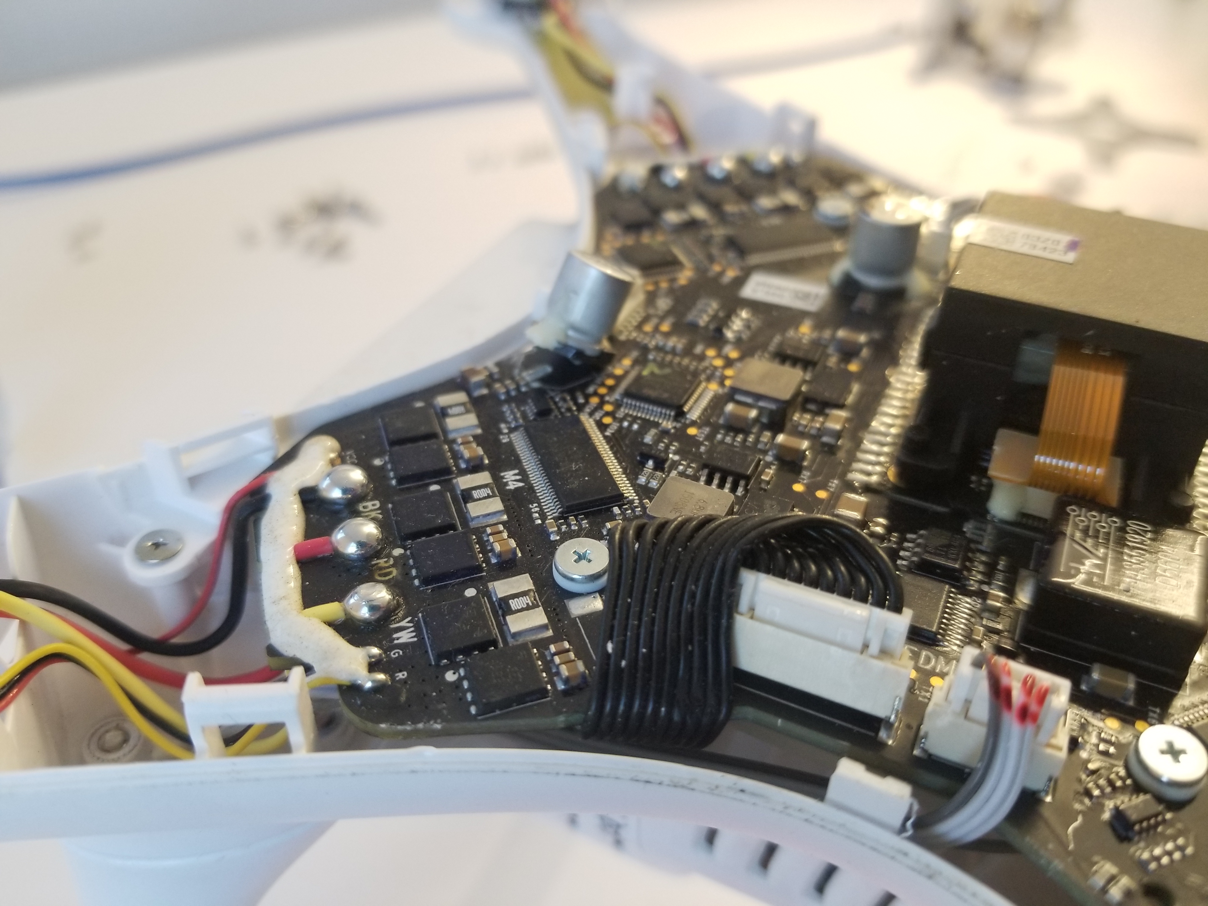

Not sure if this capacitor popped off before, during or after flight but it is definitely a "bad thing". I took the case off gently (it was so cracked it came off easily) so it was not done during disassembly.
