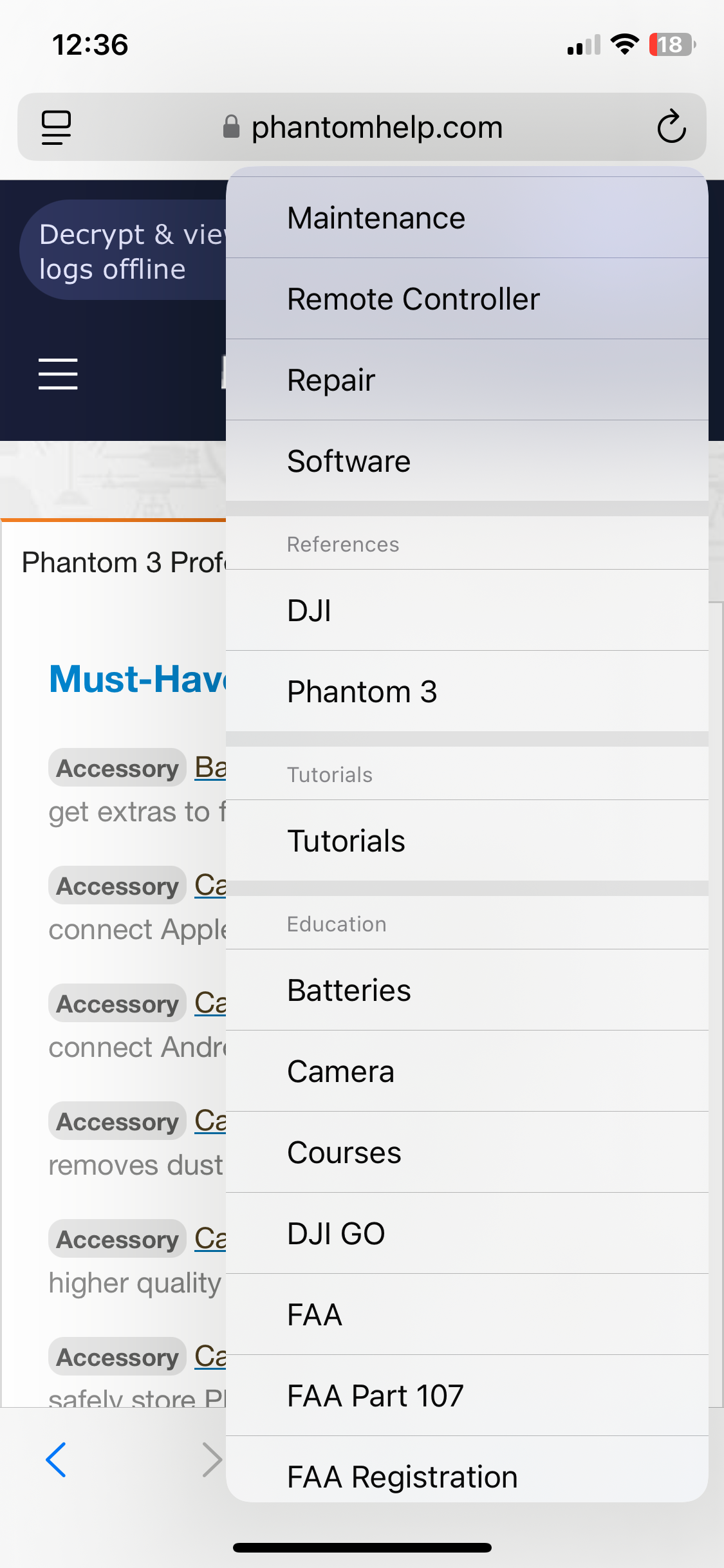

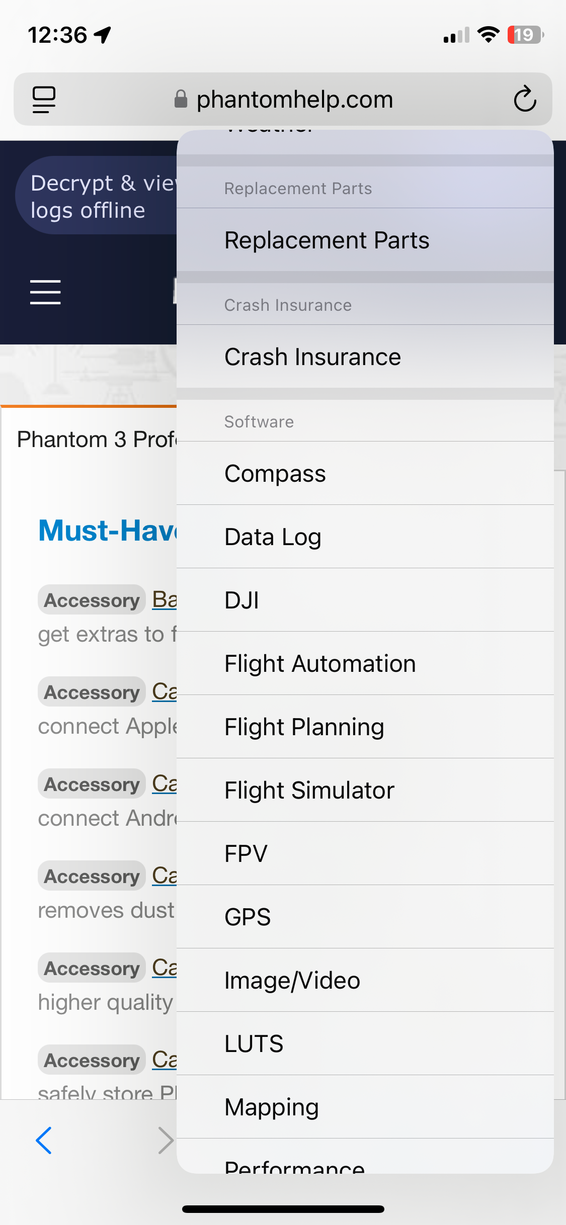

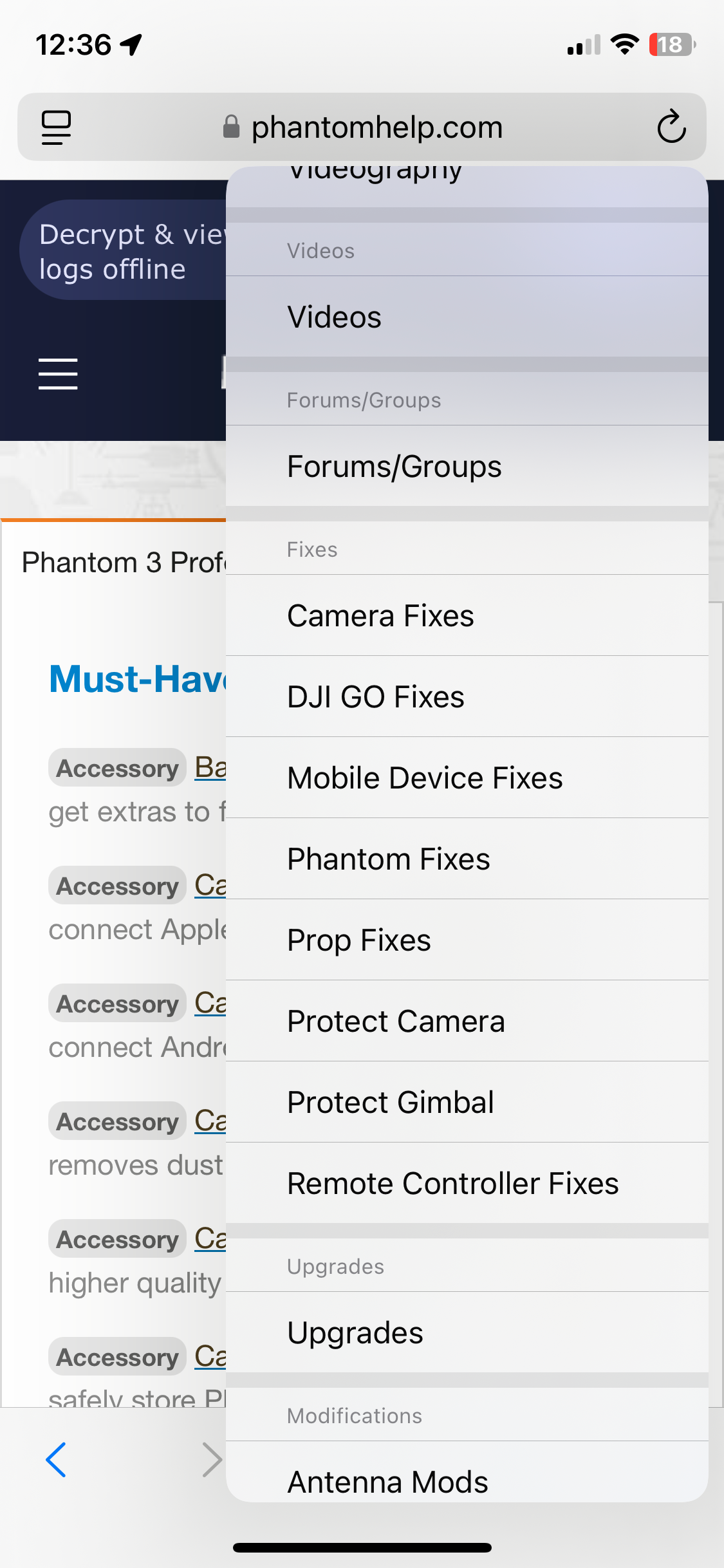

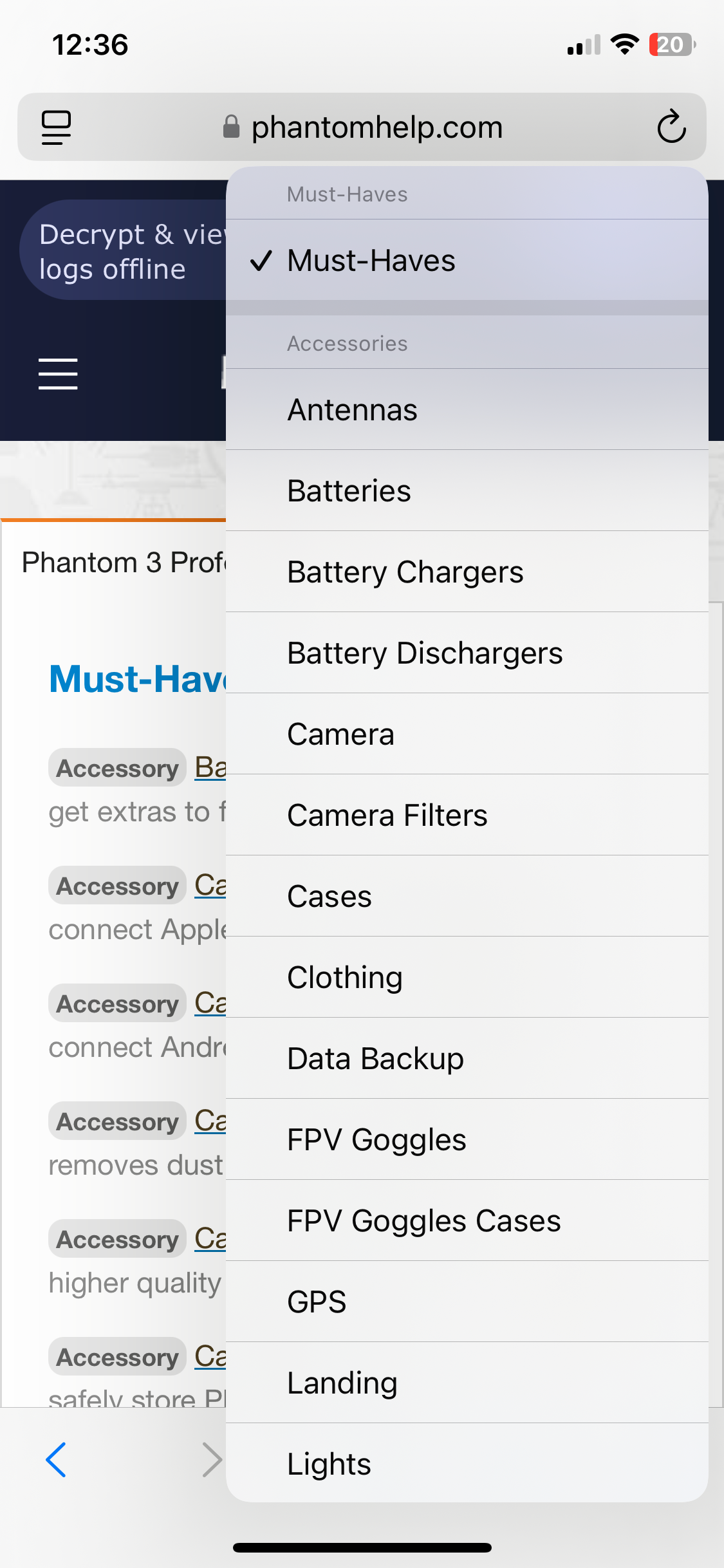

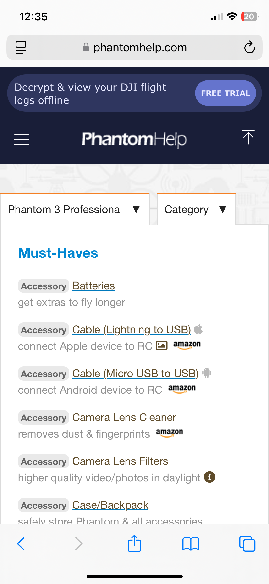

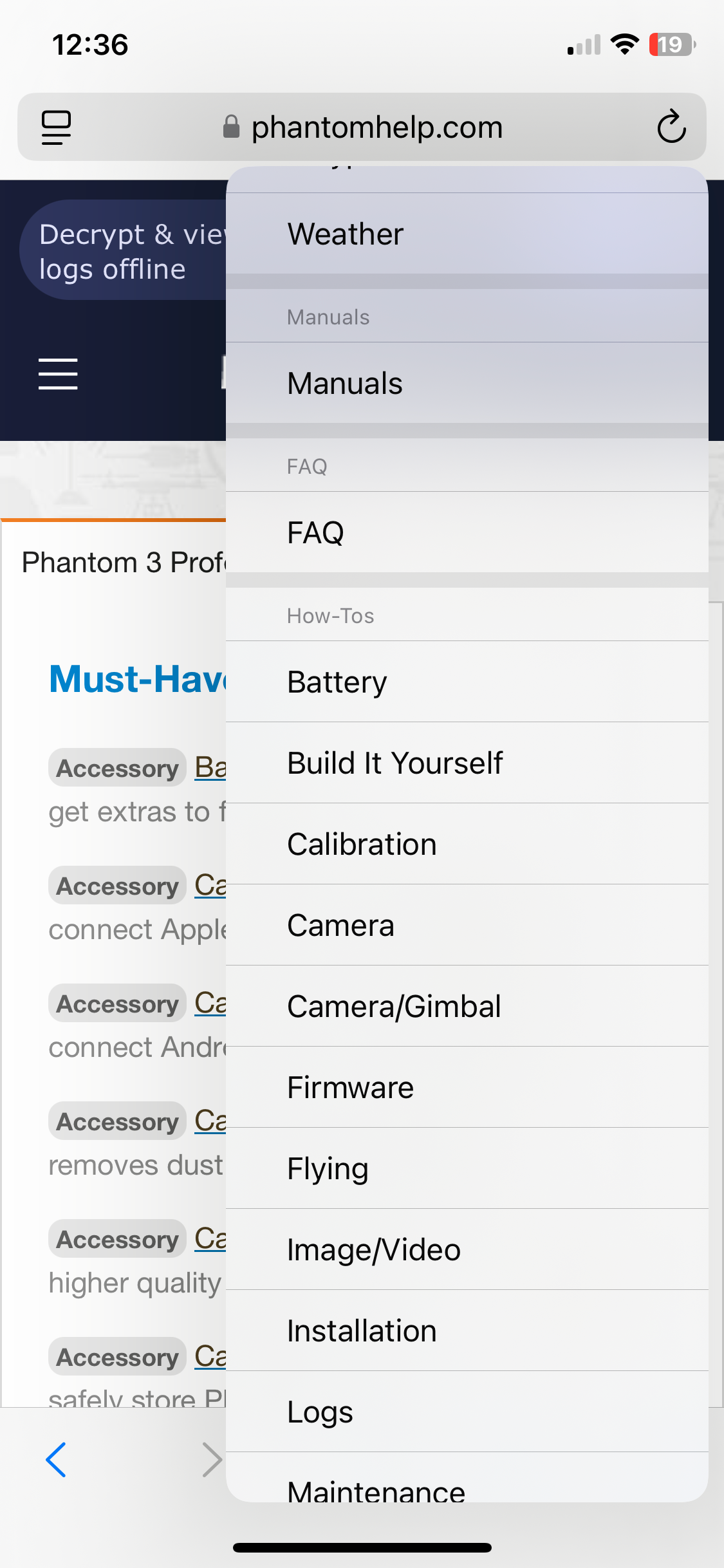

Not exactly sure what you are looking for, but the links to the Phantom Help site from @msinger could not be more comprehensive.
If you select your Phantom model in the left drop-down menu then use the right drop-down window to select the topic you will find about 50 times the information you can find on the DJI website if not more. This is a partial showing of the list of topics for the P3Pro:
