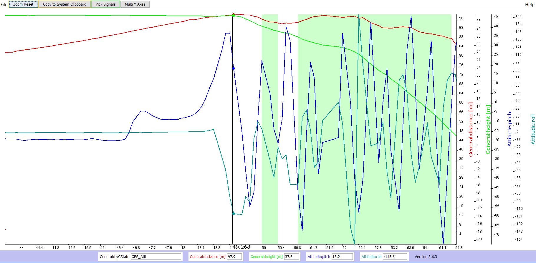

It looks like you lost a prop at about 49 seconds into the flight. You can see your Phantom spinning in circles at that point in the flight log.
DJI Flight Log Viewer - PhantomHelp.com

Sure looks like a lost prop.

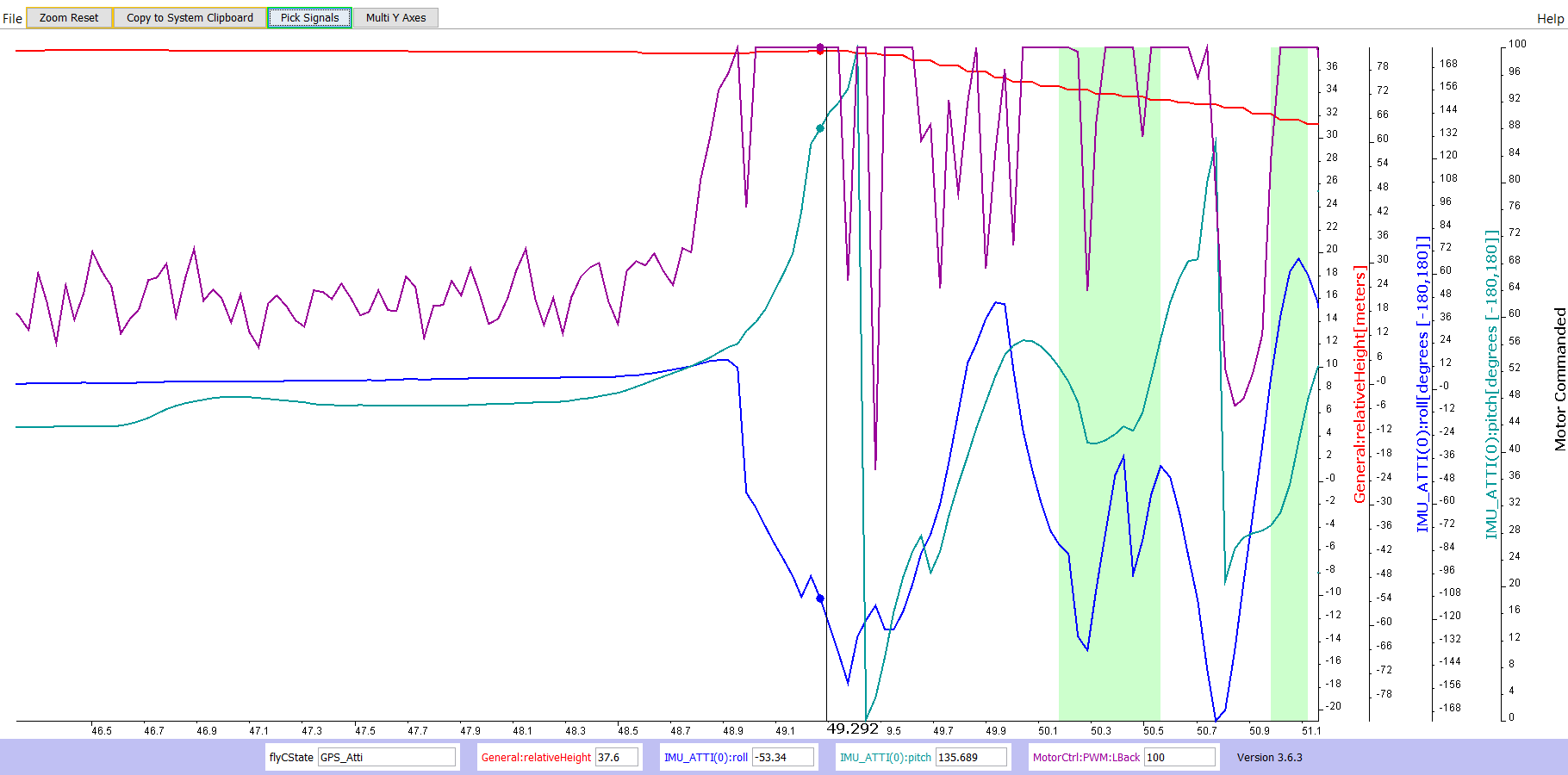

According to your flight log, it happened at about 49 seconds into the flight. If you review your DAT flight log, I'm sure you'll also see that motor was spinning unusually fast after the prop sheered off.

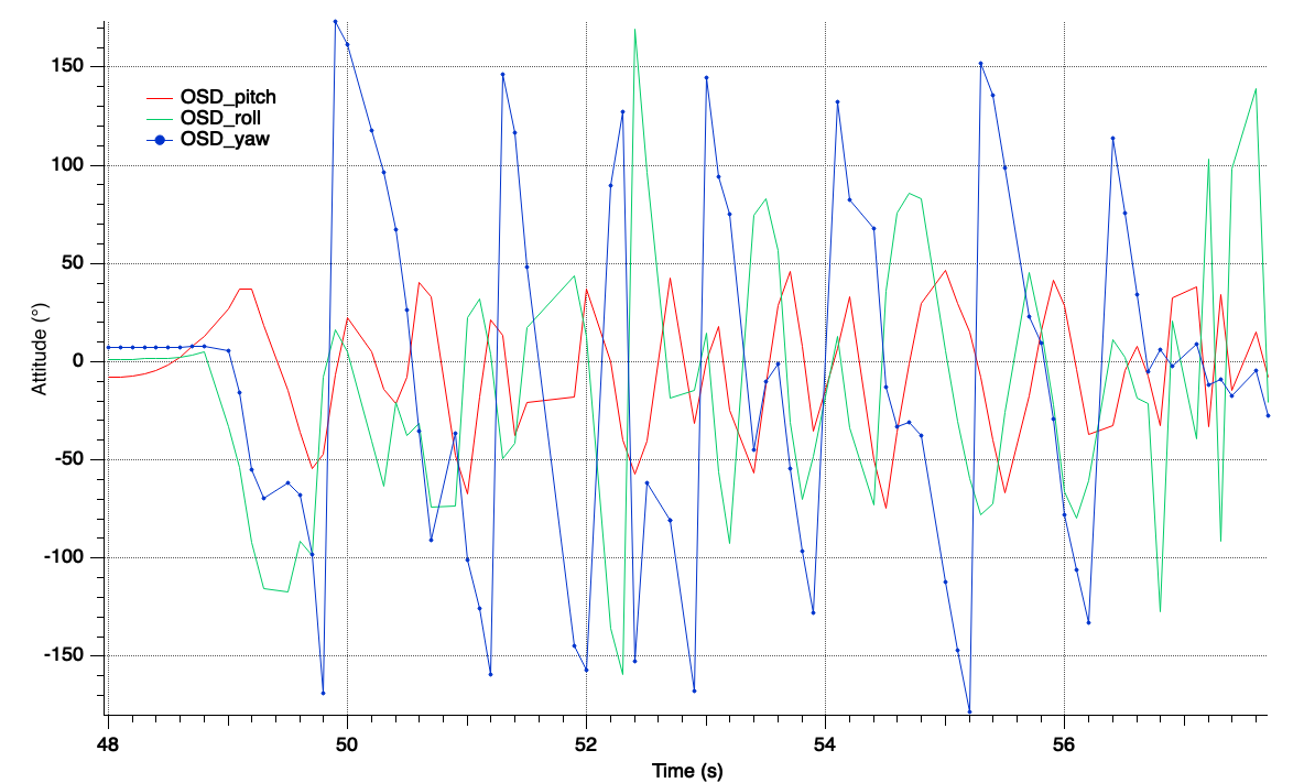

Those flight characteristics are consistent with partial loss of a prop. The periodicity of the pitch, roll and yaw is longer than normally seen with complete prop loss, suggesting less of an angular momentum imbalance.
The aircraft pitched up, rolled left and entered a CCW spin, suggesting that it was a CCW prop, probably the rear left based on the initial pitch and roll excursion. The DAT file would confirm, either way.

I extracted the .DAT version of the flight and put it up here:
It does seem like one motor got up to like 9k rpm which has to be a "bad thing"

That Airdata summary of the DAT data doesn't display the important information - i.e. individual motor speeds and motor command values. Their beta DAT reader is not very good. That requires the original DAT file.

Raw DAT file: Dropbox - FLY205.DAT

Looks like the left rear prop may be the culprit.
