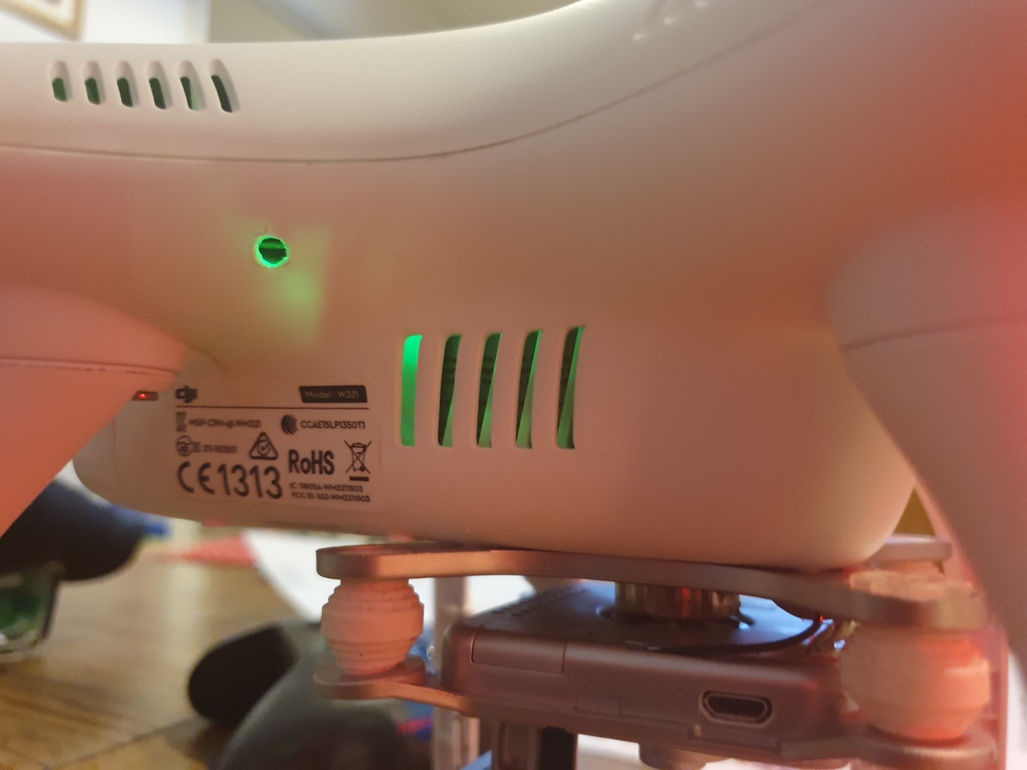

Range on phantom 3 new user .
You can use the s1 switch on remote to toggle re link to drone .
But it's just the button inside that says you need to press once its initiated

Ok linking sorted.
