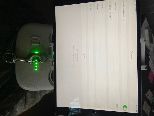

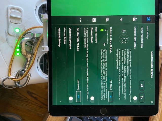

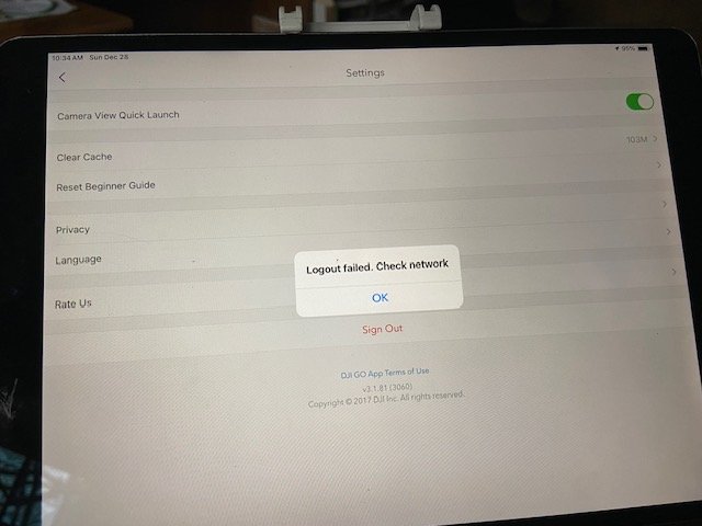

Thanks for the guidance Daniel. Unfortunately I don't have that "factory reset" option in Settings or even Advance Settings. If you do or maybe someone reading this does, could screen shot it? All I have is the option to "Sign Out", and I can not even get that to work....., see photo. I've tried I think every combination of wifi w/ Phantom connected vs regular home wifi connected and can not get it to work. Obviously, I am missing something.
I appreciate the link to the article. I tried those different methods too, but they didn't work. The one method says to press the "home" and "power" buttons simultaneously. I don't have those on my remote controller. My power is a slide switch. (See photo.) I am pretty sure that I have the latest firmware downloaded (1.9.20)
Thanks again for the help. I'll try whatever is suggested.

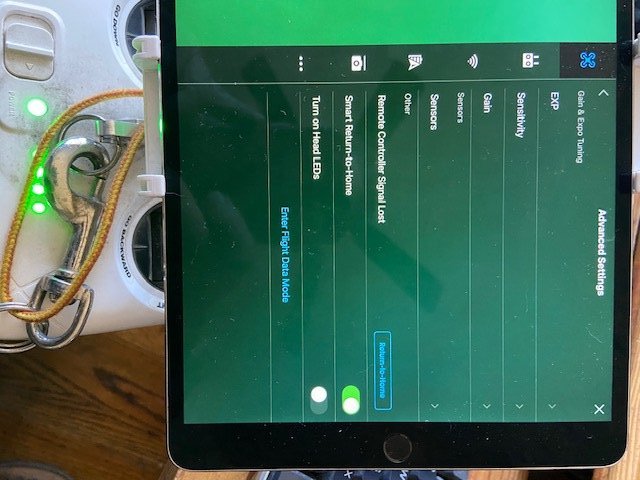

Thanks for the screen shot, but unfortunately, I don't have that. See my 2 screen shots from my page.
You see my MC setting page is similar, but not the same. I also click on the "Advanced settings", and still don't have that option. (see photo) And the 3 dots under the camera settings only show "General Settings", and no option for a "reset". (I can send that screen shot if needed.) When I click on "About", it says my App version is 3.1.81, and my Aircraft version is 1.2.40+. If I plug my drone into my desktop, would it connect to the appropriate program perhaps to perform a "reset"?

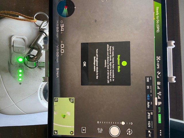

Well, I did manage to do somewhat of a "reset", but the drone still has my name listed. I followed the instructions in the link, but I did this toggle motion 5 times before the power button went from green to red, and it only flashed once, indicating something reset, ha. See screenshot once I started it back up.
So now, to complete the task, after doing more searches, it was suggested to delete the app from the device (either smart phone or Ipad) and reinstall, which would force a logout. And it did. Now it can go to another person that will appreciate it. I will post any additional information that I learn....., thanks.

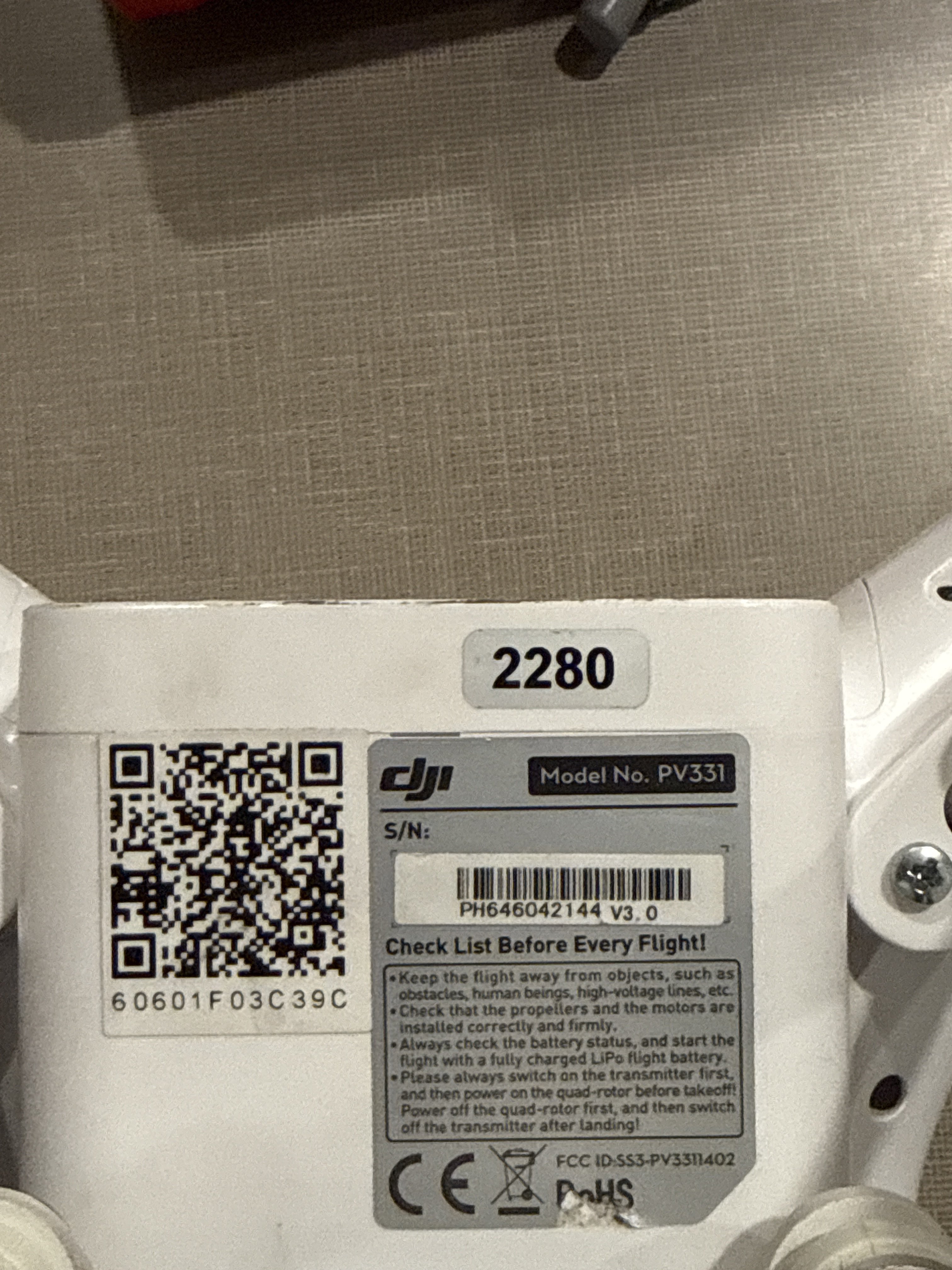

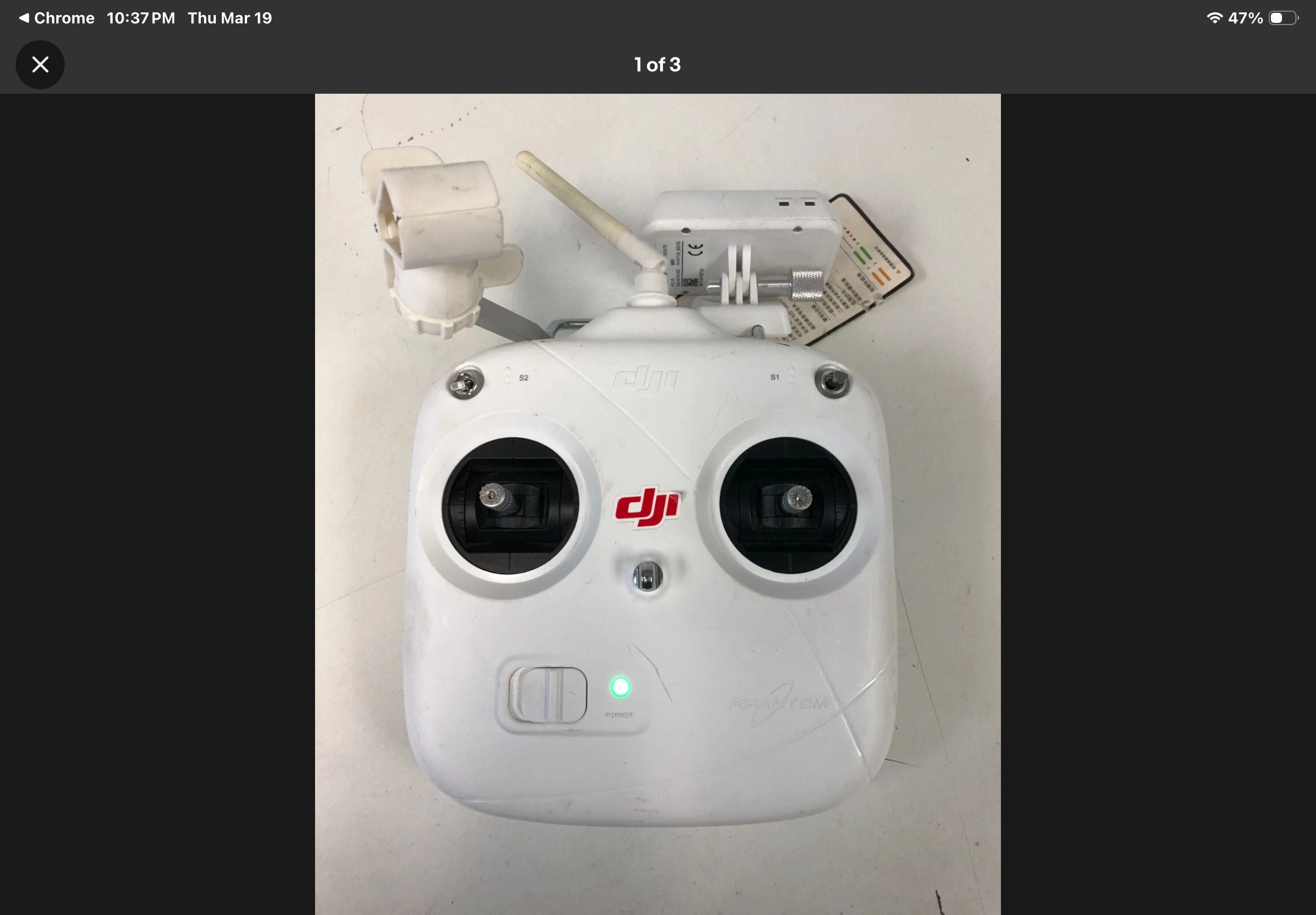

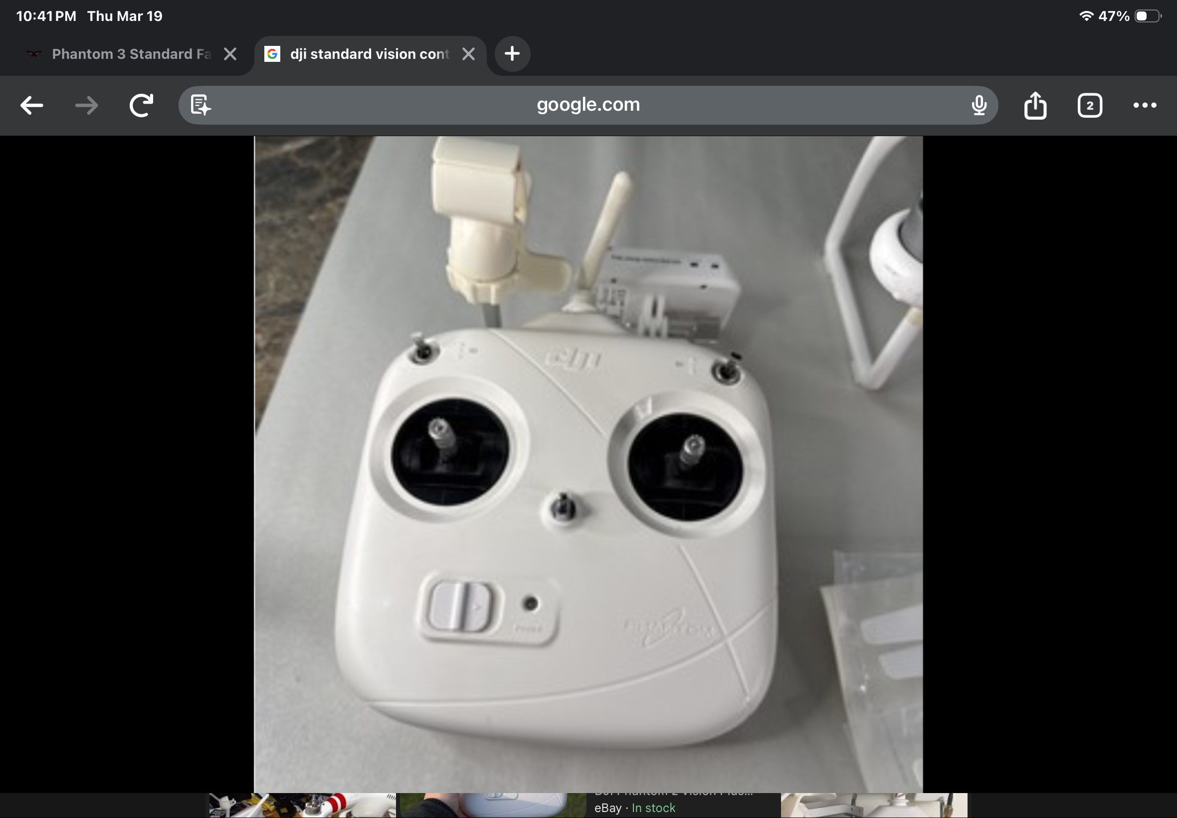

You mentioned in post #13 there is another part of the controller that says 'extender'. Does it look like either of these pics? If so, it is a controller for a DJI Phantom 2 Vision.
To be sure of your drone and r/c models, look for the model number on each and post back here.

Wow. They look alike...
So sorry wrong thread then, I'm assuming its a whole different way of connecting to this thing then..
Yep. Suggest you checkout or download the Phantom 2 Vision manual on line (it's free) from DJI. Also, check out msingers' site 'Phantomhelp.com' for more information. Just be sure to select the correct drone model from the dropdown menu.
