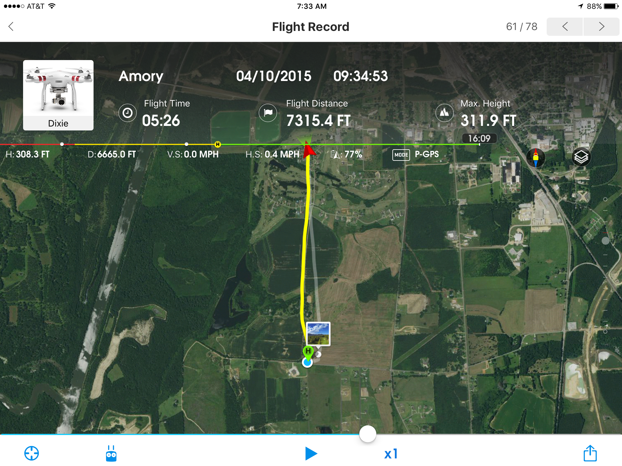

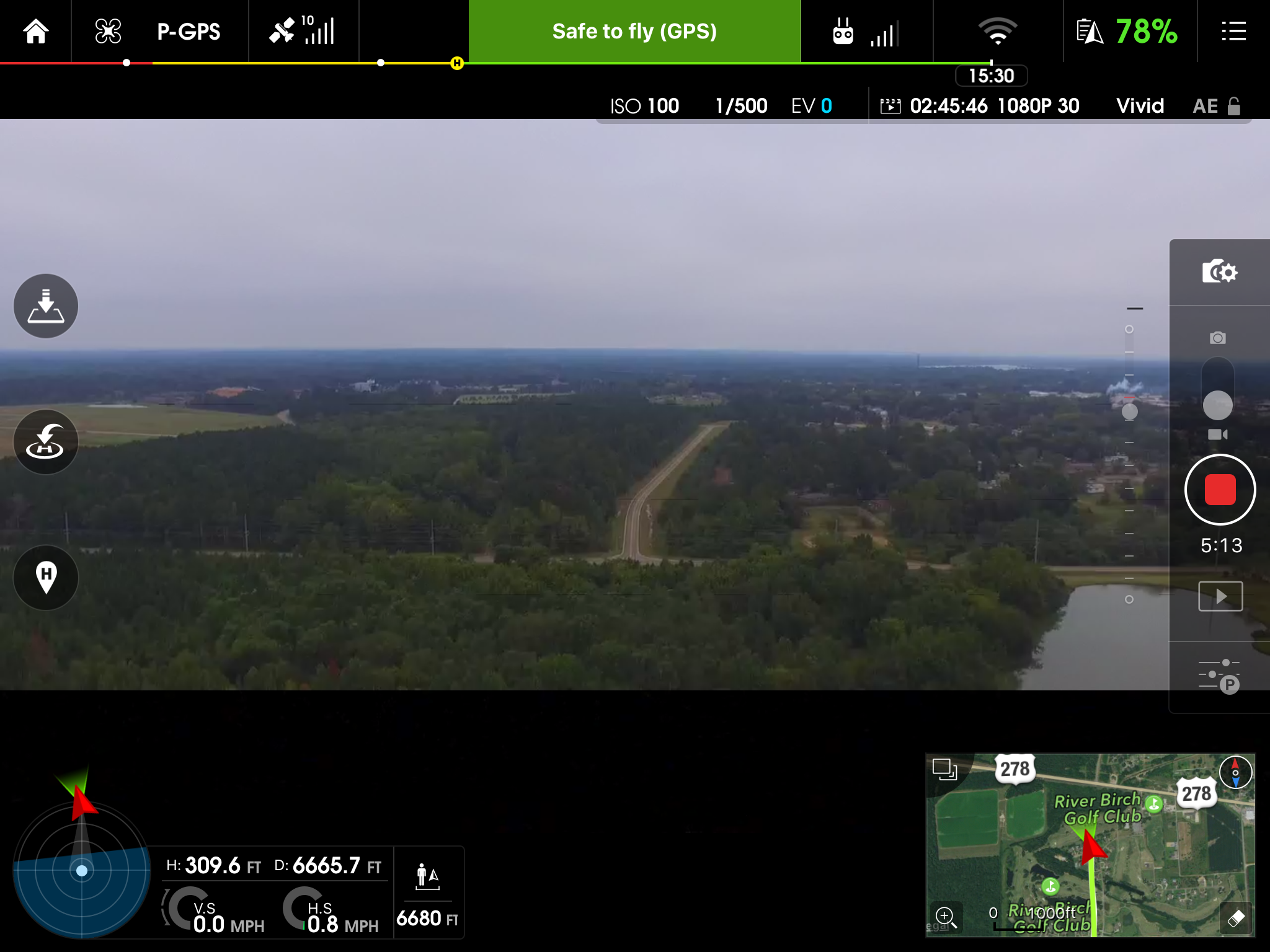

I just looked back and not sure what I was on but got mine and did the start up update on 9/22
Using that update stock I got this 6665'.PNG You can see the bars I had at that distance and here is the log now.PNG
And no zrherda Meta ,Ian,TJ or Gunsinger do not work for DJI . This is a privately owned site and though it might look sometimes like they
do they do not work for DJI . One of the mods here also mod's at the 3DR and YUNEC forum's which are owned by Jacob and several others .
Using that update stock I got this View attachment 37000 You can see the bars I had at that distance and here is the log View attachment 37002
Why does the date on your flight log show 04/10/2015
