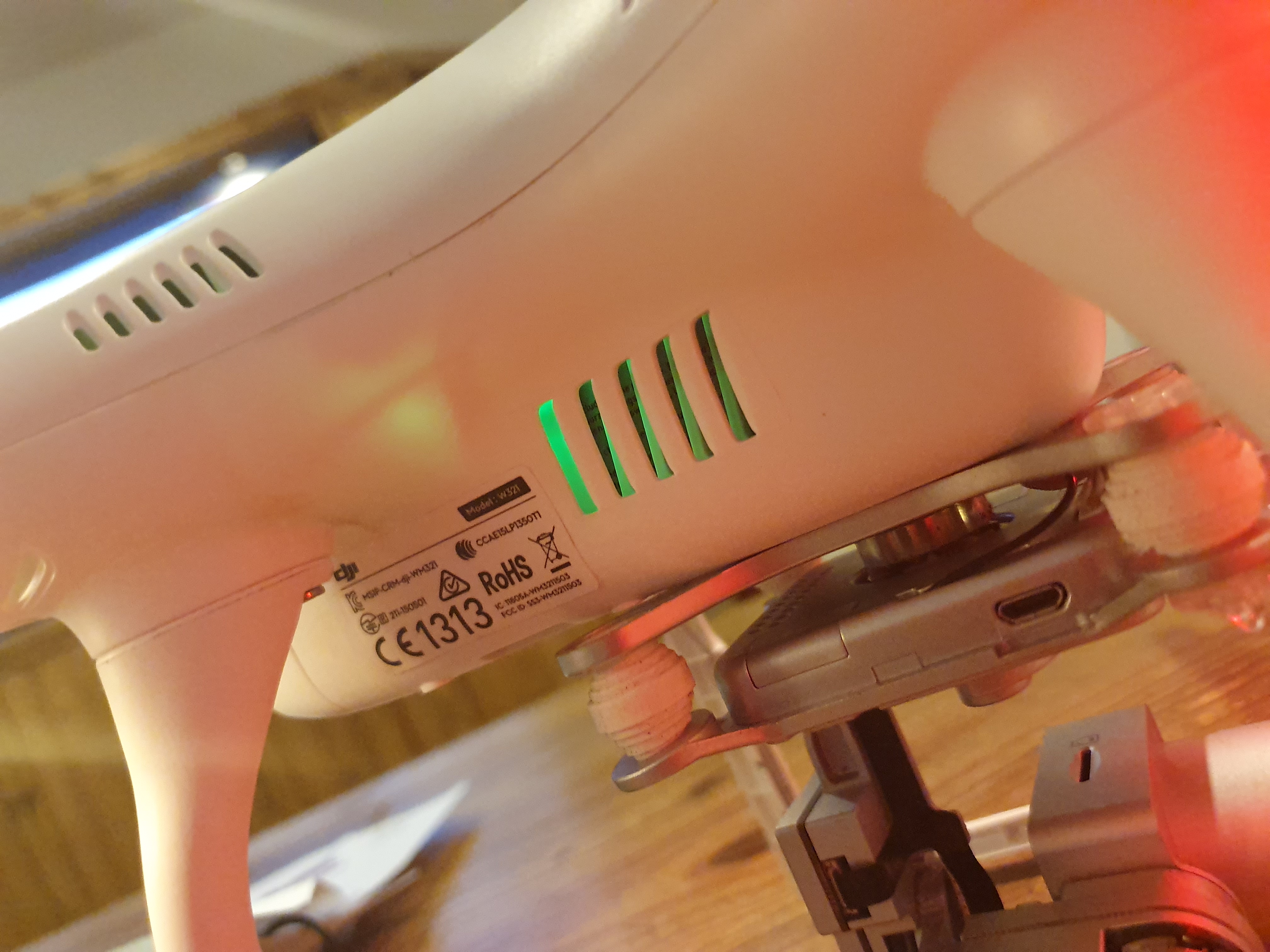

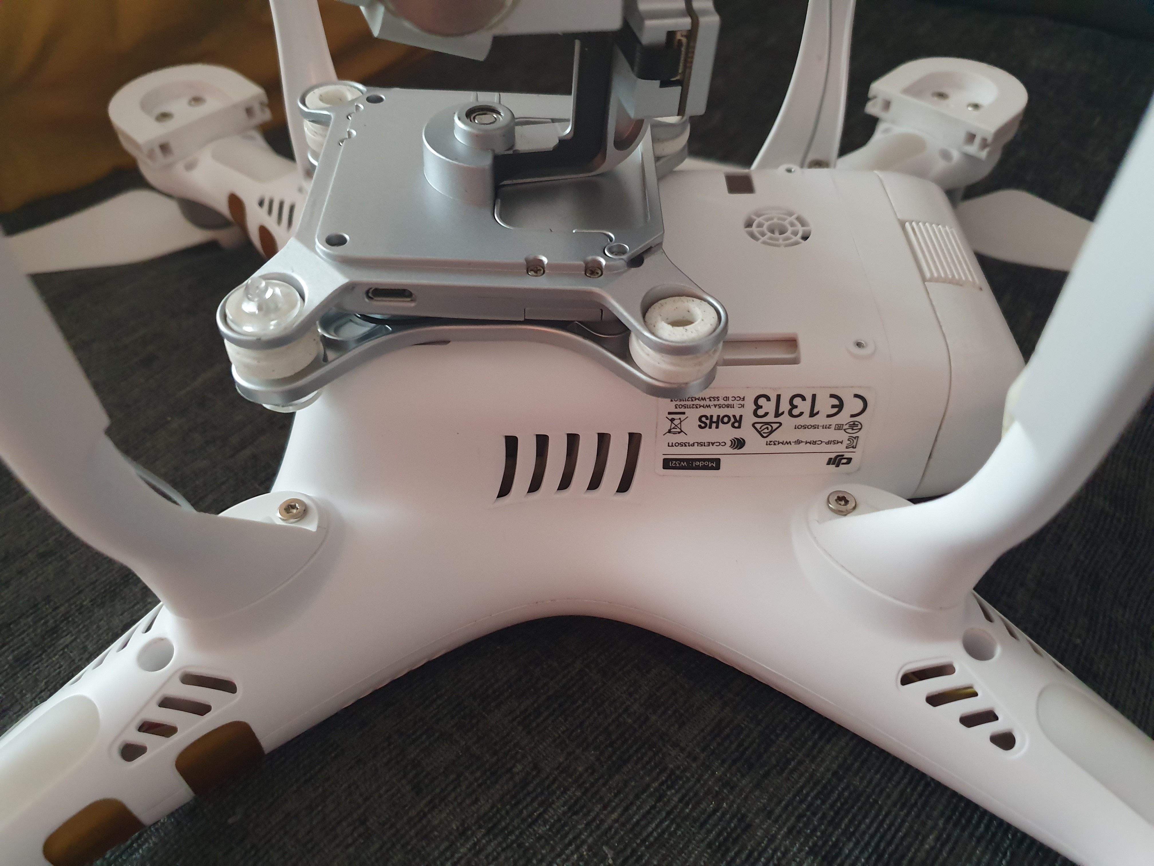

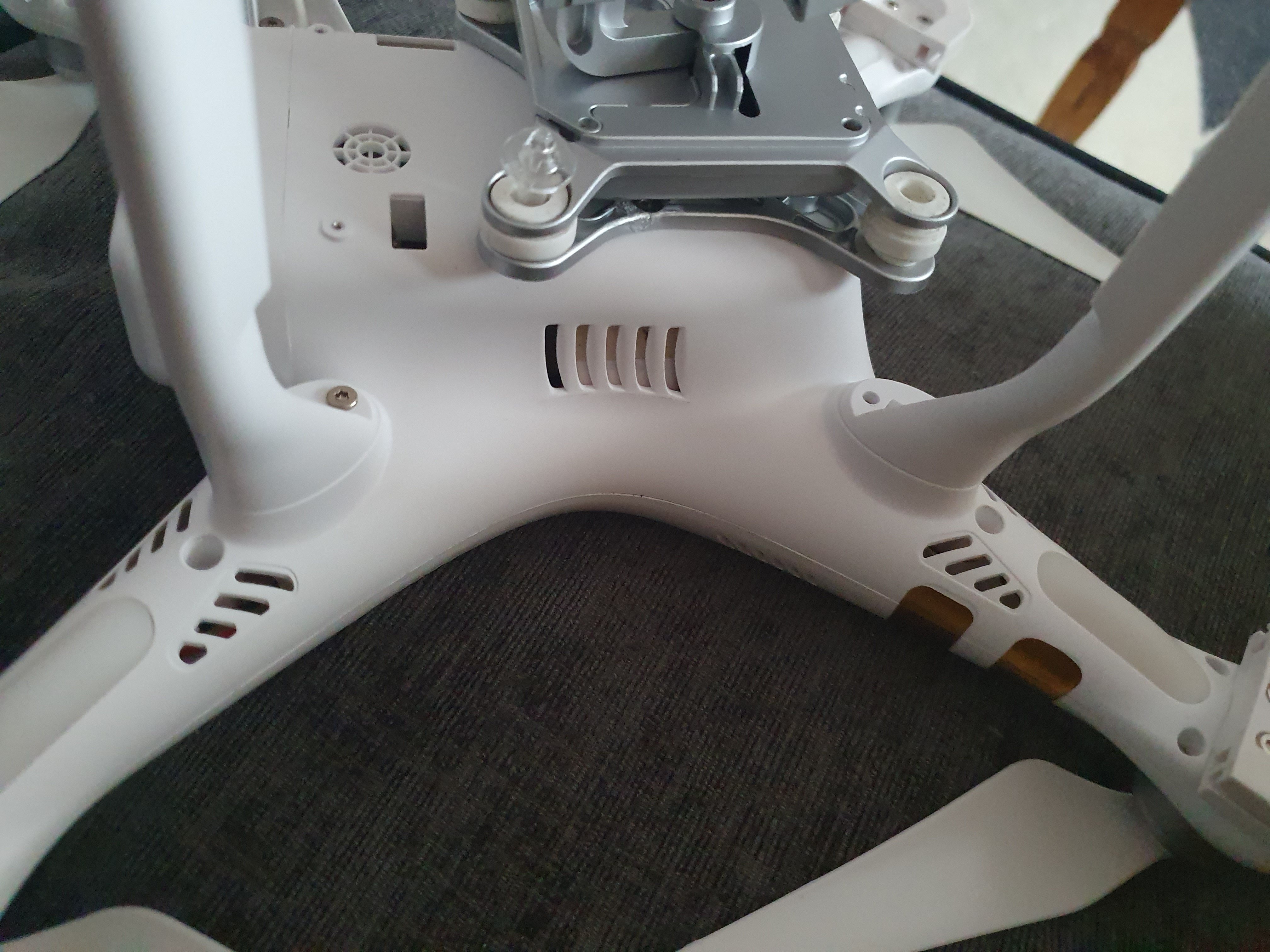

Just going over the drone now before testing the things you asked for . I'm trying to re link the controller to the drone. As some people have said a simple re link helps with stuff .
However I cannot find the link button on the drone itself. It seems to be missing . ( see pictures )
Any ideas ? Or come across something like this before ? .
When I switch the drone on .. there is a red light where the button should be.. which turns green when controller is on... =/ just nothing to press .

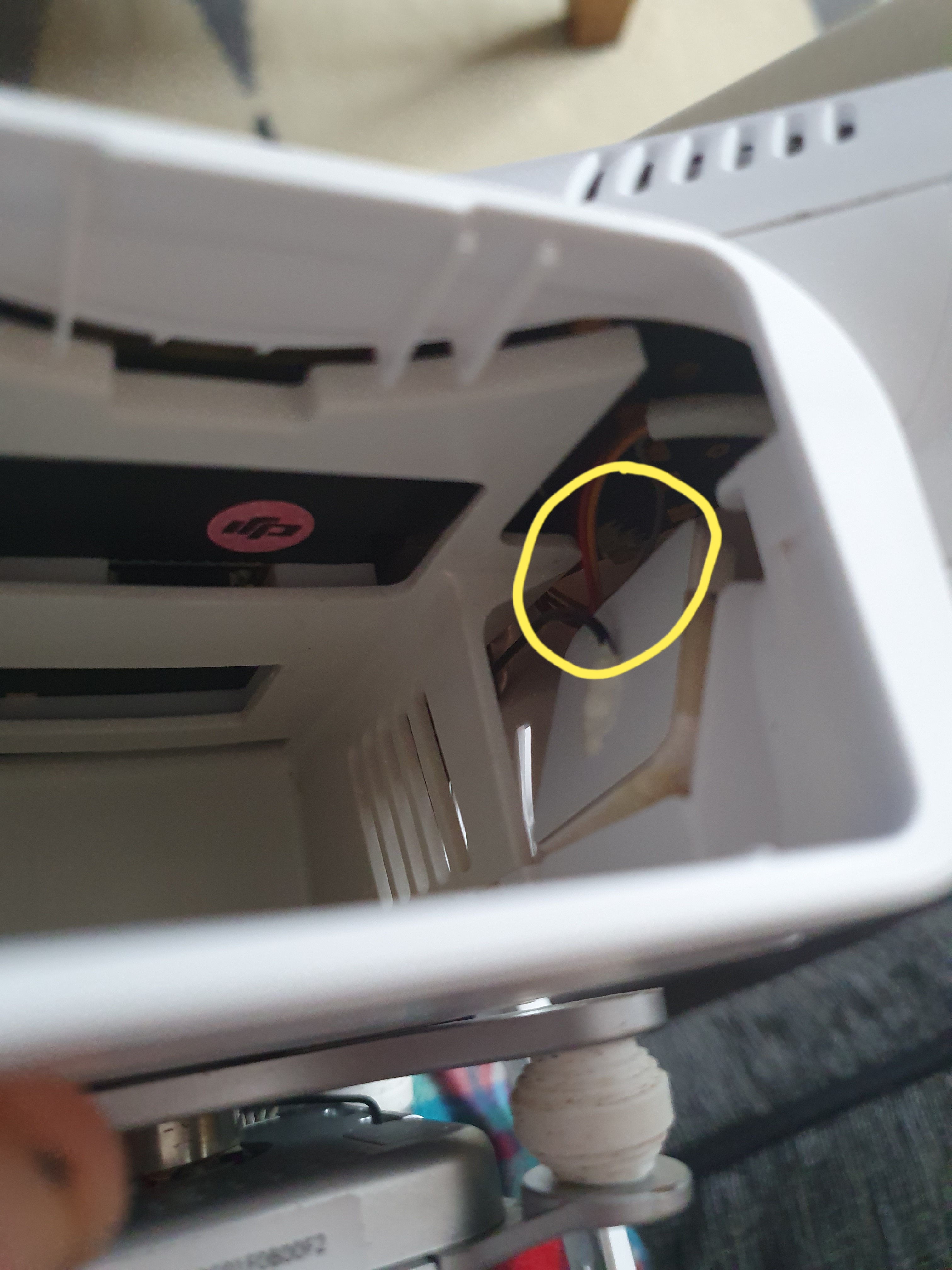

I found it once battery is out..
How does one push it .... ? If the battery needs to be in to power the drone =/ ?

Yes I'm confused too. All them seem to have link hole on side. However mine seems to be inside ( see the picture with yellow circle )

Hum, bottom shell is not a P3S. ;)
P3A, P3P link is in a different place and that is why there is a rectangle whole bottom of the shell.
Where the VPS would get its wires from and mount to the small screw holes.

I guess you need to drill a hole in the shell where you would normally poke it with small pin, I thought the light and switch were mounted on the main board.
Anyways normally the light and switch are kind of combined to be one unit. I really don't know what has been done, could be the light and switch off a P3A, etc.

I think someone has replaced the bottom shell with a P3P shell. You gotta get the link button out where you can press it with a battery installed.
