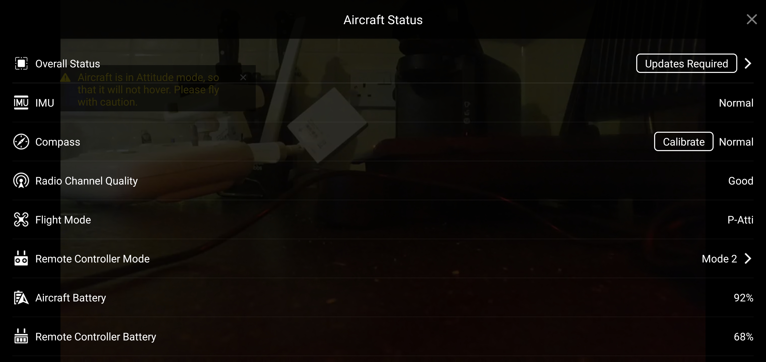

So I bought a phantom 3 standard .
Magic power 5.3 - 27db ( US region set ) I'm in UK
ArGtek atenna mod.
I kept getting signal lost issues
When I kept clicking the center bit on dji app.
It kept coming swapping between strong interference. Even though I'm out on countryside.
I took it further out the country and still got interfrence flashing on the app.

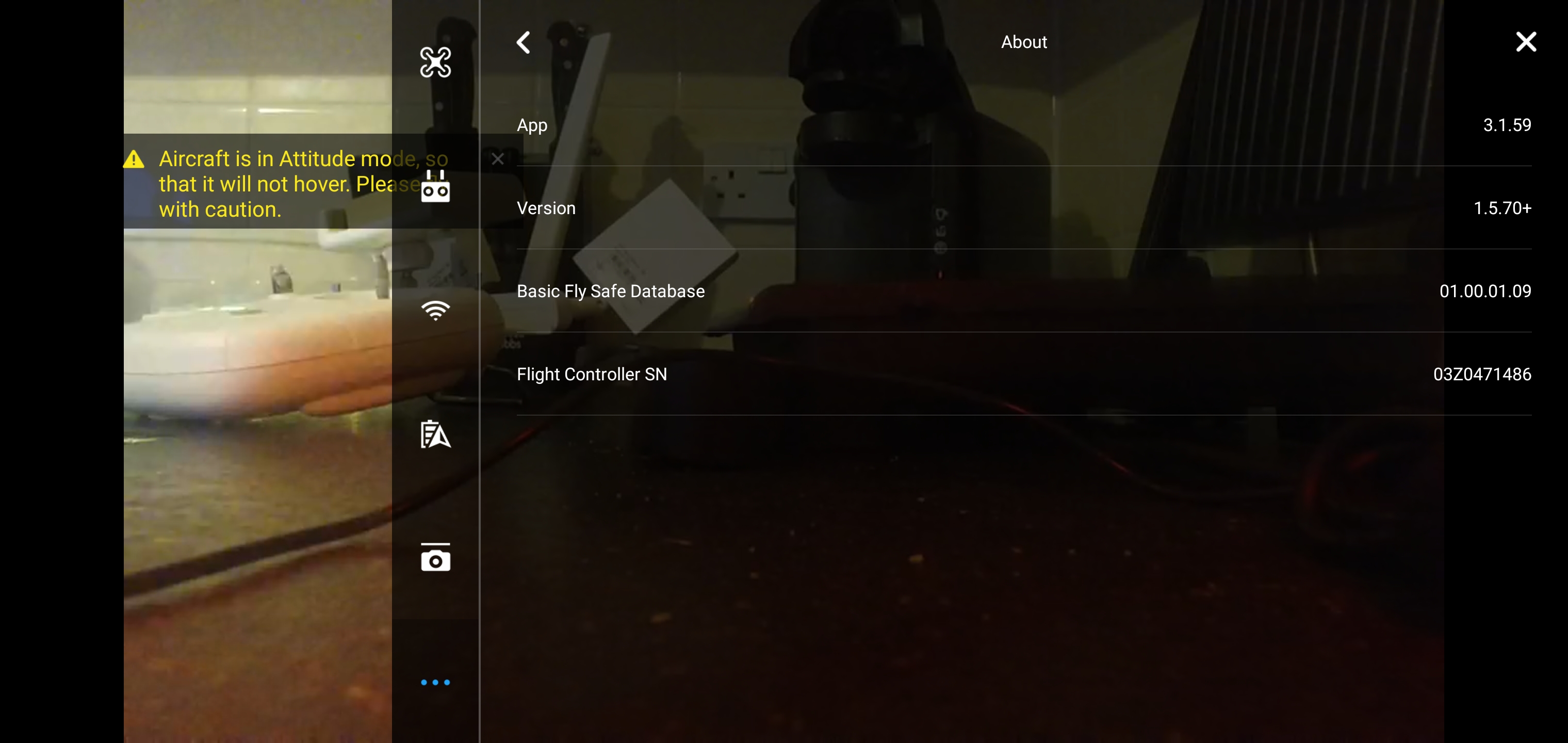

Today I downgraded to 1.5.7 and it instantly solved it .
Test 1 - 1.9.2 interfernce ( 4600 feet )
Test 2 - 1.9.2 interference ( 3800 feet )
Test 3 - 1.9.2 interference ( 1000 feet ) built up area.
Test 4 1.5.7 no interference ( 3600feet)
***** I will keep this updated with more tests *****
As I found mixed reviews on best firmware.

Did you use DJI Assistant to downgrade the firmware to 1.5.7?
Which website please, I have a Phantom 3 4K. I hope there's a bin for it or can use the 1.5.7
