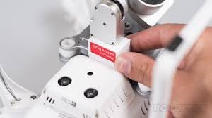

I think this may be your problem. Did you remove this bit of foam under the camera
Yes, I did, gimbal works perfectly, no abnormalities. I am also not new to drones, I'm just having an issue with props. I had my theory which has now been proven correct, I just wanted to verify with other folks. Thanks anyway. :)
