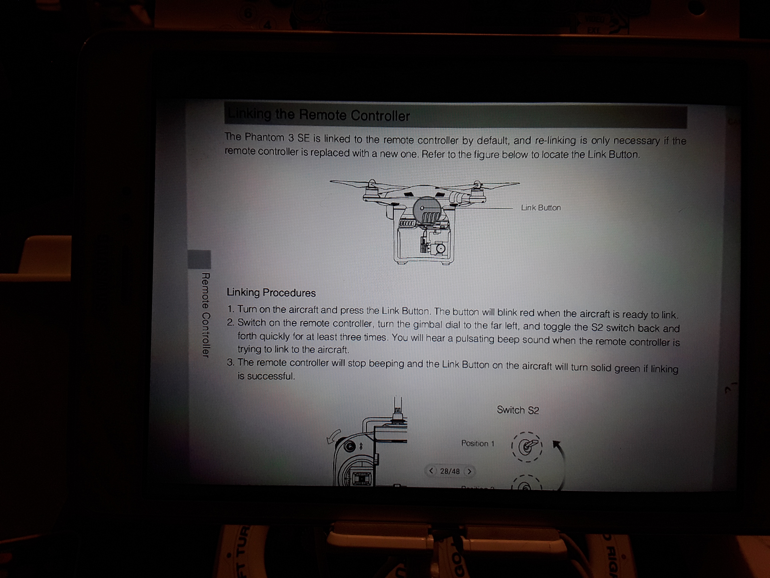

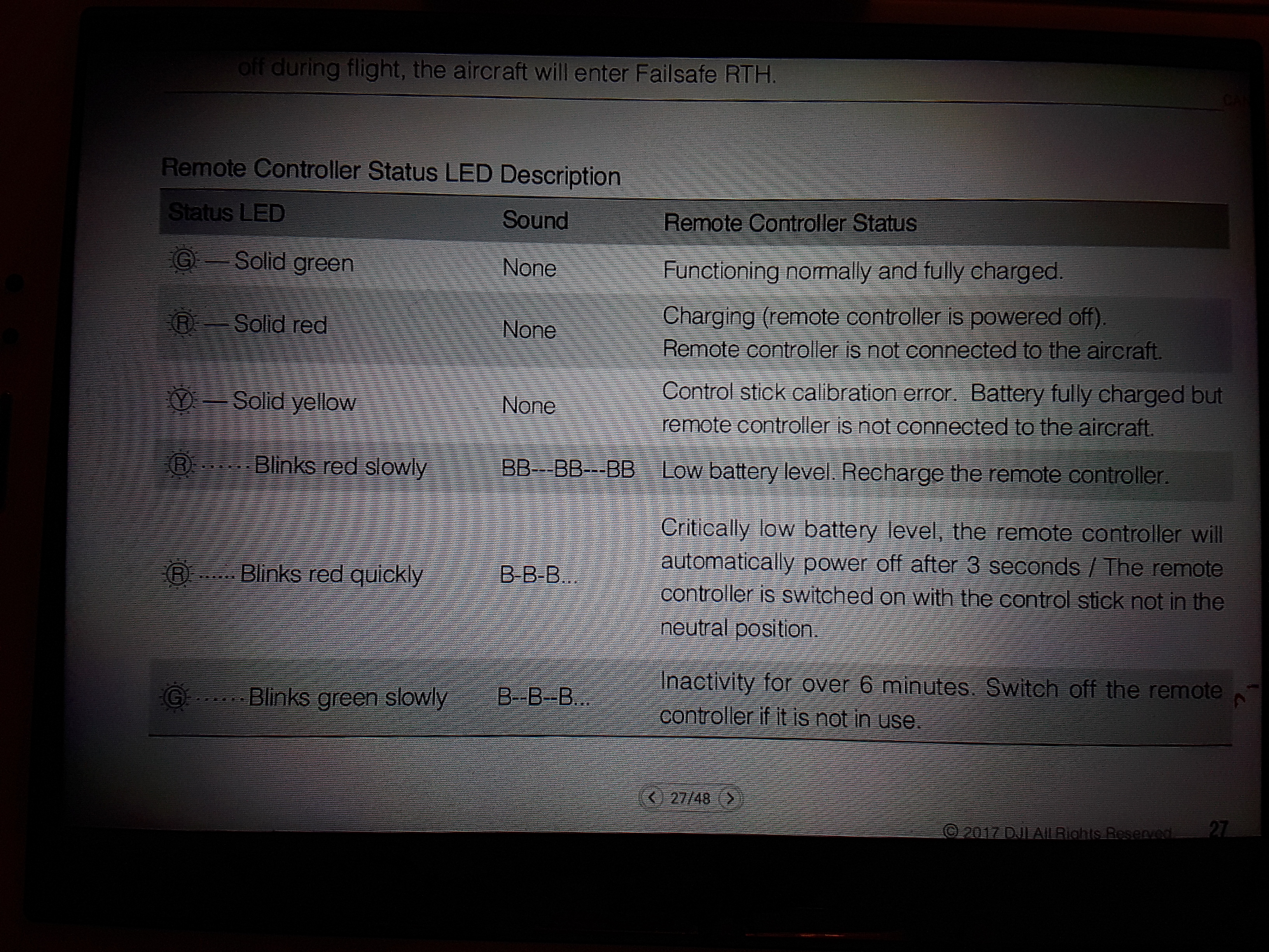

Far away,what colour your remote lights ,tyred relinking
My remote is red. Relinking is not an option unfortunately, cuz I can't get wifi and connecting via the wifi is the only way to relink the P3s/P3se.

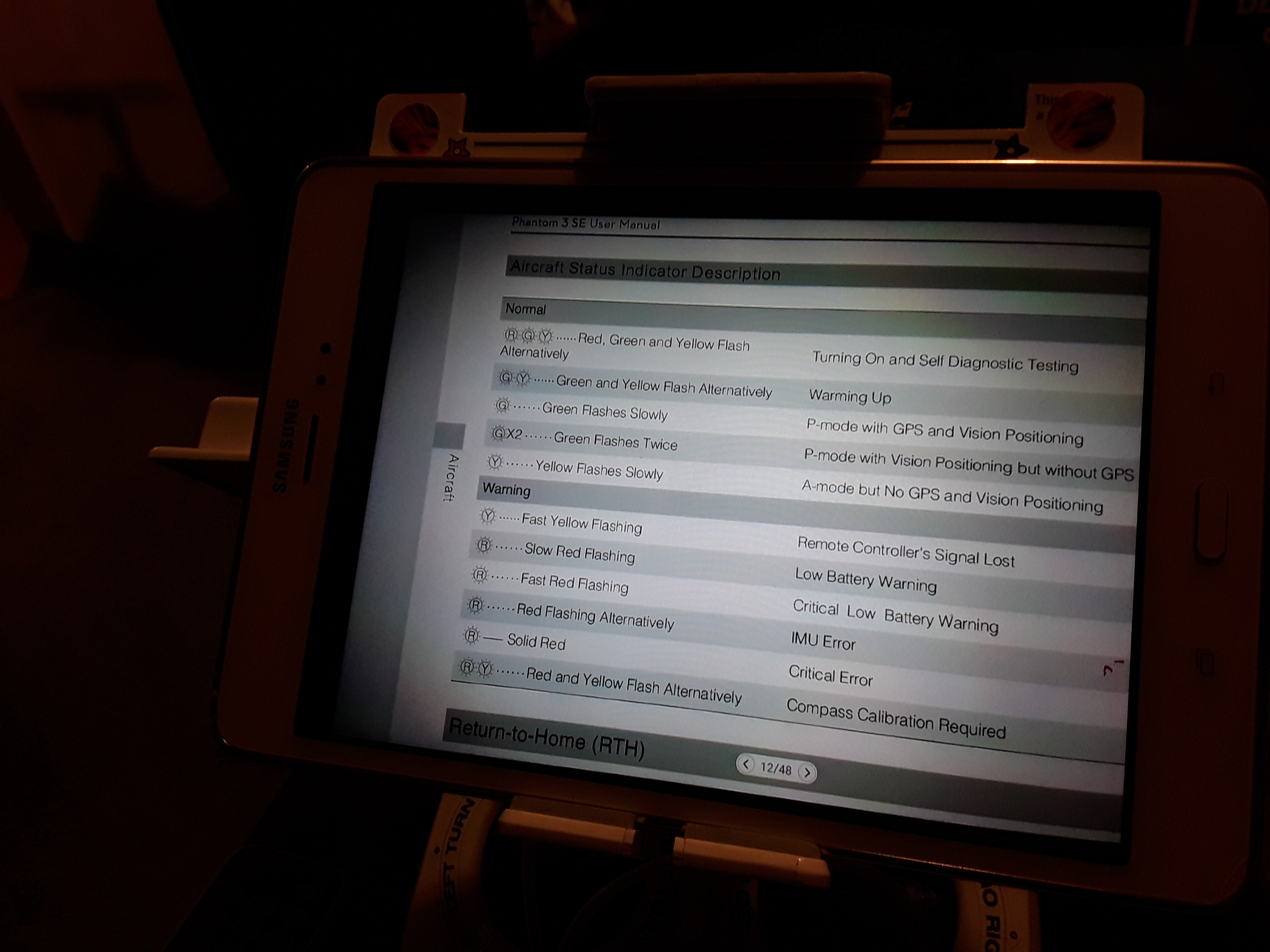

Red mean no conection,presume drone yellow fast flash ,no signal,slow yellow a mode,you just made me rad the manual ,im just gona go check the relinking
That's exactly what I see. It's just that the main thing I think of now is no wifi. As far as I know it should create a wifi even in case it's not connected to the drone, am I wrong?
All good wifi might show up when been relinked ,best of luck and thanks for waking my brain cells up:)

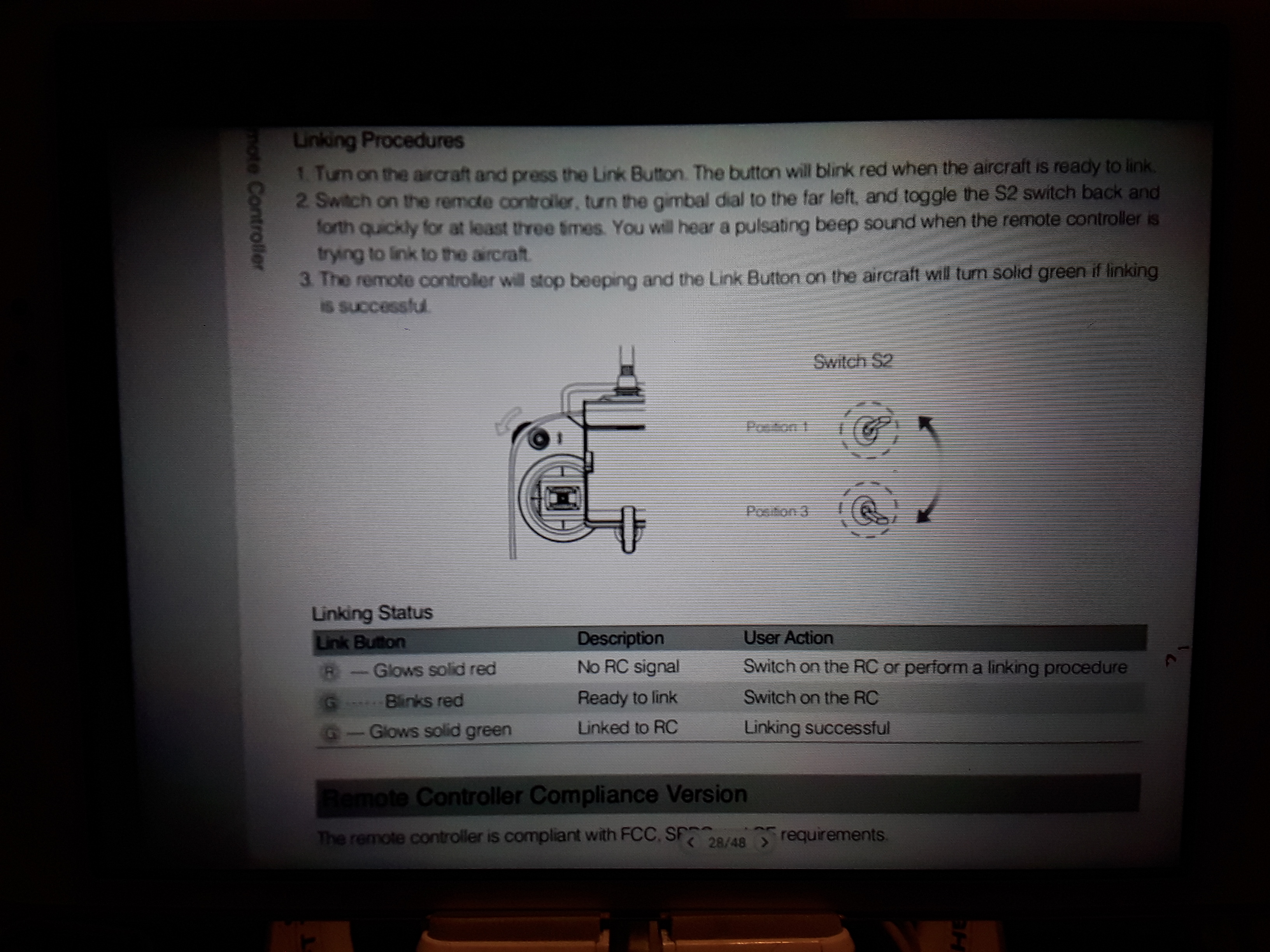

Well finally I got home and tried that. I'm afraid this doesn't do. The link button on the phantom is blinking and the RC is beeping, but nothing else happens. It's been like 5 minutes.
Have to ask still thinkin but what colour is link button flashing
Well it's solid red. The link button flashed red. Just had a chat with DJI, and after 2 hours they say I'd better get it to them.
That's the real pain. Is there anybody who can help me do something on my own?
I would down load the manual and read it carefully. Many times pilots come here with questions and problems that can be fixed and answered quickly. We are here to help but it might save you a lot of frustration and time. Good luck! [emoji256]. I'd certainly do that rather than sending it to DJI
Wow lost sleep over this one,had bit of a search today,few posts around where people have stopped firmware updates,they just been useing dji assistant(app) but from what i read needs to be done through computer,not sure how works never had to do,but if you search here you should find how this is done, i think this your only option apart from sending it back,mayby someone can post on forced firmware update information for you,best of luck with this,
