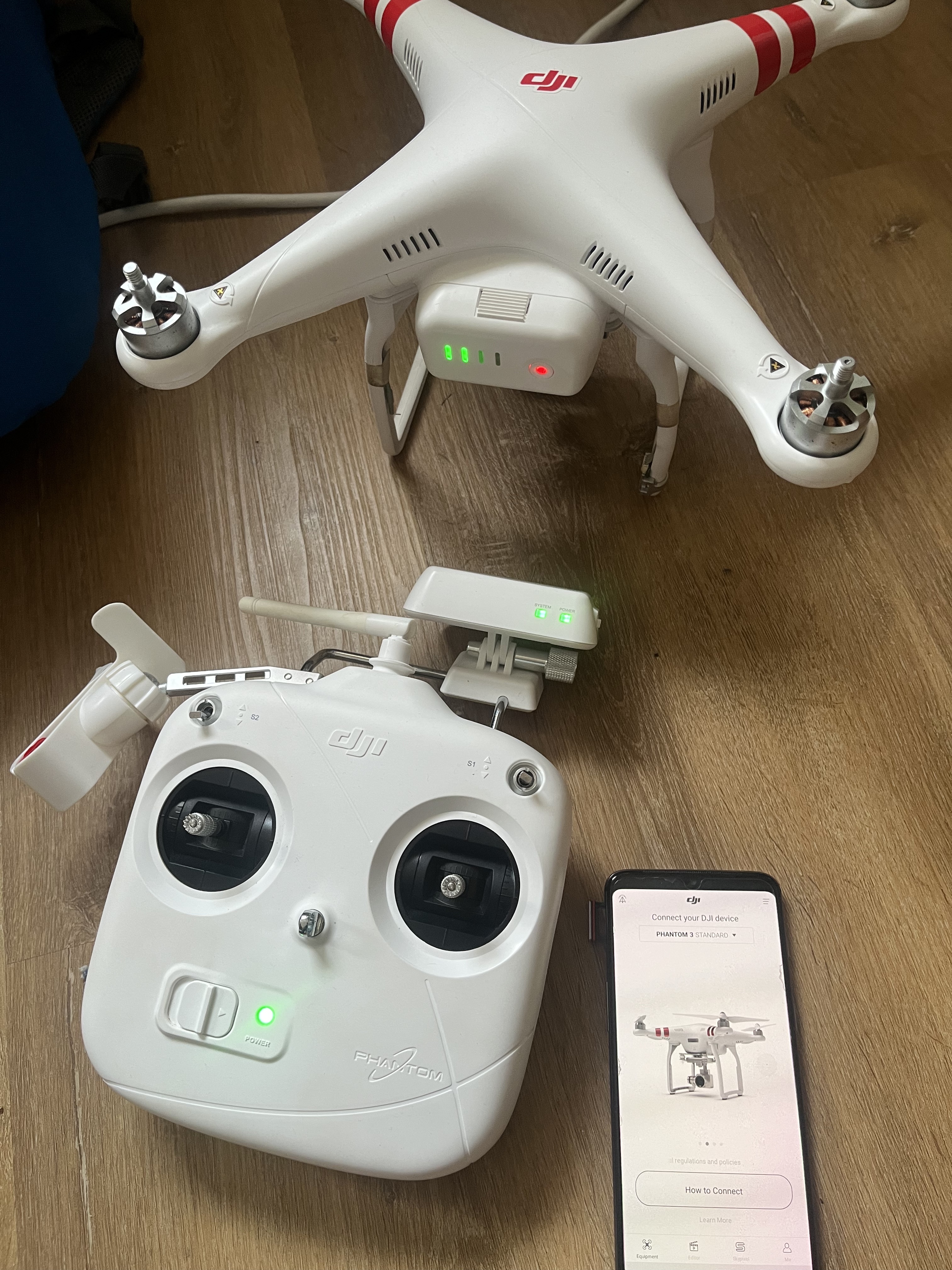

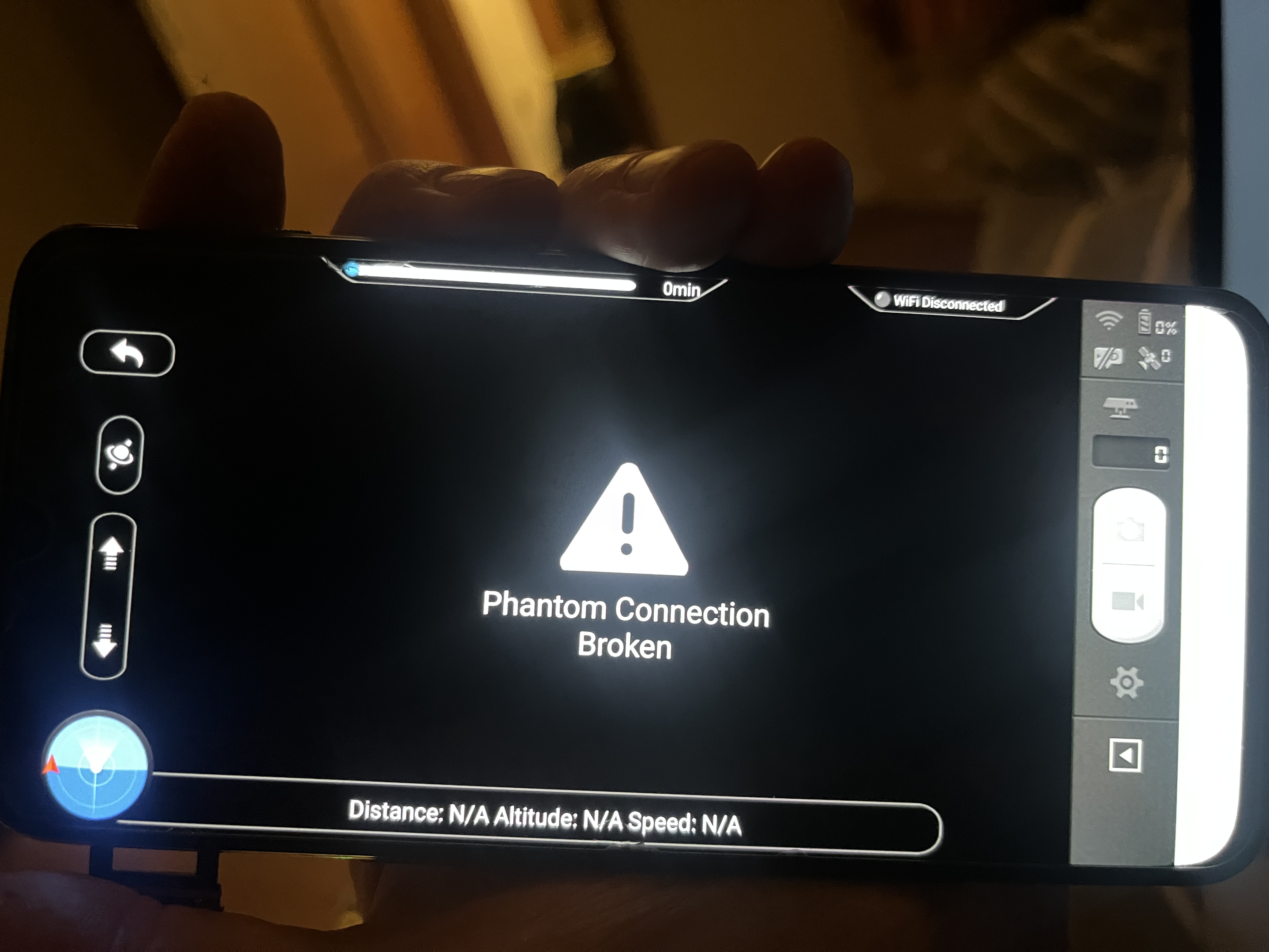

Update: I got myself now an old Android phone (Oneplus 7). I downgraded the OS to Android 9 which was a version that supposedly supports the old DJI Go Version still well. I downloaded the apk form the official DJI website. It installs DJI Go v.3.1.83....
Still no success.
Camera View does not show up.
So I tried to remove another possible error source: link between RC and Drone iteself.
I therefore followed the official documentation:
-> power on the camera and range extender, 10s later press the Rebind Button on Range Extender with a cuspidal object, 5s later the SYSTEM LED is off.
-> wait patiently, the WiFi system of range extender will be restored about 25s later, and the SYSTEM LED will blink green
Result: The system button blinks solid green but after some 5-10 seconds turns off, and then after 5-10 seconds on again... so you could also say its a very slow blinking. But also this is quite inconsistent. Sometimes the system green appears or disappears for even longer times.
The drone, btw. blinks slow yellow. I guess this is the case because I am indoors and the drone does not catch a GPS. But I would guess link everything would not require me to have GPS and be outside.

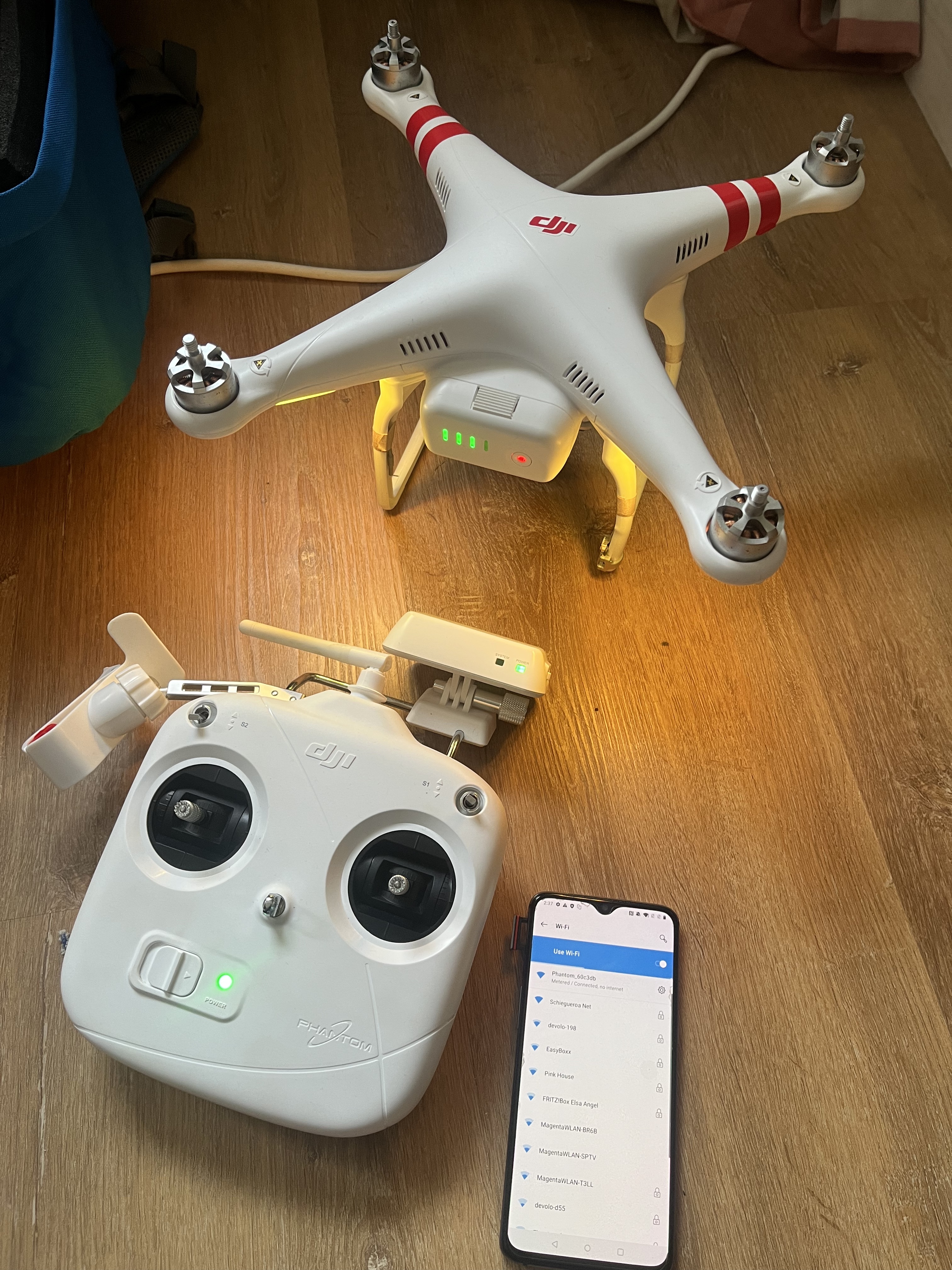

I tried it with several phones. The WiFi is visible. I can connect. I do not even need a password. But there is no "camera view" on the DJI app. I. took two fotos that summarize the situation. Also I dont think I have a gimbal dial...or at least I dont know what it is..my RC is quite basic (see fotos).

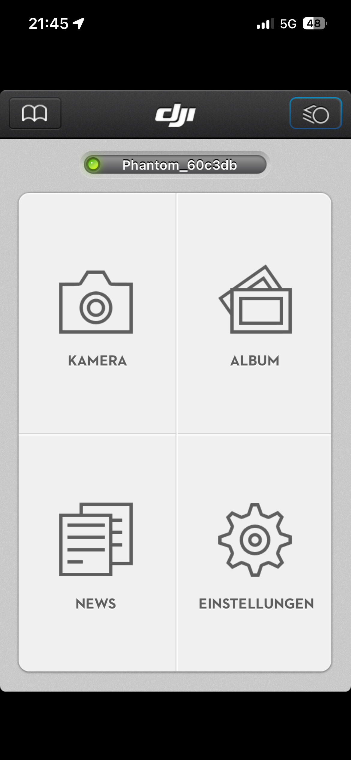

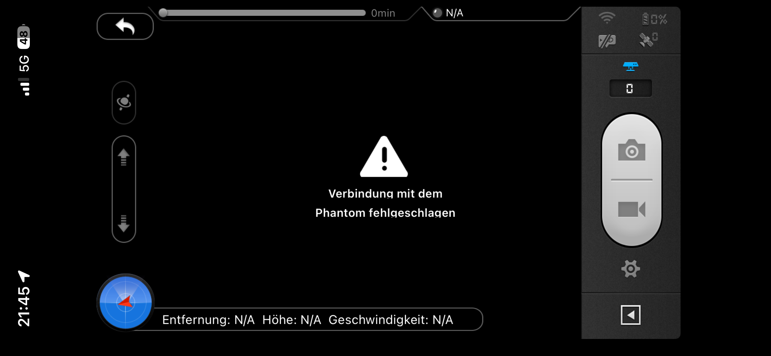

ohhhh. big fail from my side. Visually it just looks like the phantom 3.
So with the Vision App I also have no luck in connecting. I can connect to the wifi but somehow the app does not recognize it or is somehow unable to get the stream. I tried it with a new iphone and the old Android 9 phone. no luck so far. Does it make sense to try it with even more cellphones or is this likely a hardware defect? is there any sparepart I could change easily if so...?
