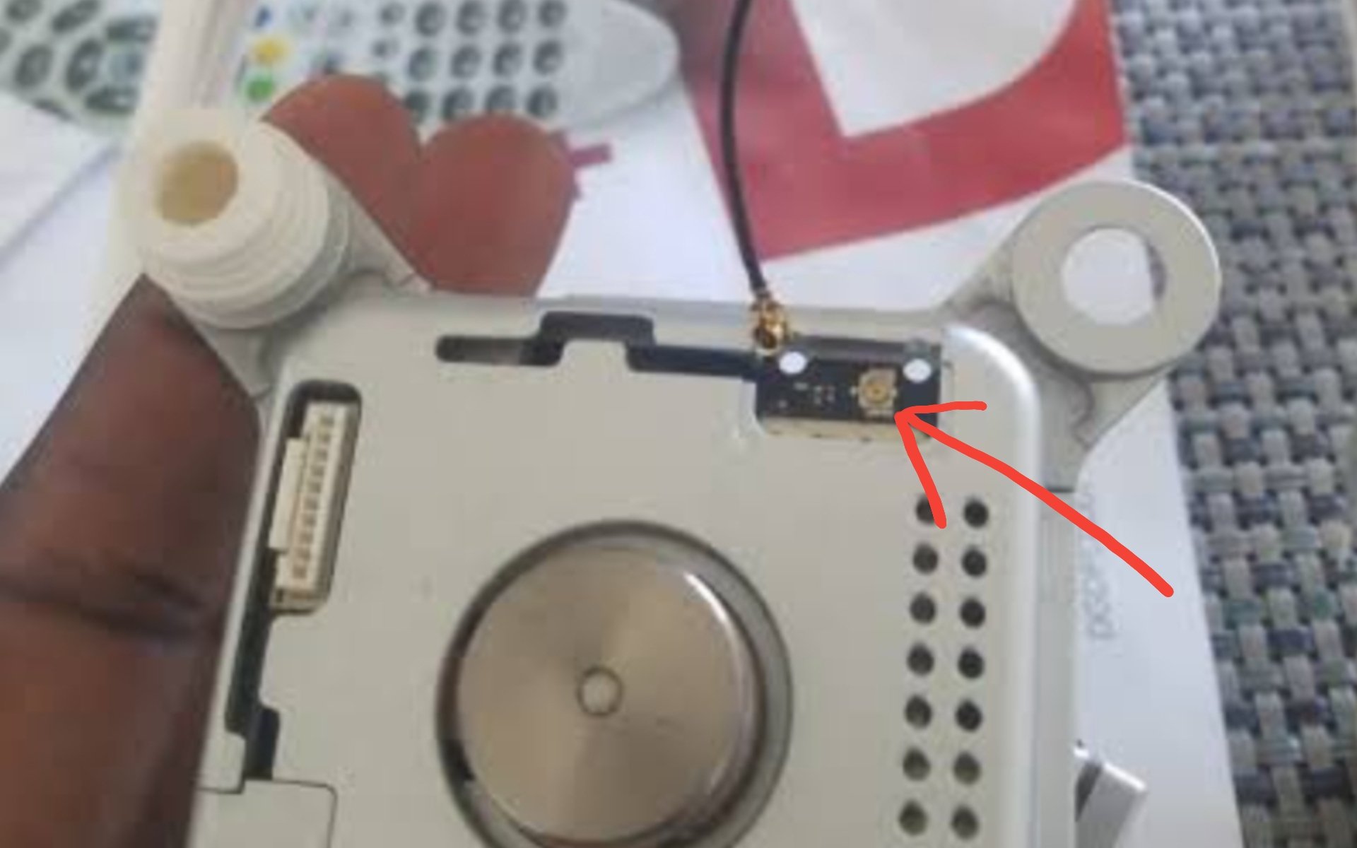

I’m going to test the 2 grey antennas tonight and see

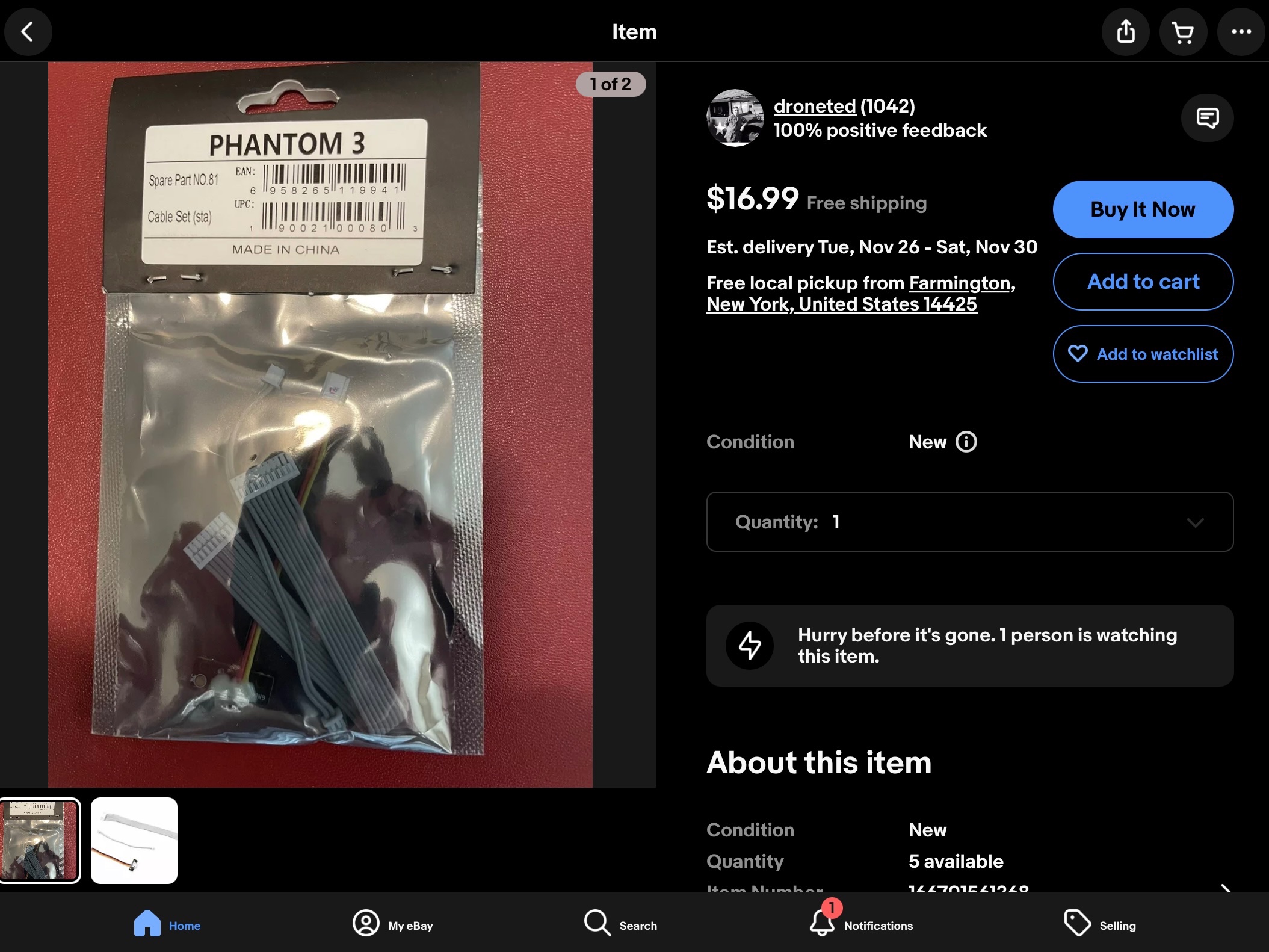

In case you'd like to swap out the questionable flat gray cable for a new DJI OEM cable, they are available....usually in a set...called Part #81. A highly rated member here on Phantom Pilots Forum is an expert at drone repairs, and also offers parts for sale on occasion. He is @Droneted and has a listing on EBay for the Part #81. Best of all, it is a 'Genuine DJI OEM' part....not a knockoff. I'll add the info below.

Sweet check the plug itself just to make sure they still Male female and the spike on board not lost his point ,and check where goes on board if still secure. Its possible that when the 8 wire plug got stretched a bit the antenna wires might have to,,can only move so far before they get pulled on,,that's where you might have to find out history on the how hard what ever impact happened, most probably a hard landing ,there's a little module screwed in the bottom of landing gear also but most likely it's up top
The grey and black wires make and female contacts are still their but the grey wires insulation is a bit broken but the cable is connected still to the strand in side
Since you can see some insulation damage it won't hurt to replace and have spares for future,
I was just bein tight referring to the grey flat wires bein ok,well they work BUT a new one keeps the terminals in line just incase the white plastic plug has a scuff where wire came back through and might not contact terminal on board properly when pushed back into plastic housing ..your drone buddy probably got parts yon need but spares r good
