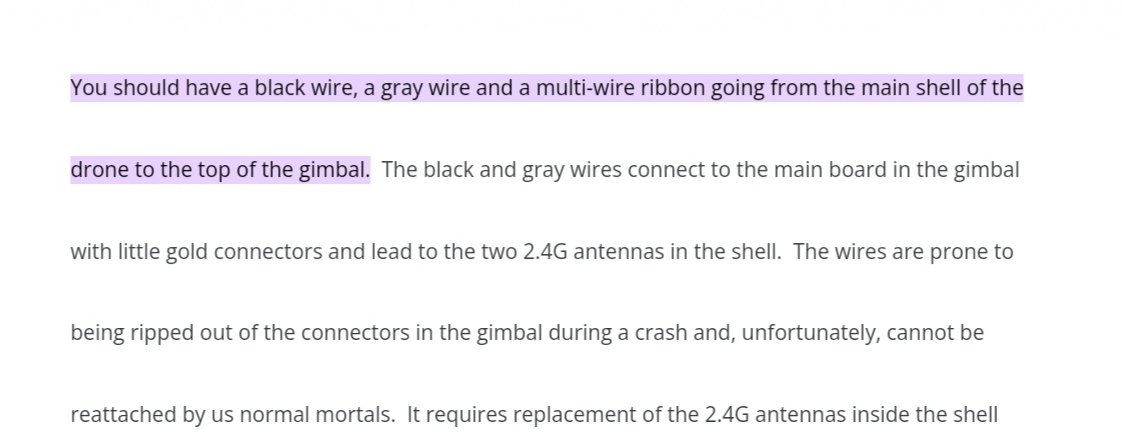

I did see this yesterday so I took screenshot,things that can prevent linking , you mention it got hot before you fix the gimble wires,do you know what got hot,,well your getting there ,perseverance prevails ,,,I not one for advice on firmware as I avoid it as things can fail , cant advise further on that

Yes the RC beeps and the Link light on the AC blinks red but no connection seems to happen last time I turned it on it did connect and I was able to arm the motors! I think there is something to do with 2 Small antenna wires that connect to the gimbal (the one with gold contacts grey and black)

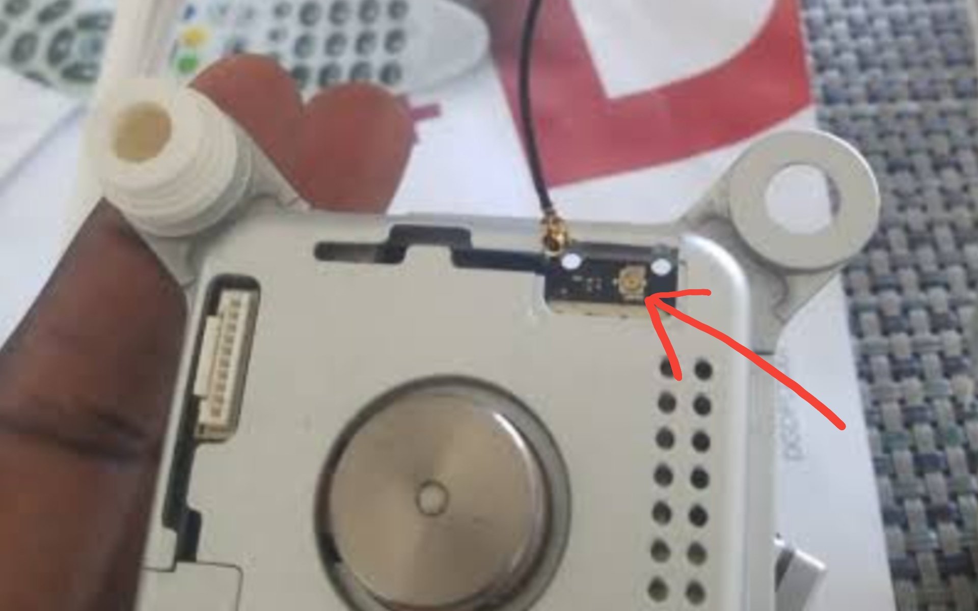

Ah sorry those gold plugs are male to female conection,,the Male plug is soildered to the board, the female black wire,,, small pin in middle of plug can snap off into black female wire so even though it connects to board it might not contact the center pin
My example picture show center pin , the conection on the board has centre pin but small version and fragile or it can pull the Male loose on the board due to lack of soilder they use

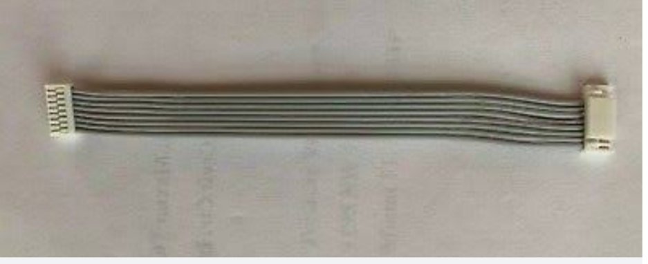

Best way get wires all flat together in line , make sure white plastic plug is opposite way up from other end and re insert the wires into plastic plug ,the wires dont criss cross they just stay nice together and should be sweet,I cant remember antenna wire colour,I just check
Reactions: RodPad
Best way get wires all flat together in line , make sure white plastic plug is opposite way up from other end and re insert the wires into plastic plug ,the wires dont criss cross they just stay nice together and should be sweet,I cant remember antenna wire colour,I just check View attachment 126177
I think my wires are like that
Reactions: RodPad
My wires weren’t ripped except the grey multi wire ribbon so I have some hope
