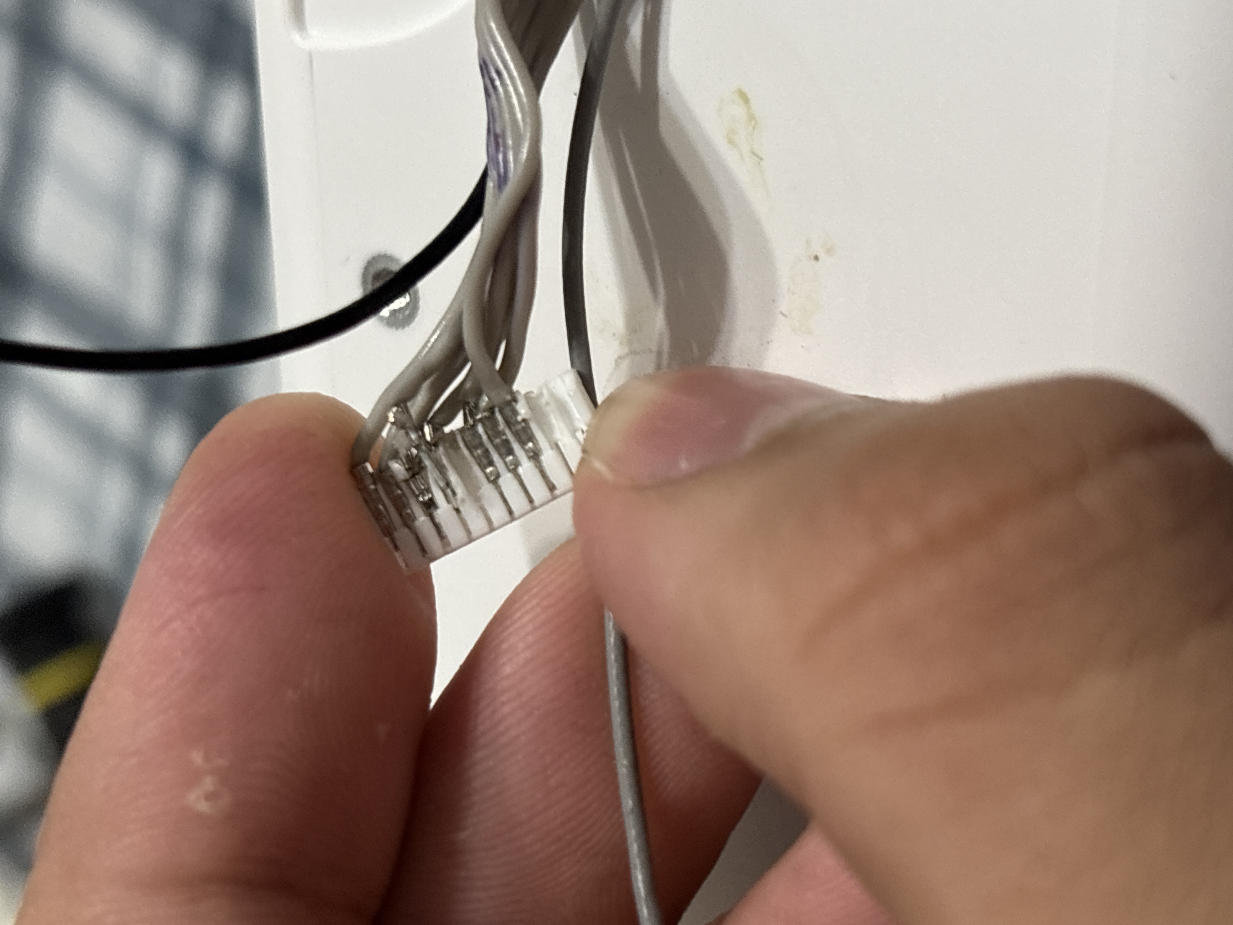

I disconnected the gimbal and the drones strobe power on now With sold red in the front and flashing yellow in the back, I found the culprit I believe the Grey ribbon wire with 8 pins in it is broken
Awsome find,,you might be able to fix that since no snapped wires, also rc linking in the app 👍

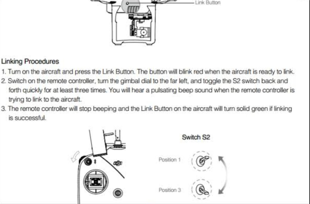

This is manual linking process without app conection

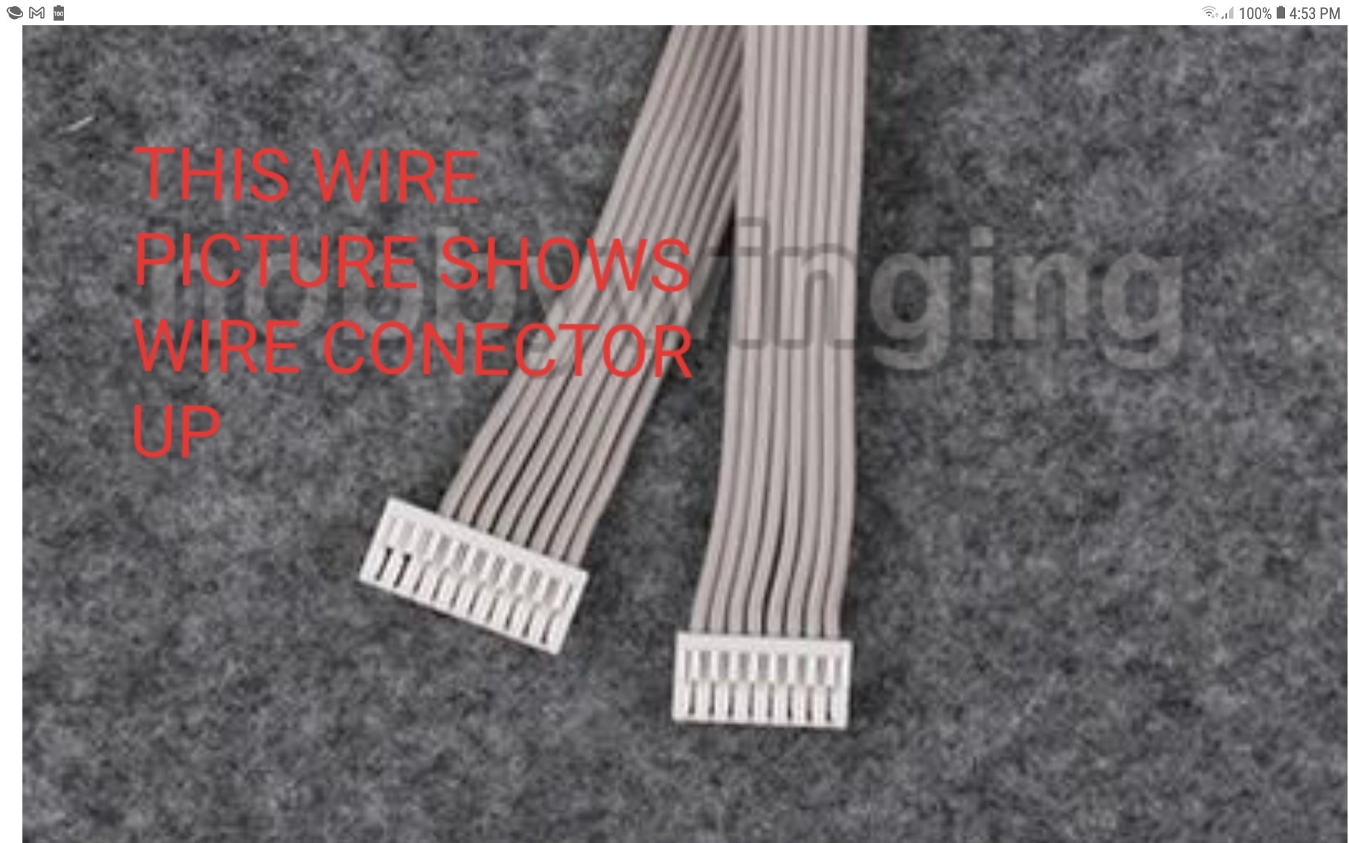

Yeh sure diagram been posted here before, might be able to locate the right sequence of wires with how they sat in the plug but I'll see if I find a picture
Reactions: RodPad
Yes if you can that would be awesome
Found this pic from another thread on cable and shows plug conection facing upward to use as a follow guide ...picture taken from thread below to see and read in the link here

Does telemetry work without fumble as I think this wire is kinda messed up
Any pictures help if you unsure of anything,helps those to reading to follow

Do you have app installed ?
Can you navigate through app ok , under RC settings there's linking there too, have you tryed this yet, this in app process you have to move gimble wheel like the directional pictures it shows you to follow or it dont save or have you tryed this process and it just times out without linking,you get 60 sec to press link button before it times out in which you start process again . Does it complete or fail ?
Sorry for questions but it help fix or point us in right direction
There are only these 2 ways to link , in app or manual without app
Good effort on the gimble repair too
