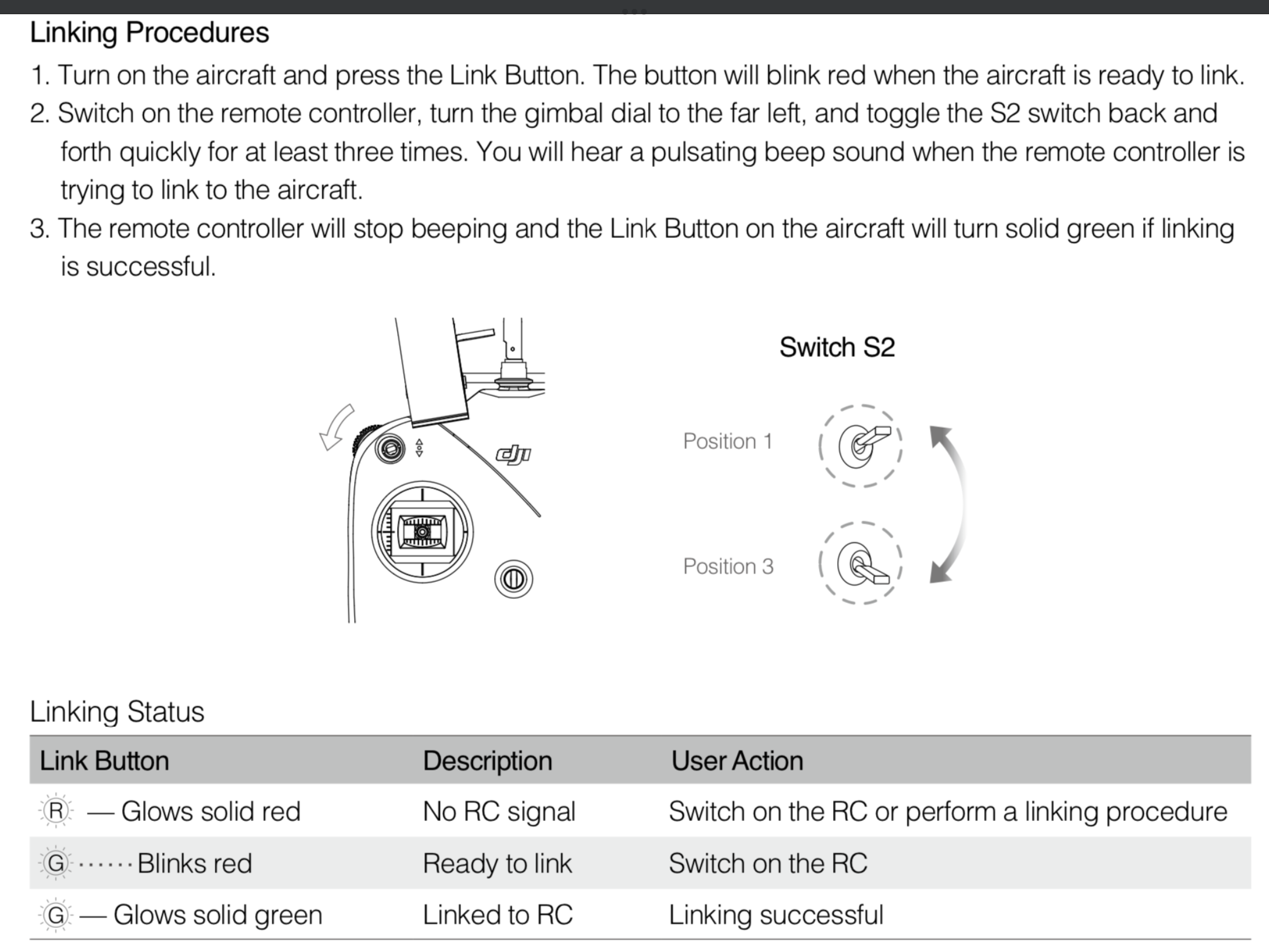

Can you navigate through app ok , under RC settings there's linking there too, have you tryed this yet, this in app process you have to move gimble wheel like the directional pictures it shows you to follow or it dont save or have you tryed this process and it just times out without linking,you get 60 sec to press link button before it times out in which you start process again . Does it complete or fail ?
Sorry for questions but it help fix or point us in right direction
There are only these 2 ways to link , in app or manual without app

Ok and what does manual method do ( without app) but as diagram shows I dant remember if you hold gimble wheel one way while flipping switch back and forth

So with the bird turned on, if you press the red link button/ light, does the light blink red to indicate it is ready to link to the r/c?

I just mention also press and hold link button for at least 3 to 4 seconds to see if helps
Turn on drone first, let it start flashing ,turn on rc and try link
