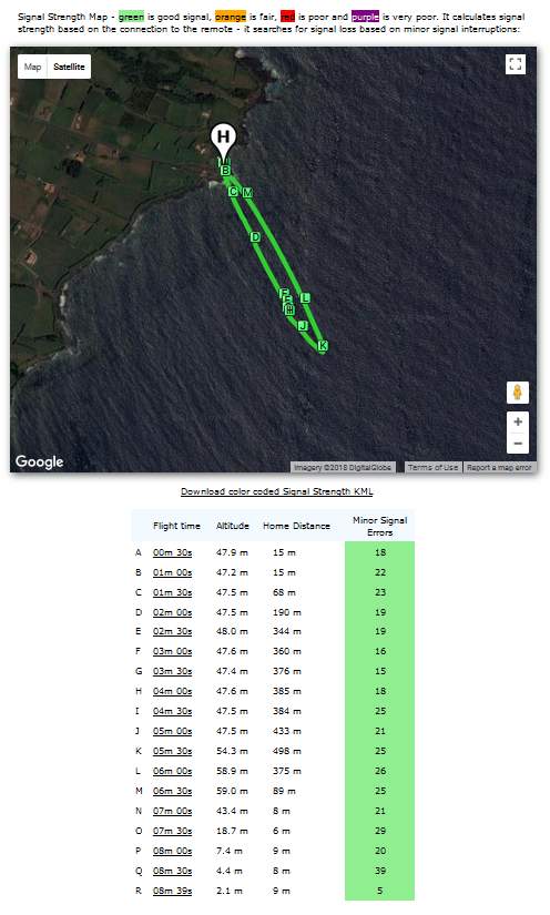

UPDATE: Flown line of sight over the sea at 50 m height (165 ft) to a distance of 498 m (1634 ft) before it lost signal and started auto rh. Not the best range ever, but much better than before.

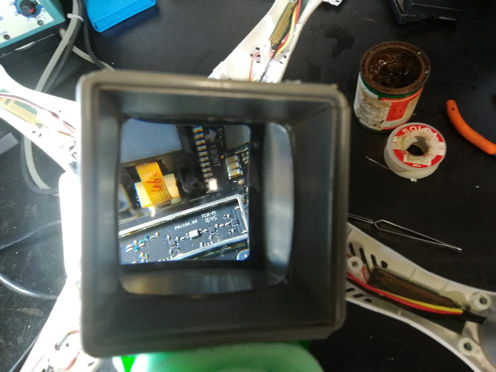

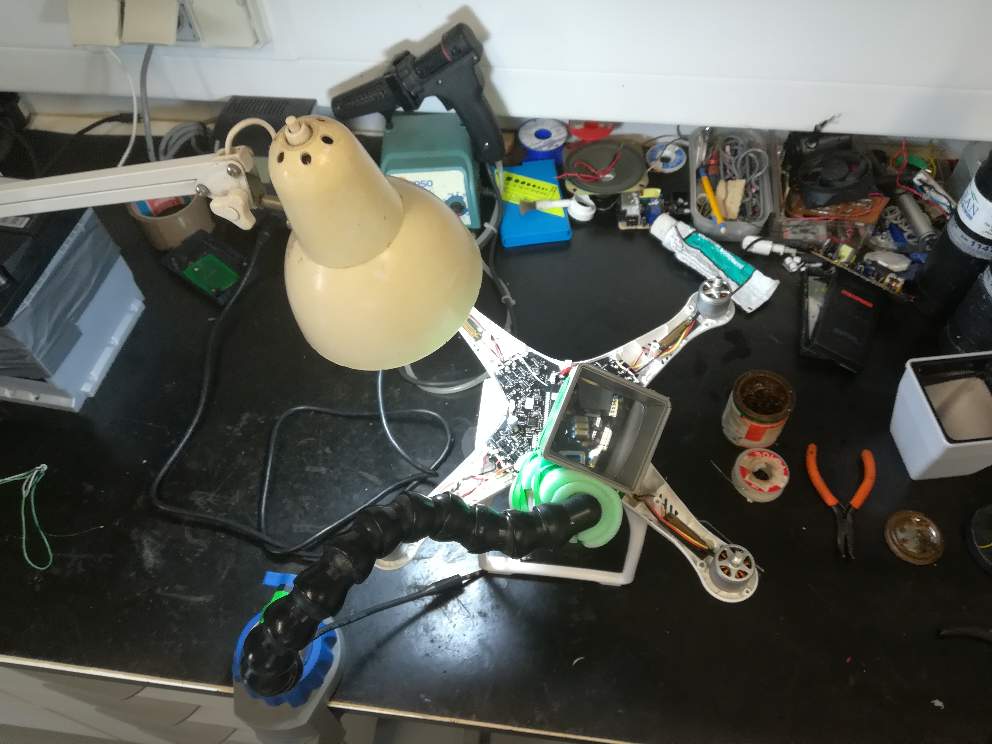

2. Get a decent workshop; you will need a few tools and material:
a. Soldering iron and good quality solder
b. A short length of thin insulated electrical wire. I used a wire that was 0.7 mm (0.03'') in diameter (measured with a calliper)
c. Fixed magnifying lens. Optional, but it will help a lot!
d. Tweezers
e. Scalpel, X-acto or other very sharp tool to remove the malfunctioning S20 chip
f. Good lighting

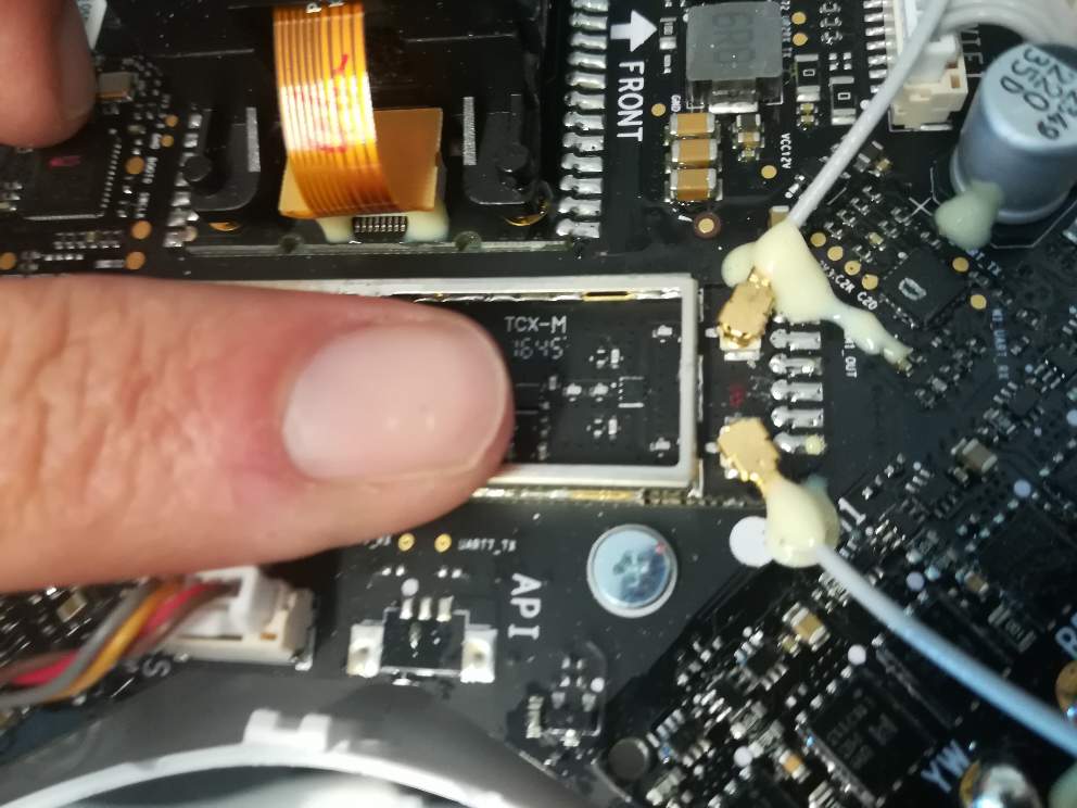

These are VERY small parts, and a challenging soldering. Just to give an idea, here is my finger close to the working area

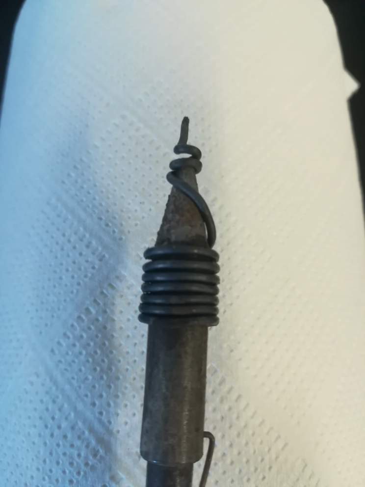

3. Make sure your soldering iron has a small enough tip. If not, you can improvise one using a copper wire twisted around the iron tip; if necessary you can further sharpen the tip with a file.
4. DO NOT attempt to make the MOD without training. I spent one afternoon practising with an old electronic board and the next morning I trained a little more before attempting the MOD. This will show you what can go wrong and give some muscle memory.

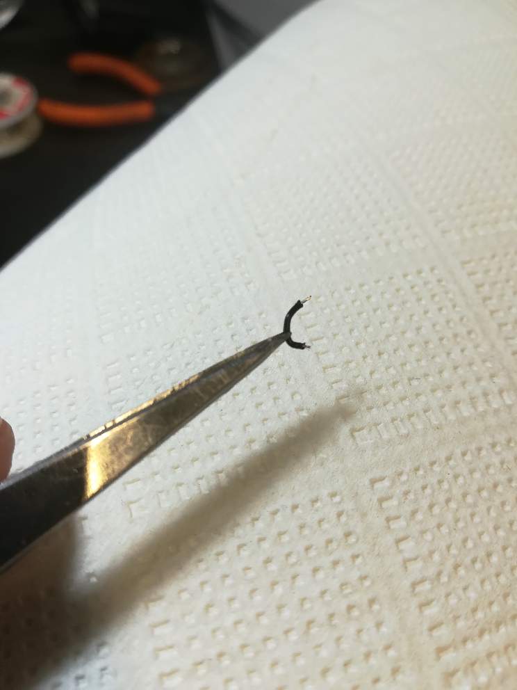

5. Cut the wire to the desired length (less than 1 cm; 0.4''), expose a small amount of the metal wiring (~1 mm; 0.04'') on both sides and apply solder to the ends, leaving a very small (almost undetectable) drop of solder.
6. Crack the drone open (if you never did it, watch some videos before you do it). REMOVE BATTERY! Locate the metal rectangle with the little holes and gently pop it open with a small screwdriver.
7. Remove the damaged chip (refer to the posts by @HappyStandardOwner & @agteigarnet). For me, this was one of the trickiest parts. Perhaps I should have tried to de-solder it, but I was assured by a friend it should pop out easily with the stroke of an X-acto blade. It did not. I finally used a scalpel blade and it took me a few trials before it popped out. I have no way of saying which is the best method to do this, HOWEVER, this seems to be an essential step to make the MOD work properly.

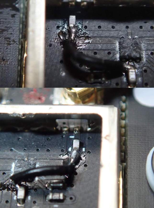

9. When you are confident you nailed it, plug in the soldering iron and do the soldering: with the tweezers hold one of the ends of the wire to the end of the SMD capacitor close to the chip and touch it with the soldering iron for just one second, max. It should stick there really fast. If not, let everything cool, review the solder on the wire and try again. Then do the same with the other end of the wire to only one of the antenna capacitors (again, refer to @agteigarnet post on this).
Below an example of the finished job
10. The choice of antenna capacitor seems to be free. Other people here made it to the top one; I made it to the top one and then changed to the lower one, and it seems to be working.
Below an example of the connection to the top capacitor (top image) and then to the bottom capacitor (bottom image). Notice that in these pics the chip was still attached to the board. It needs to be removed to ensure the mod works, as in the image above.

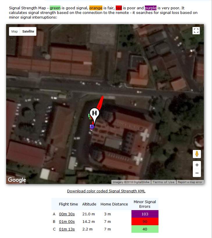

Just for fun, here are plots of the signal before and after the MOD (from AirData)
Before
After

If you got the time could you let me know why you chose the bottom contact after the top one, I might of missed the reason and also I never removed that chip, I was so paranoid of bricking it with just the mod, that removing that looked like a no going back issue,Do you think that dud chip is resisting signal?man I hate opening up that bird, it’s already got a few cracks, but if removing the chip will help the signal strength more then, snap crackel pop.
Thanks again for the great post ,we all have to help each other
Lol, I just read the prior posts before yours that explain the reason to remove the chip,well I guess I’m going in
Sorry for taking so long @Stazz For some reason I am not receiving updates from the forum. Have to check what is wrong.
I tried the top capacitor, turned everything on and received a weak signal loss message. That was why I decided to try the lower one. Still had weak signal after that change. As @agteigarnet mentioned in some cases the damaged may ground and that may in turn make the mod not work. I then removed (with some difficulty ) the s20 chip and it started working. I decided to not move the wire back to the top to reduce the chances of damaging what seemed to be working.
I think the grounding does not have to happen every time. If it is working, I would not risk it, and would leave the chip there.
Hope this was clear.. English is not my first language.

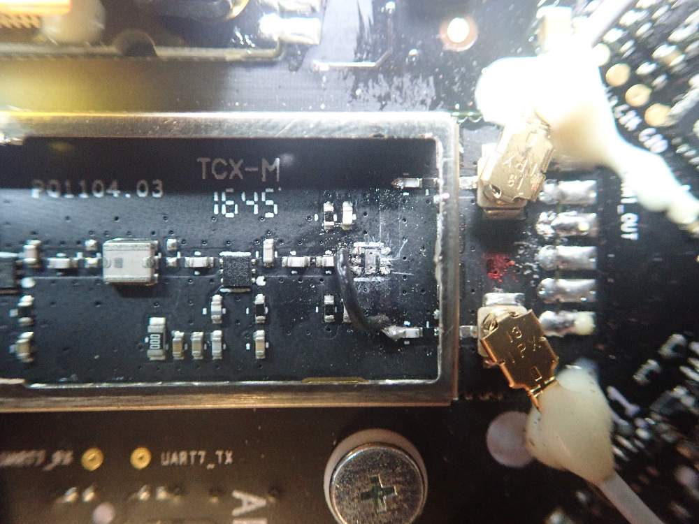

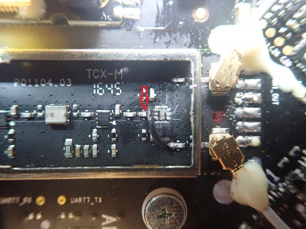

I have just made this mod, however I was not using a kapton tape for protection of adjacent elements when desoldering faullty chip with a hot air and a capacitor that I was supposed to solder a jumper to was blown out :( eventually I ended up with a permanent capacitor damage (the one marked with arrow in attached picture). I soldered the jumper to the capacitor on the left. The range improved significantly, however I would like to make things like they should be.
Can anyone tell me my broken capacitor parameters please?

Well, basically size is not an issue here provided you have to remove a chip and solder a jumper between capacitors. Elements are rare, you have a plenty of room to operate. My bad was I have not used kapton tape and desoldered a capacitor unnecesarily, then it started to be a bit problematic :)
Hi @szupek
I am not sure if I can be of much help. I do not know the specs for the capacitor. The best images I know from a P3 tear-down are those from Scott Torborg (DJI Phantom 3 Standard Teardown) and from those it appears that the capacitors ID is not stated, at least not on top.
They are obviously colour coded however I am not sure if this can help you (I have zero knowledge in electronics). However, it does seem that missing one capacitor may not be disastrous but can cause problems on some scenarios (https://www.electronics-tutorials.ws/capacitor/cap_7.html).
Good luck and if you can, post whatever you find.
