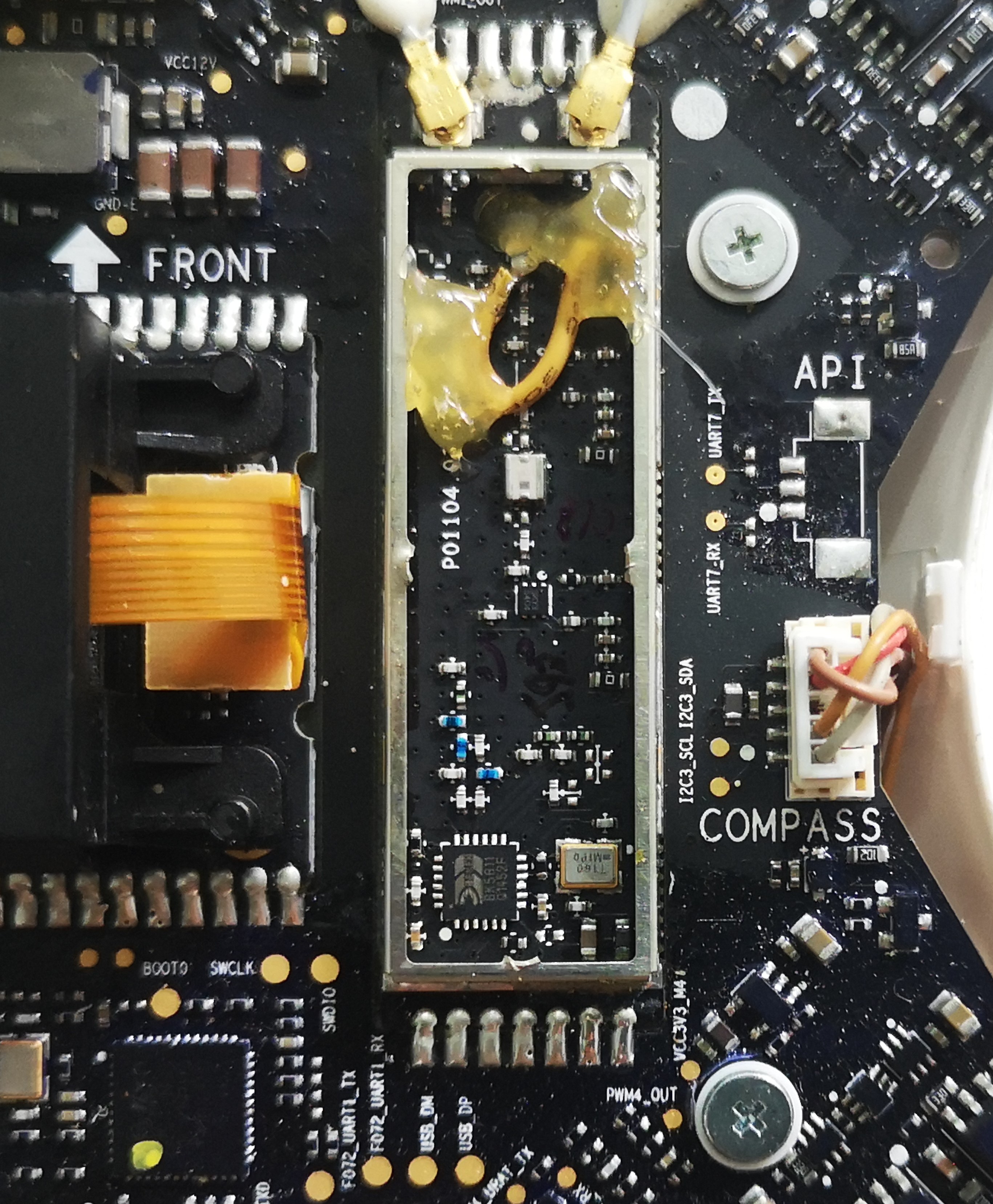

Thank you @HappyStandardOwner and everyone else for the fix and updates. I bought a second-hand P3 Standard with bad RC signal and could not go further than 150 meters except with Litchi where I could go miles away while retaining video signal so that was a good alternative. Obviously i wanted a better RC signal so did this fix together with the Magic power mod and i can confim that the range phenomenal now. Thanks again! Btw i removed the chip with a modded hairdryer, made a cone from paper to converge the flow to concentrate on the chip, it went off easily with some tweasers.
Well i done the solder..... Blinking difficult. They should make it easier lol.
First flight. 30 MTRS every direction. Altitude or distance maxed even though it wasn't according to settings....
Flight two after downgrading fw. Easily reached 71 MTs alt and 283 MTRS distance. That was on a gusty night in a semi built up area. I bottled it more than the drone not being capable. Brilliant fix. Thank you so much ????

I was running the latest but did the magic 5 patch. Then downgraded to 1.9....... sorry can't see at moment as all on charge. Will update tomorrow. Just over the moon tbh. Just need wind and rain to stop ?
Done mine, 1km before signal lost. Then i just turn off remote to trigger rth. **** is hard.1st try the solder came off during landing. Reopen everything, solder and glue it so it cant move. Happy pilot

Could u explain that a bit better
Whats the black stuff u break first....do u mean the actual chip....
Sorry english not my main. Yep the chip.after you break the chip, theres still part of the chip left on the board so i just scrape everything untill no tace of the chip left

I think that my way can help you. To be shure, you can test the cip.
Take multimeter, ohm meter mode. Points 1 - 3 and 2 - 3 there should not be a short circuit. If any of it has short circuit, it means the antenna signal canel connectet to ground - weak signal - chip dead. It often happends while firmware update. Why - I dont know. May be chip owerheting.
WARNING!
Be be extremely careful, during repair. Very small details, should not be a short circuit on any of it. Central platform under the chip is ground. New jumper nowise sould not contact it.
Are there any known cases of this failing open? I have similar low signal issues but chip has no short to ground.

I know I'm late, but had range issues with my used p3s in germany: 150m max. Removed the chip, jumped the 2 points and it works! My chip was shorted to ground on every point. Also managed it with basic 15€ Iron and a flush cutter. Thanks to everyone who contributed.
