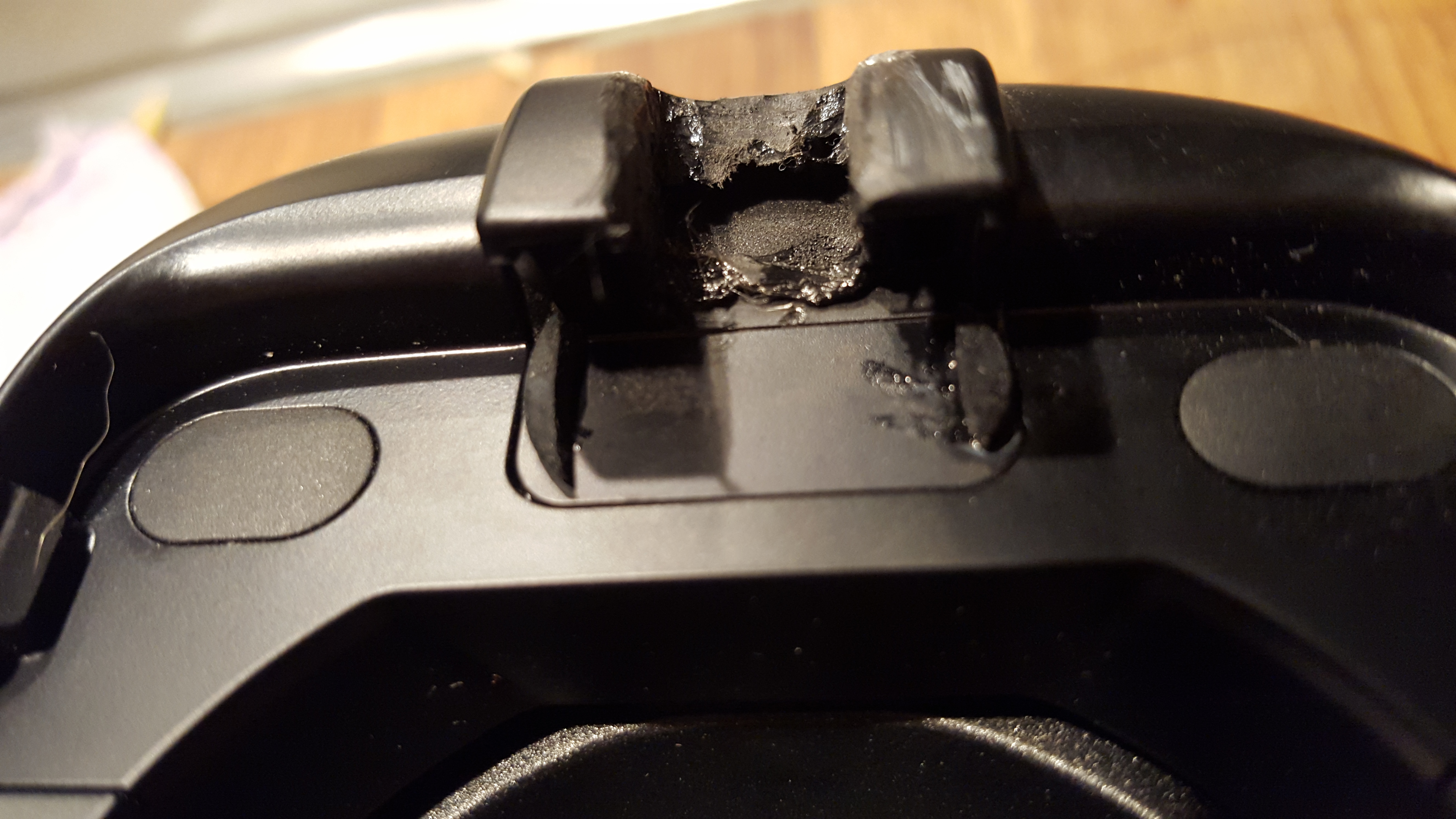

Hi guys. VR using litchi and the Samsung VR is absolutely amazing. It does require a mod so that anot her USB cable can be integrated from the other side of the goggles. This works well as the original USB input does not need to be removed so all normal VR functions remain.
The photo of the mall parts are all the bits that are not necessary so you can create a gap for the USB cable. (I used a soldering iron to burn a hole)
The photo of the mall parts are all the bits that are not necessary so you can create a gap for the USB cable. (I used a soldering iron to burn a hole)View attachment 35639 View attachment 35639 View attachment 35640

I have a P3 and got a set of the Gear VR (note 4 version). Can anyone provide the complete steps I need to do in order to get setup for FPV? I can handle the mod but I can't find any complete details on what is being modded to make this work. Is there a USB connection inside the VR goggles that is actually covered up by the outer casing? Any simple step by step details will be fully appreciated.
