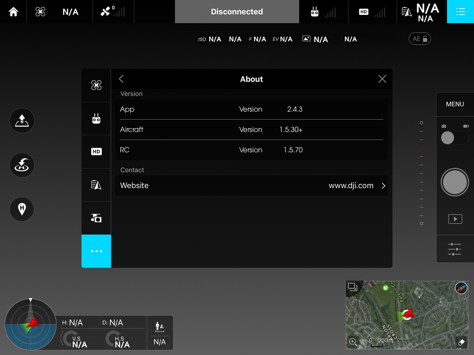

[00075148][11 00][05] v1.7.15.1 -> v1.7.15.1
Found it, thanks, all is good.
