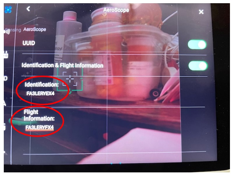

OK, from the beginning, what goes in IDENTIFICATION and FLIGHT INFORMATION?????

Alright, so how does any app sees the drone? Is there a remote ID number somewhere?
Basically the drone creates a remote ID number based on the 14-digit serial number of the flight controller, by adding additional characters before and after the serial number to make a 20-digit remote ID. You will need to register this number on the FAA dronezone website. Go backward through this thread, you'll find all the information on how to work out the remote ID number that is being generated, how to test whether it is being transmitted by the drone etc.
