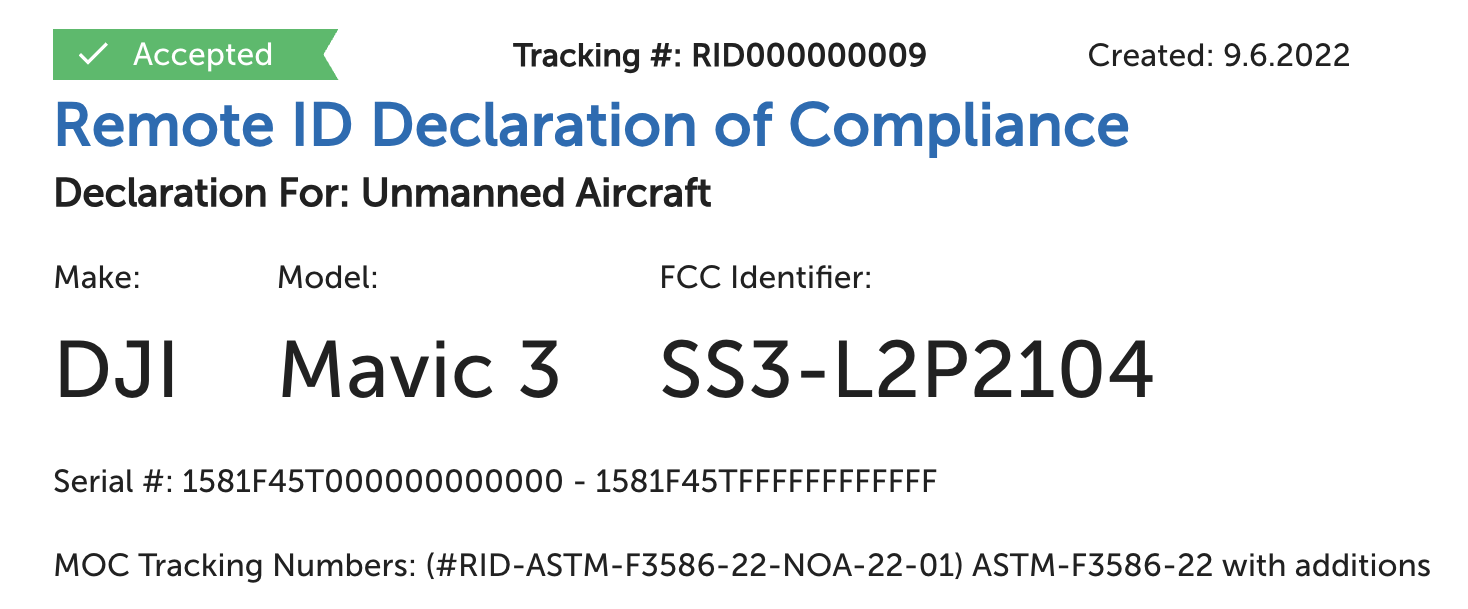

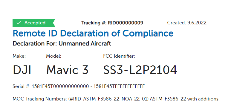

Just adding a note re. the FAA's listing of serial numbers for Phantom 4 Pro v2 ...
On looking closely at the FAA's Phantom page and comparing with similar pages for other models, I totally agree that they are providing a range of serial numbers that are valid; they're just showing it in a different format. For other models it's clearly a range; in the case of the Mavic 3 which shows a range of 1581F45T000000000000 - 1581F45TFFFFFFFFFFFF, I believe it would mean any serial number that starts with "1581F45T" following by 12 characters, which can be either letters or numbers. For the Phantom 4 Pro v2, the range shown is similar: 1581F11V000000000000 - 1581F11VZZZZZZZZZZZZ, i.e. "1581F11V" followed by 12 alphanumeric characters - so basically the same thing. There are only 2 differences, which make it a bit confusing:
-- The Phantom listing doesn't show the range directly on the page, instead you have to click on a link to view it, and then it shows the numbers in a format that makes it less clear that it's a range rather than distinct numbers. But the format of the numbers is so close to the other ones showing a range, that it's clear that this is also a range. Why the page is displayed differently I don't know; maybe the FAA just changed their way of displaying a range of serial numbers at some point.
-- The top of the range ends in ZZZZZZZZZZZZ rather than FFFFFFFFFFFF (which (as far as I can see) is how other DJI ranges are shown). There may be no difference here; they may both just mean 'some combination of 12 alphanumeric characters'. Or perhaps the Phantom serials can contain any letters, whereas the other serials can only contain letters between A and F?
So there are a few things that are confusing here - but overall this clearly indicates that for Phantom 4 Pro v2, any 20-digit string starting with "1581F11V" is a valid serial number.
What I found to be most important is that when you enter a number within that range, on your registration, it accepts it and updates your registration with that number.
