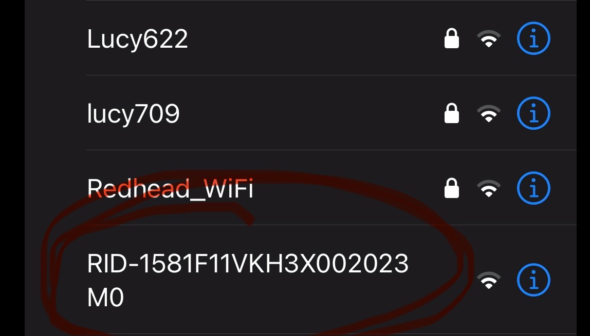

Take your broadcasted RID number and use it to register with the FAA! You can easily find the number on a phone or tablet under your wi-fi tab…

Really not sure why people are making it so difficult to register and see the module is broadcasting. All that is needed to register with The FAA is the RID identifier number that shows up under Wi-Fi.

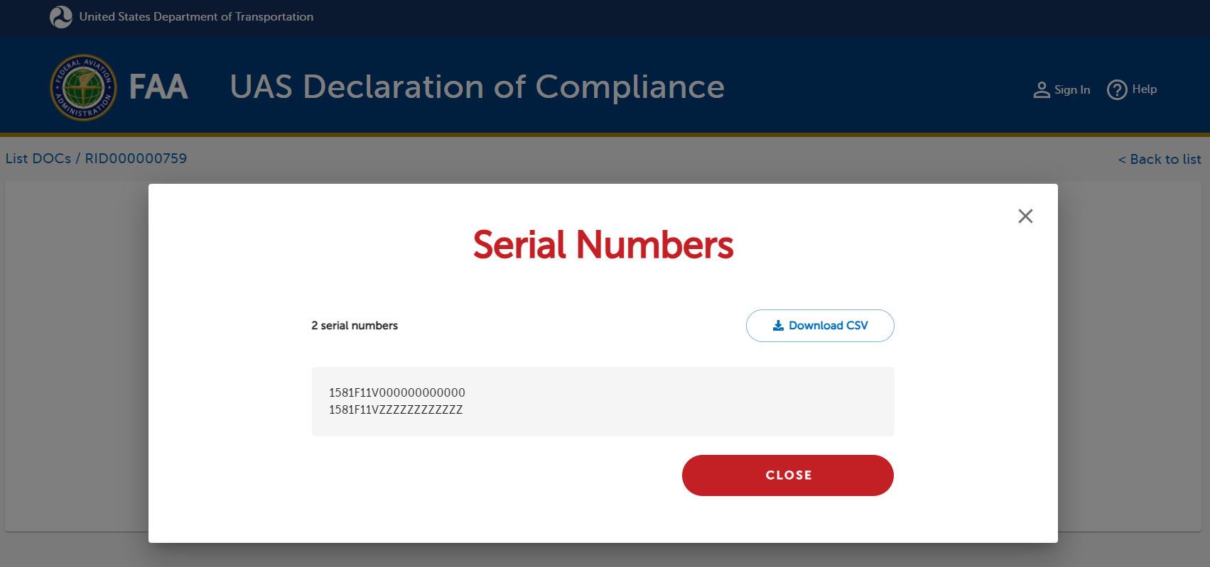

On December 6, 2023, the FAA DOC (Declaration of Compliance) was posted on the FAA DOC database.
Remote ID is now fully official and in full compliance.
Kind of. It looks like the document was either submitted incorrectly or the FAA did not post the correct details as it currently shows these are the only two serial numbers that have been approved for the needed full compliance:
Is that 2 serial numbers or the range of serial numbers?
It appears to be two total serial numbers. Documents for other DJI drones show a range of serial numbers.
