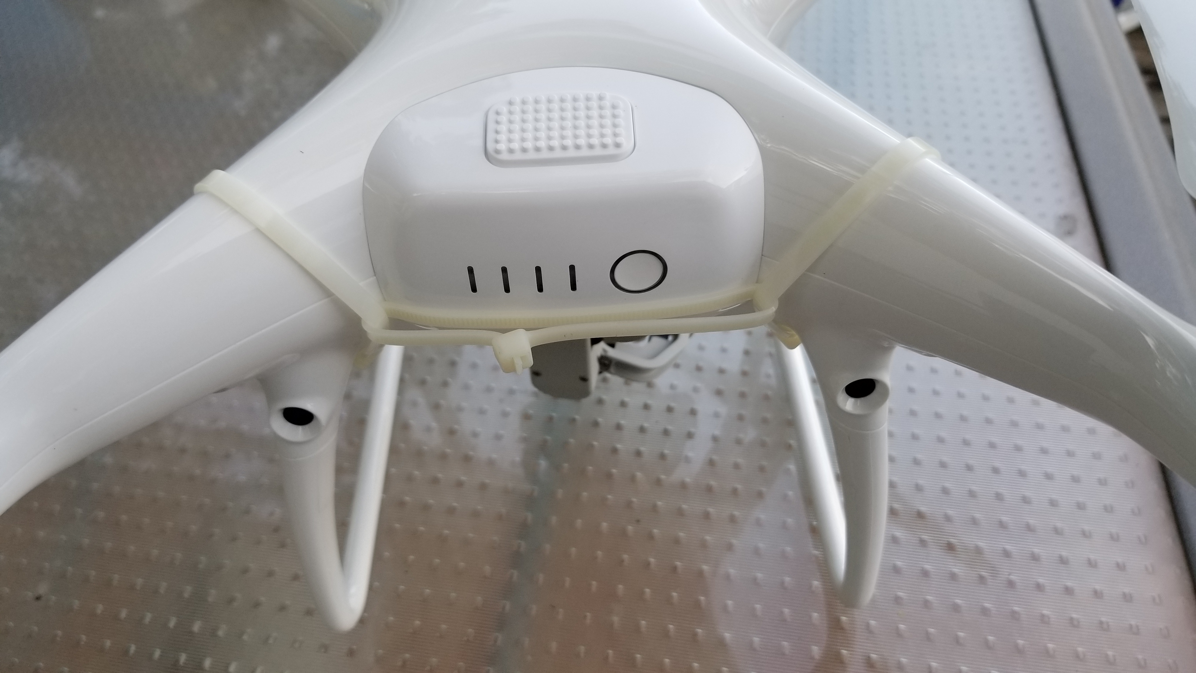

I have been doing this with white wire ties. It works great with no residual until I can figure something out better. I just cost you one wire ties per flight. It's cheap insurance though.I saw this from a previous post.

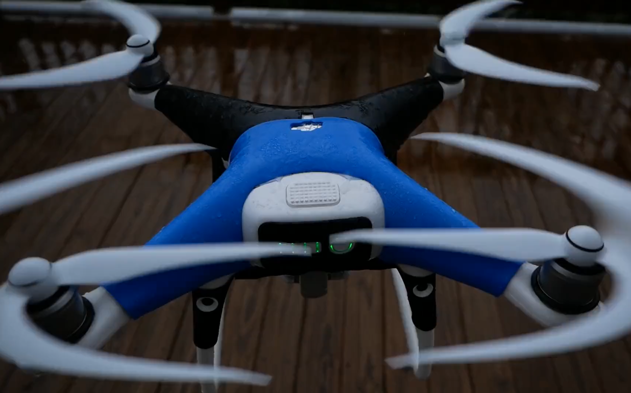

I like this picture as it shows even with the wire ties, you can still see the Gap in the upper right hand side which is apparent on all Phantom 4 series drones including the Newest one .
Although the Gap is smaller the Phantom Rain wet Suit ensures a perfect seal so you do not have to worry about the battery sliding out, or the rain, snow or moisture getting inside the battery.
Even a little bit of moisture in the sky will seep into the cracks of the battery.
Look at the difference between the Wire Ties and the Wet Suit as far as keeping the battery tight and sealed.
You can watch the full Storm Video on are site :
