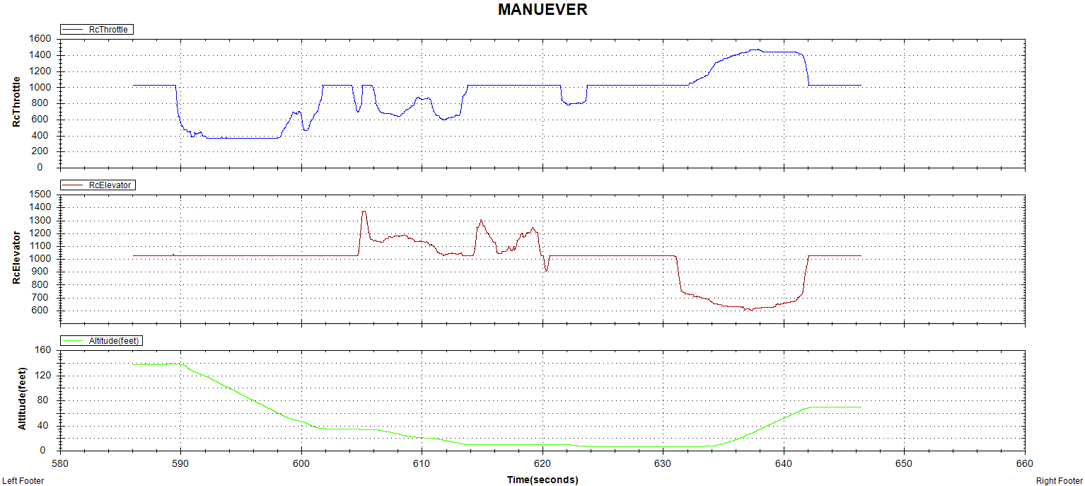

Unfortunately, this appears to be another P4 battery dislodge. I cant be certain but the indications are there. If you were not aware there have been more than a few reports of these verified by those of us who look at data files. This is a known issue with the P4's and is supposedly corrected in the V2 series. Judging by the graph below the severe throttle up and back elevator could be the culprit for dislodging the battery at 62ft. As I said, there have been more than a few of these before. This is approximately the last minute of the flight.

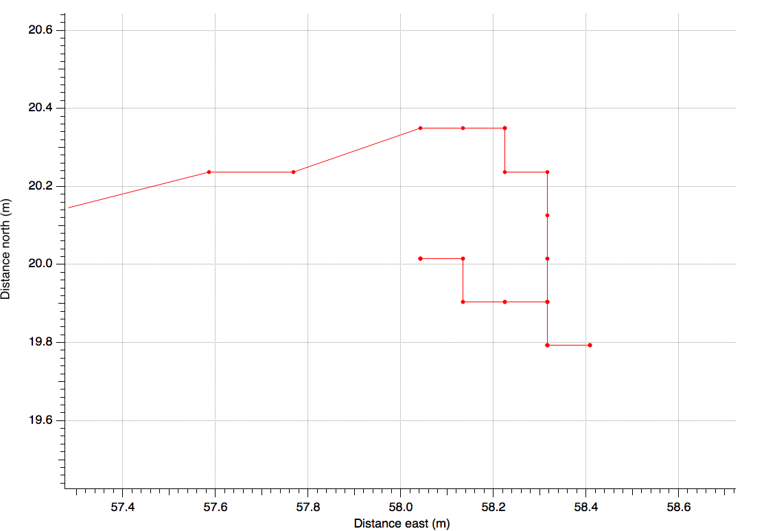

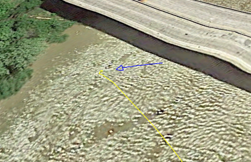

See, that's the thing - I am very well aware of that issue and make sure the batteries are fully seated prior to take-off (hard press in, check tabs). I had thought of this as a possibility (did not have a graph to reference) and even listed it as the first possibility in the write-up. ...but I also did not keep this as the top theory because the P4P was in the air for approximately 4 more seconds after the last maneuver (throttle up, pitch back, which you referenced) before it cut power - based on DJI GO 4 Flight Records log. Since it was in P-Mode, the P4P did do its "forward pitch" thing to stop once I let go of the controls...not sure if that jolt could cause the battery to become unseated...but the jolt didn't take 4 seconds to happen and the P4P was hovering during those seconds but also did a weird "hook" - see attached image. It sure doesn't look like it was self stabilizing during those moments and there was 0 pilot input during that time. I couldn't see it do that because I was looking at the screen and it was too small of a difference for the VO to pick up but that's what the DJI Flight Record and AirData charts are showing.
Now that you've shown me the graph, I can see also see how the data could align with the other battery dislodge cases. How possible is it for the battery to dislodge without actually moving out from the latch? I know that if you flip the P4 series over and press down, you can get the bottom tab to show but not lose power. Thanks for pulling that graph for me.

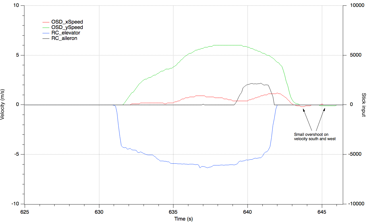

There was no abnormal flight before the disconnect according to any of the logged parameters. The "hook" that you mentioned previously was less than a 2 ft position correction after stopping - perfectly normal.
Thanks for pulling the data and analyzing it. What software are you using to get the display?

The data analysis and graphing was done in Igor Pro.
