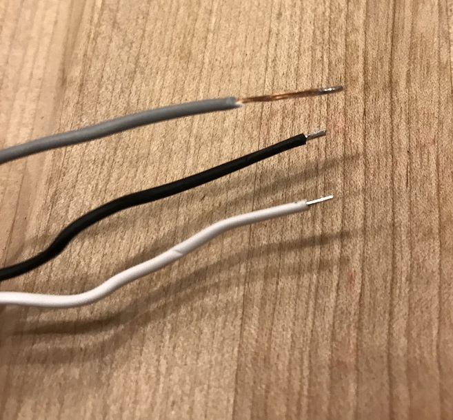

What happened to that grey wire to lose all that insulation?
I stripped it just for reference. It's a spare motor I use just for testing the fit on some 3D printed parts.
