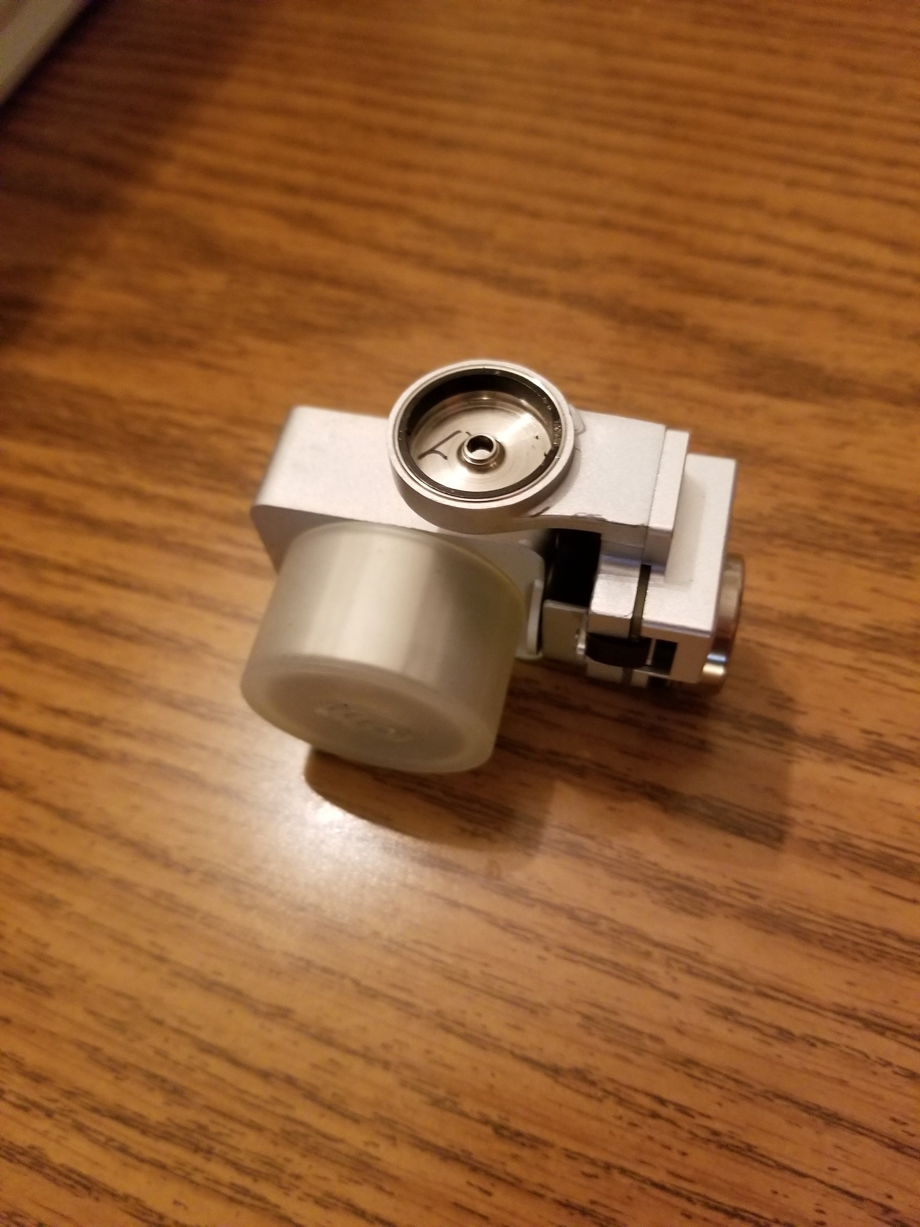

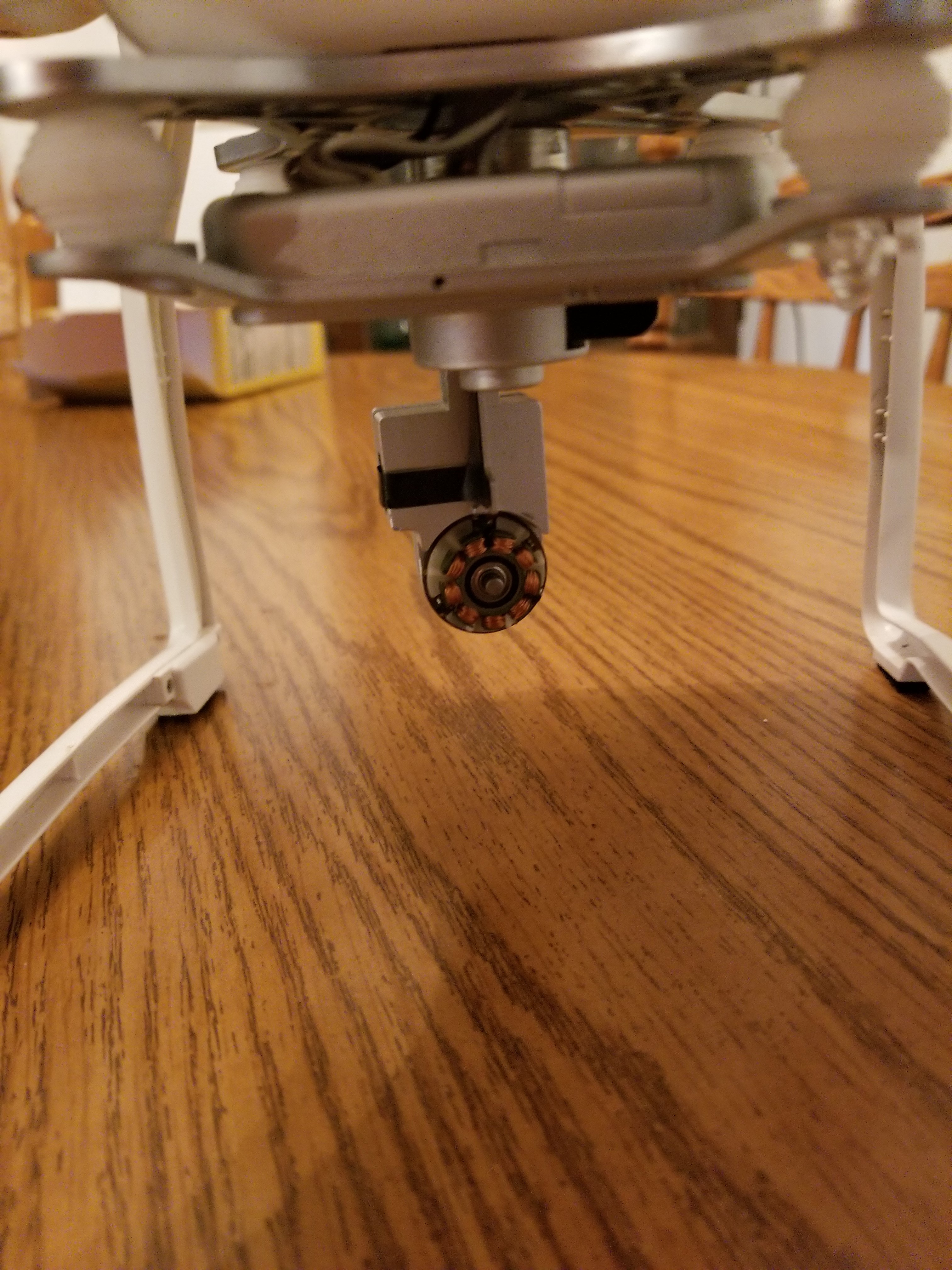

I have live camera feed but the gimbal is dead.
I purchased the P3S 2nd hand and had only been flying about 3 months when i'm not real sure what happened but it was about 50 ft off the ground and just tumbled down.
when i picked it up the camera and the arm holding it onto the gimbal had separated, the motor had actually come apart (also broke 3 propellers and the landing legs).
I replaced all motors and ribbon cable. Now when I turn it on the is no movement from the gimbal and the camera faces down but I do have camera view.
Attached pictures are where the gimbal separated.

"I replaced all motors and ribbon cable. Now when I turn it on the is no movement from the gimbal and the camera faces down but I do have camera view."
What is all the motors?
If you have camera view, can you take a picture? I remember the SD card was in the camera not the main housing of the gimbal?

all the motors on the gimbal
Reactions: RodPad
Did you replace the motors only? Boards are serialized to motors. Change as pairs.

Sure. About motor and board. I have replaced and fixed eight copters. If you only replace the motor the camera will not be pointed where it is supposed to be. Calibration might make a difference if it is close but i have never found a motor swap solve this issue.

Motor ESC chip (circuit board) located on the back of the gimble, controls the gimble motors attached to it. The solder joints can break on impact. Suggest replacing to see if the gimble comes to life. Ones for P3S, available used on line $20+. Don't have one available or I'd loan it to try.

So,,,,, if it would happen to be one of the control boards would the that last motor from the drone like the pitch motor cause none of the motors to work?
or would it be like the first in line causing the rest not to work?
