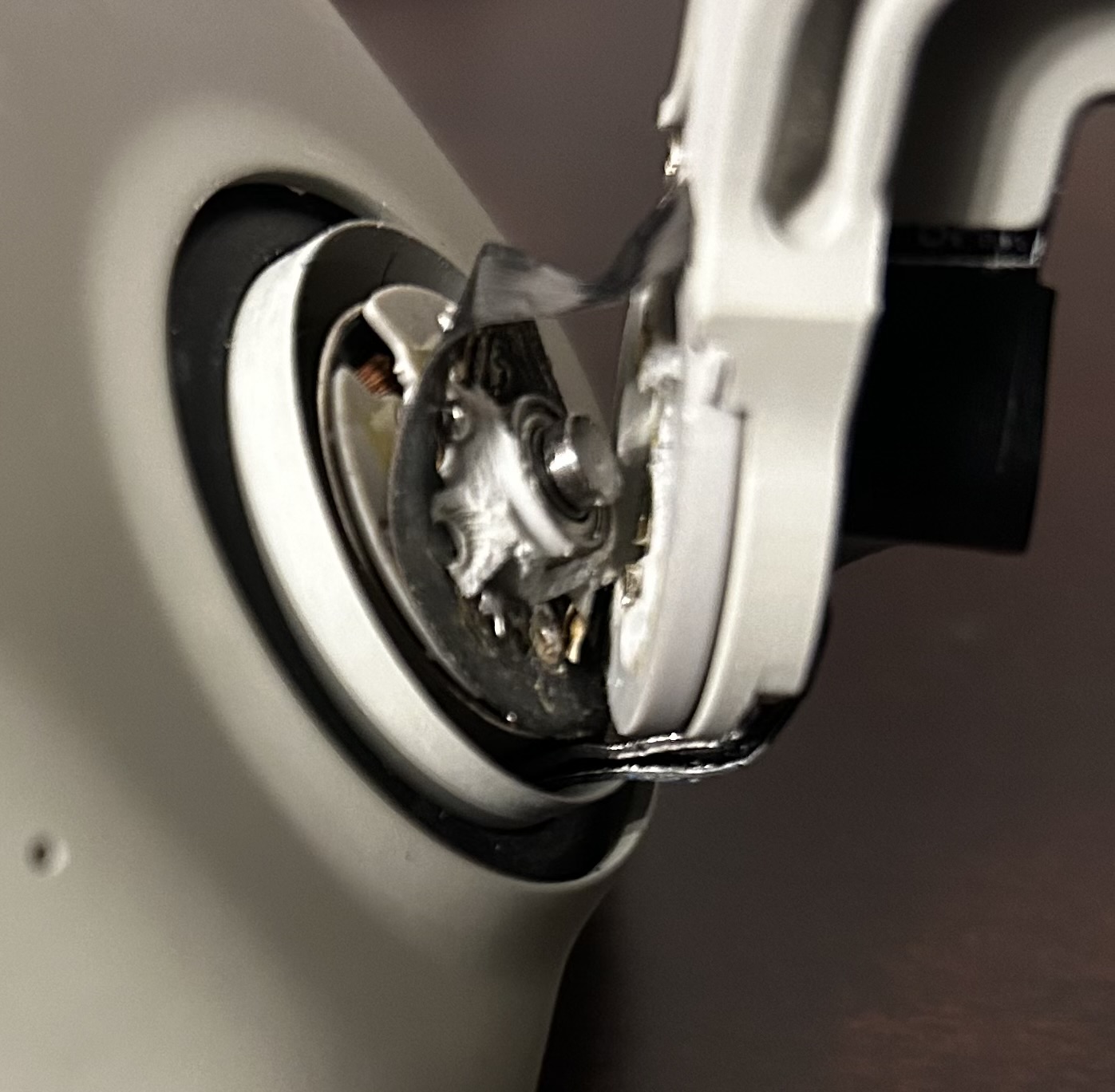

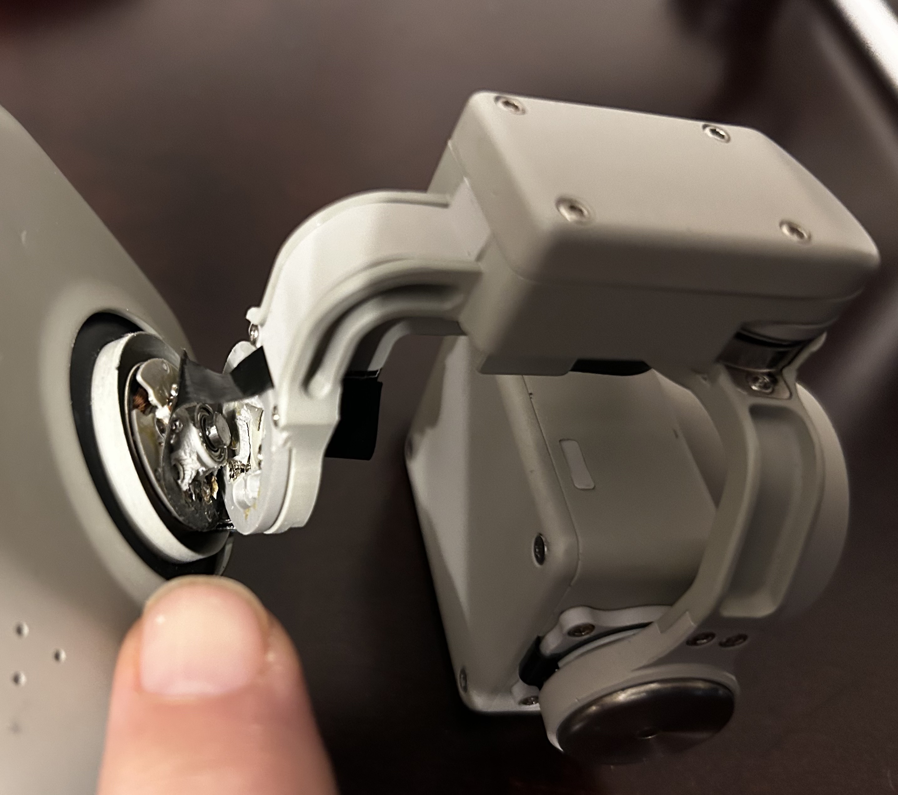

I was coming in to land and received an IMU error message. About 3 feet from landing the drone quickly flipped upside down & hit the ground. The camera gimbal “mount” broke. This is the base mount plate, not the arm the camera attaches to. I cannot seem to find any place online to purchase one. Any suggestions?

Can you provide a photo of the part you are referring to?

Suggest you contact @Droneted as he is our in-house Phantom repair guru. He has videos of gimble repairs on YouTube as well as doing repairs for forum members, including me. Anyways, parts are available on ebay as your damage is quite common. You really should have someone look at the flight logs to find out what actually went wrong before throwing money at a fix.
