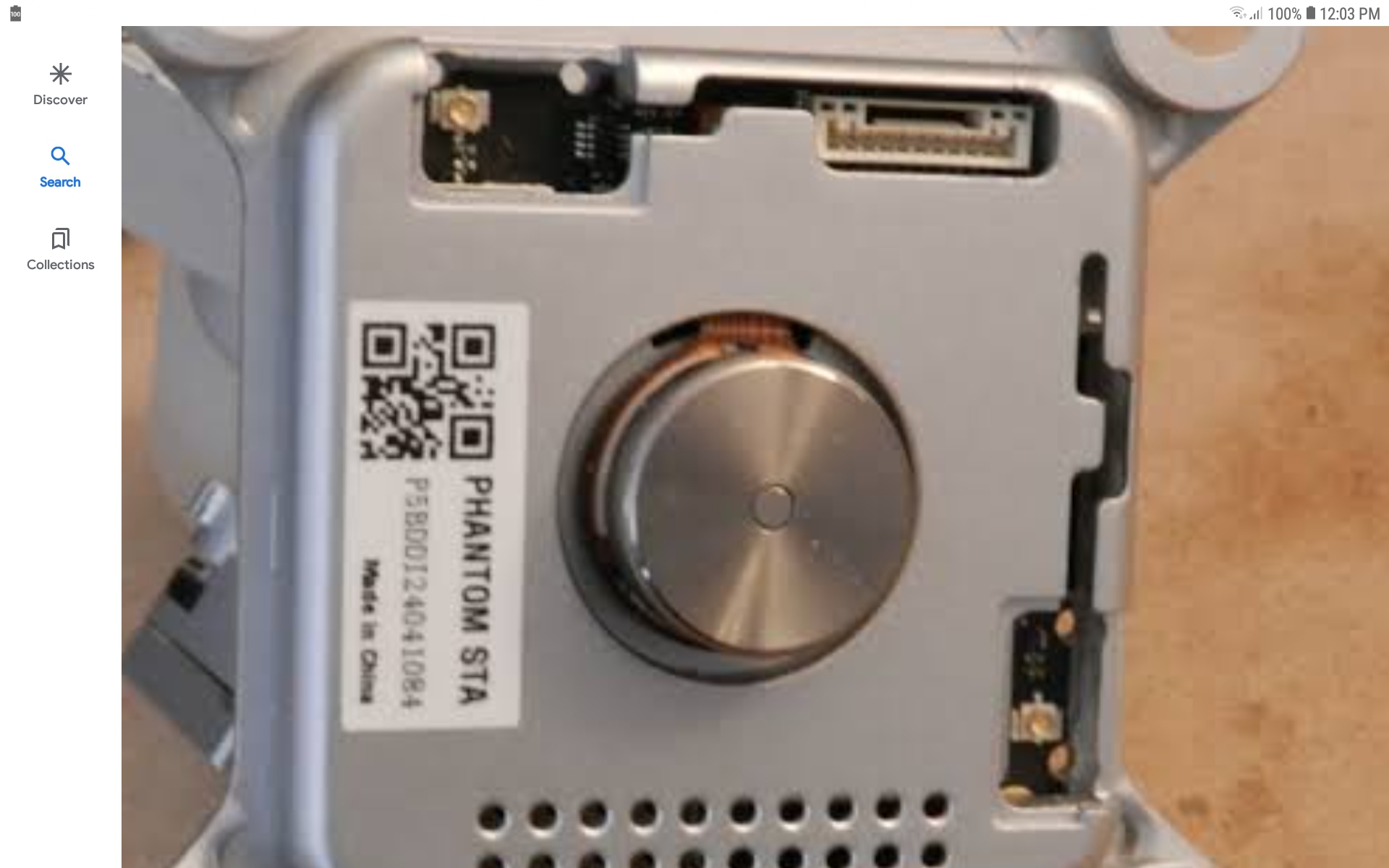

Yes I been following but I think we get a good clue ...
This picture just example of where I think fault is,,The OP mention this motor separated, those little pick up sensors ,,pretty good knock to split the motor ,could be ribbon damage or pulled wire,,
If hes changed other motors and not touched this without inspection,,I could be wrong but I be looking hard at this base

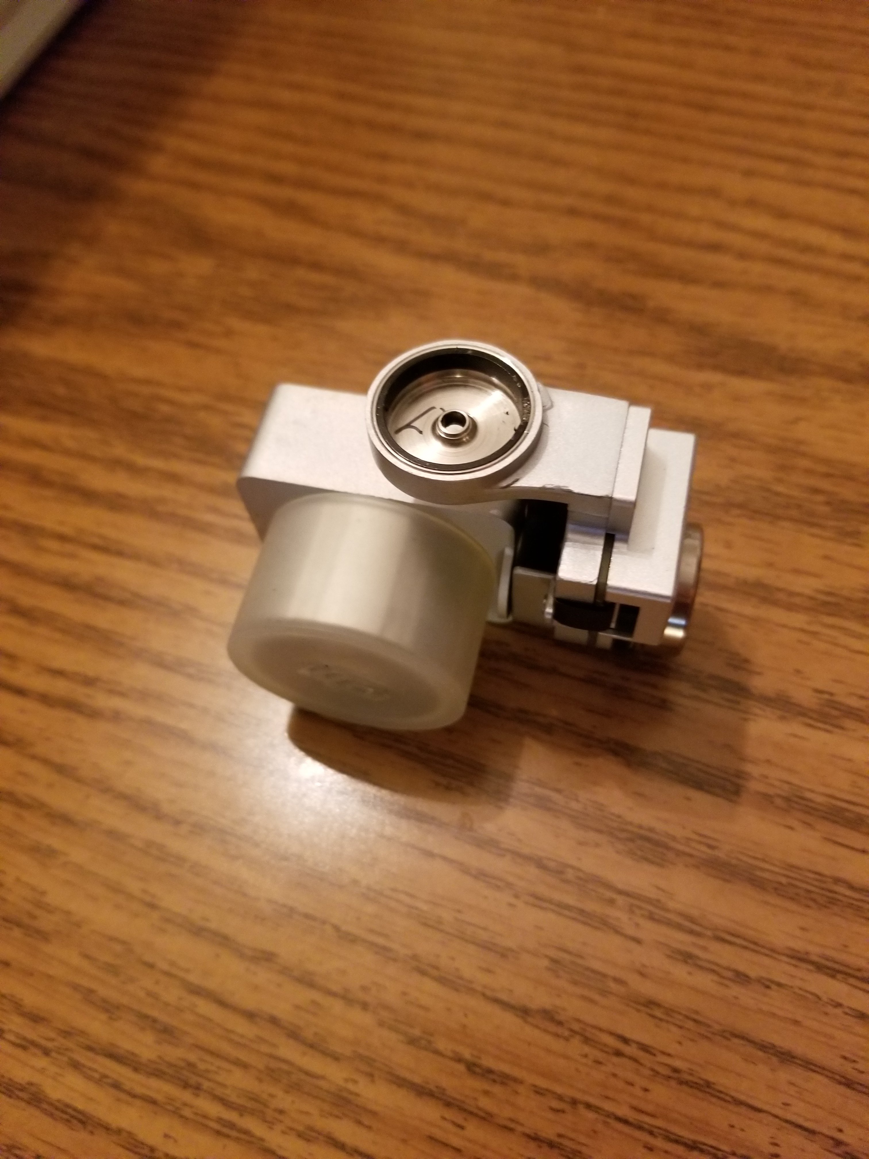

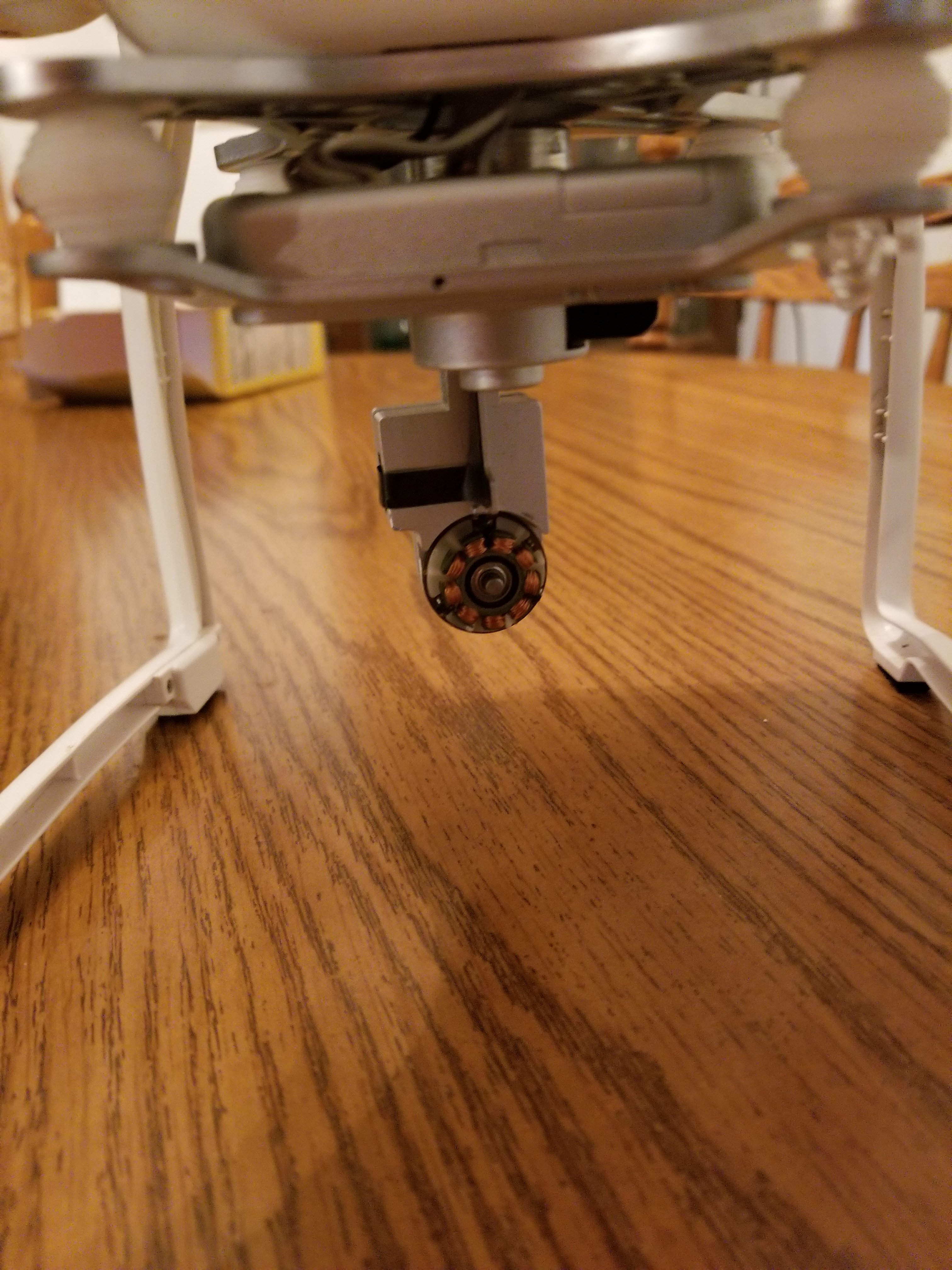

The Gimbal separated here,
What's the connector like on the board,where the ribbon cable plug in,,unclip and connect again,,if the ribbon move or damage it will have dead gimble but live feed,,I go back and read 70 posts again to wake the brain up
And you can upload flight log here and someone tell you what cause the free fall if your curious what happened
i've replace all the motors and ribbon cable (twice) 1st and aftermarket 2nd OEM .
i will upload the flight log this weekend when i get back home
there's 2 on the gimbal arms and one at the camera, I replaced them,
I'm not sure if that is actually a motor that goes through the gimbal base or not but I did not replace it.
Yep I misread which motor seperate, sorry, senior moment thinking again
yip one in gimble base a motor as to why there's friction on it when powered up,,I'd say if you've changed motors,ribbon cables,,it could well be the board where ribbon goes in at the base,,I couldn't find if you been in the base itself ,,without having spares to try it's a guess and sucks buying bits when they not the fault,,,In this case you might need to,,at least they become spares for future,,
If its apart you might be able to trace with multimeter ,,oh the joy of phantom fault finding,🤕
