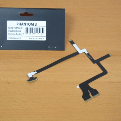

Sounds like the dreaded ribbon cable is damaged. I'd start there, and replace it with a 100% DJI OEM ribbon cable...........NOT a cheap 3rd party knockoff cable. They rarely work correctly.
Not sure which drone you're working on @dougie, but DJI OEM part numbers are:
DJI Phantom 3 Standard is part number # 85.
DJI Phantom 3 Pro/Adv is part number # 49.
It will come in a smoke colored bag with DJI logo and info. They may be hard to find, since DJI no longer supports the Phantom series.

Yeah, those ribbon cables are extremely delicate, and have hair-thin wires that break easily.
Just be sure it's a genuine DJI OEM part #49........and be patient and take your time swapping it out. Good luck..👍

One quick question. You said you replaced the ribbon cable, and it is new. Is it a DJI OEM cable #49? ......or a 3rd party ribbon cable?

No, I didn't use the DJI OEM cable #49, I've used a 3rd party ribbon cable because I bought it along with the gimbal Yaw Arm from AliExpress to save some money.

Not sure if there's a way to check gimbal video transmission and other components without extensive diagnostic equipment.
The problem may be the third party non-OEM ribbon cable.
However, as stated before (and other members will back me up on this) aftermarket ribbon cables are notorious for being defective and unreliable. Plus, USB cables (R/C to device) must be a 'high quality DATA TRANSFER cable' .....not a charging cable.
You stated in post # 12 that you can take pics and videos on the SD card, so the camera is working. But, the live feed is not making it to your device (USB cable).
Other members may offer their suggestions, but if it were me I'd install a correct DJI OEM ribbon cable, Part#49. ........and confirm your USB cable is a high quality data transfer cable.
Hi,
Thanks again.
Yes, I'm using a High quality USB Data cable, and I actually tried several, in addition to the original USB that came with the Drone.
So, it looks like the only reasons left for this problem are:
1) The 3rd party ribbon cable
2) Video transmission system on the Aircraft
If anyone on this forum knows how I can check the video transmission of the gimbal and the communication board components for any potential issues, that would be great. I do have all the tools available to check potential electrical issue and I can solder smd components.
Thanks and regards,
Salvo
Hi,
Thanks again.
Thanks and regards,
Salvo
Ok guys, I'm out of ideas. Any of you 'electronic wizards' got any ideas on how to complete the diagnostics on the gimbal and communications components, please offer your expertise.
@quaddamage,@crash1sttime,@Capt KO,@Harleydude,@RodPad@brigerdrones + many more.....
Reactions: RodPad
@dougie , @salvolg80
The no image transmission with a P3P is historically one of the most common issues with P3Ps.
Over the years, we've routinely directed people to the flow chart put together by @quaddamage
Thanks for finding that @Oso . I looked for it but had no joy.....
Reactions: RodPad and Oso
