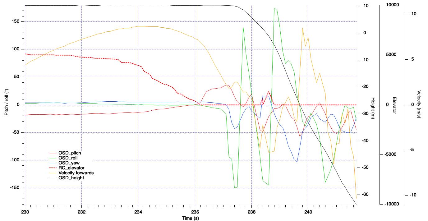

The speed error is unrelated to the incident. Those occured during the tumble. That is related to the IMU positioning and Velocity Calculations. It certainly looks like a lost prop as you released the elevator.
It wasn't a lost prop - the frequency of the oscillations is too low. Lost props result in periods of around 0.3 seconds - here it's over one second. Plus the OP stated that all props were in place after the crash. I'd look for a motor problem, probably front left based on the resulting attitude change (pitch forwards, roll left, turn CCW) starting at 237 seconds..
Indeed there is certainly heavy rolling in there (now that I know what I'm looking at :cool: My first response to OP's comment about a strange noise from one of the motors:

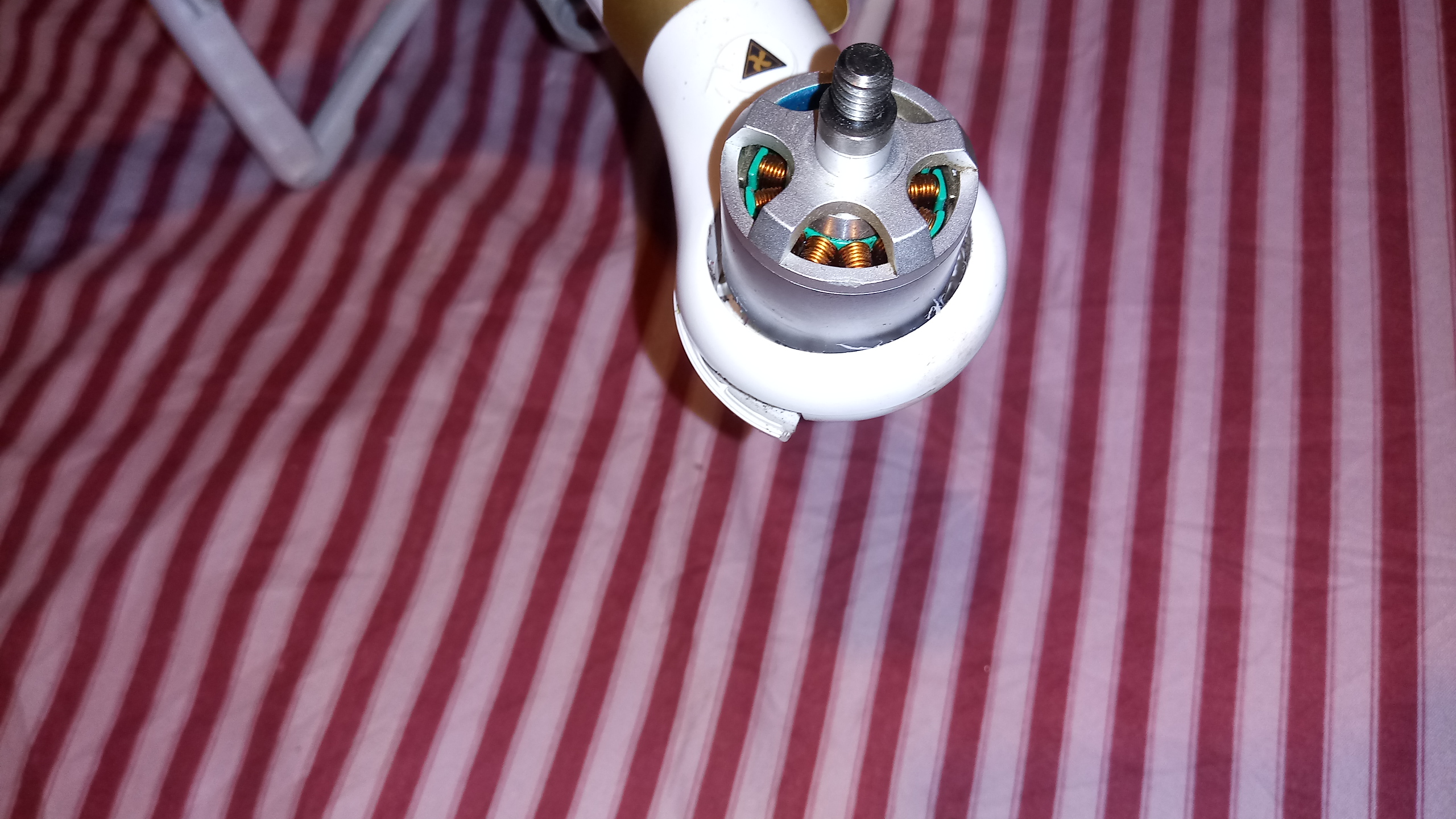

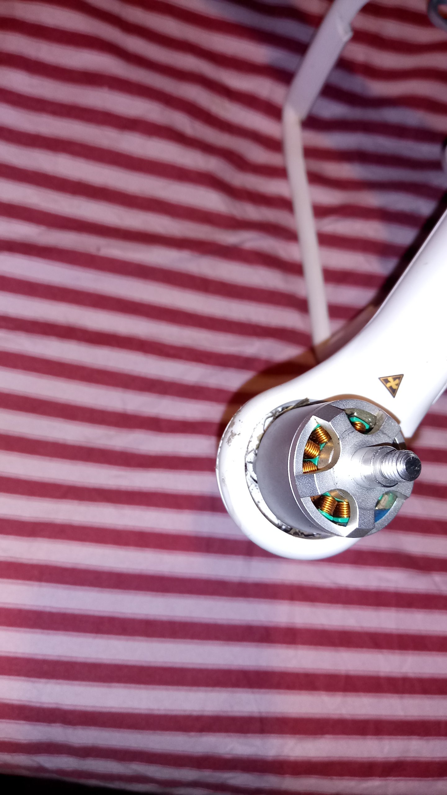

Which motor had the grinding noise?

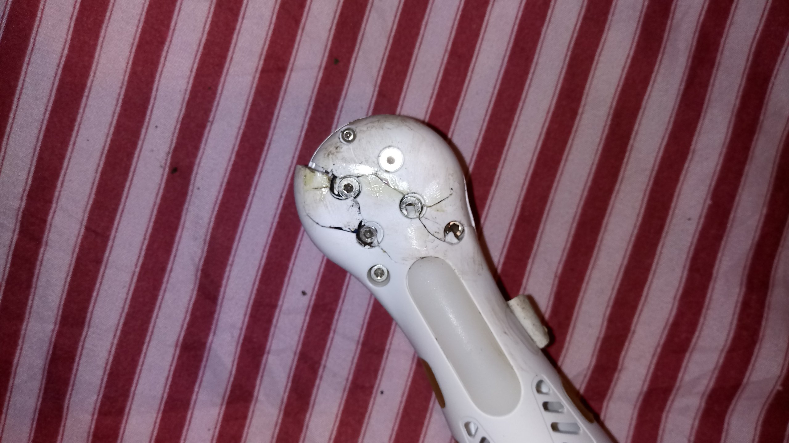

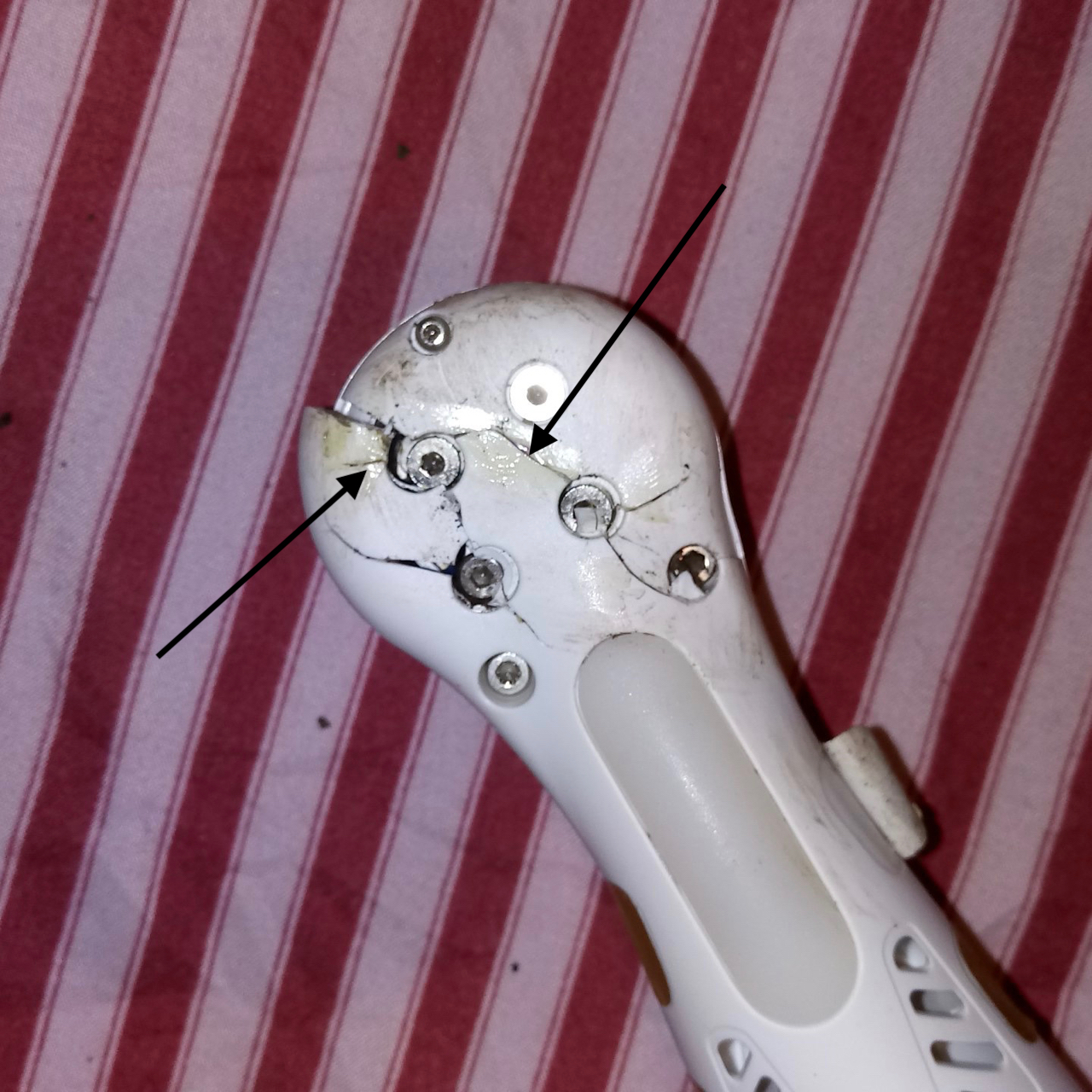

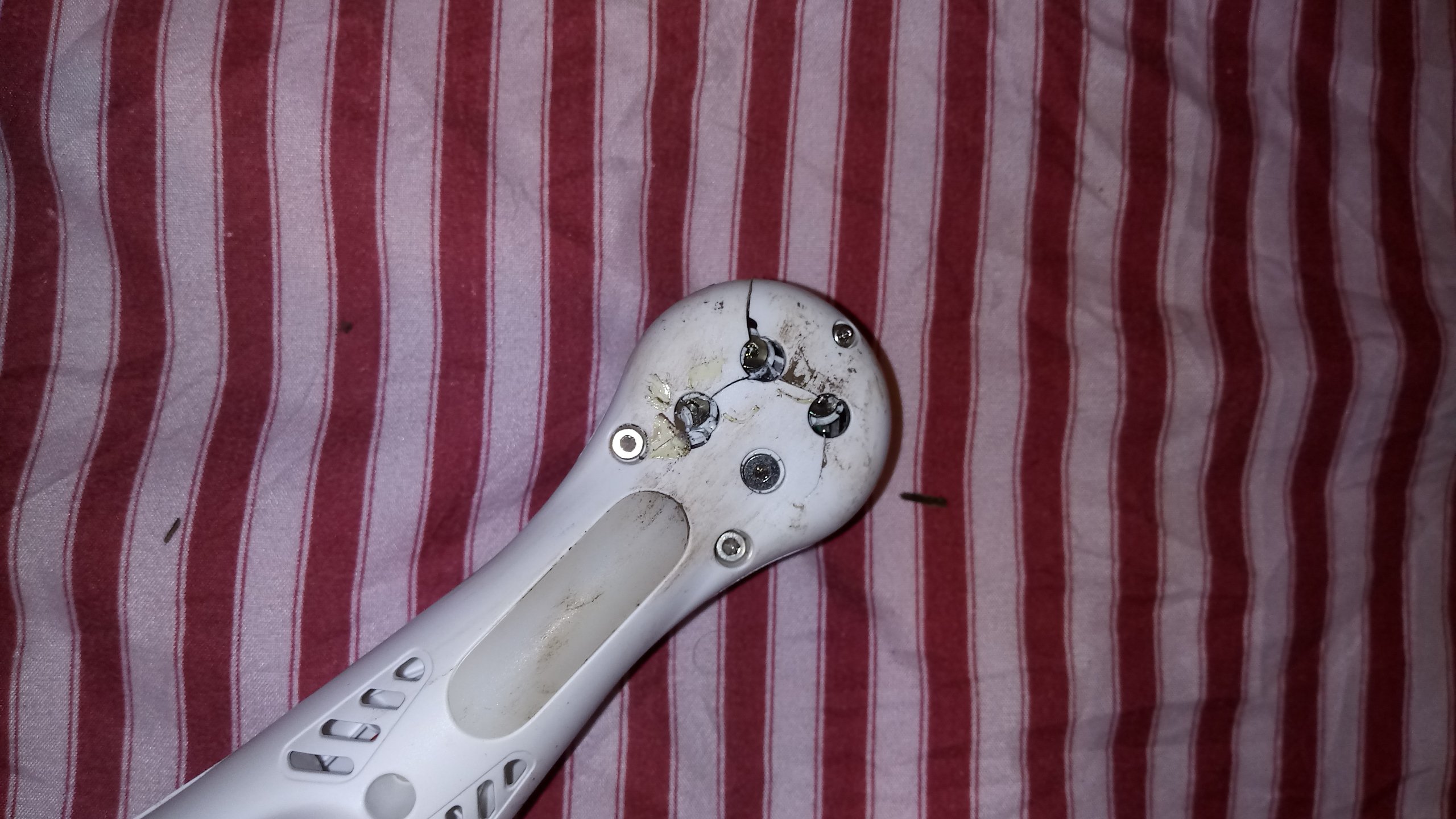

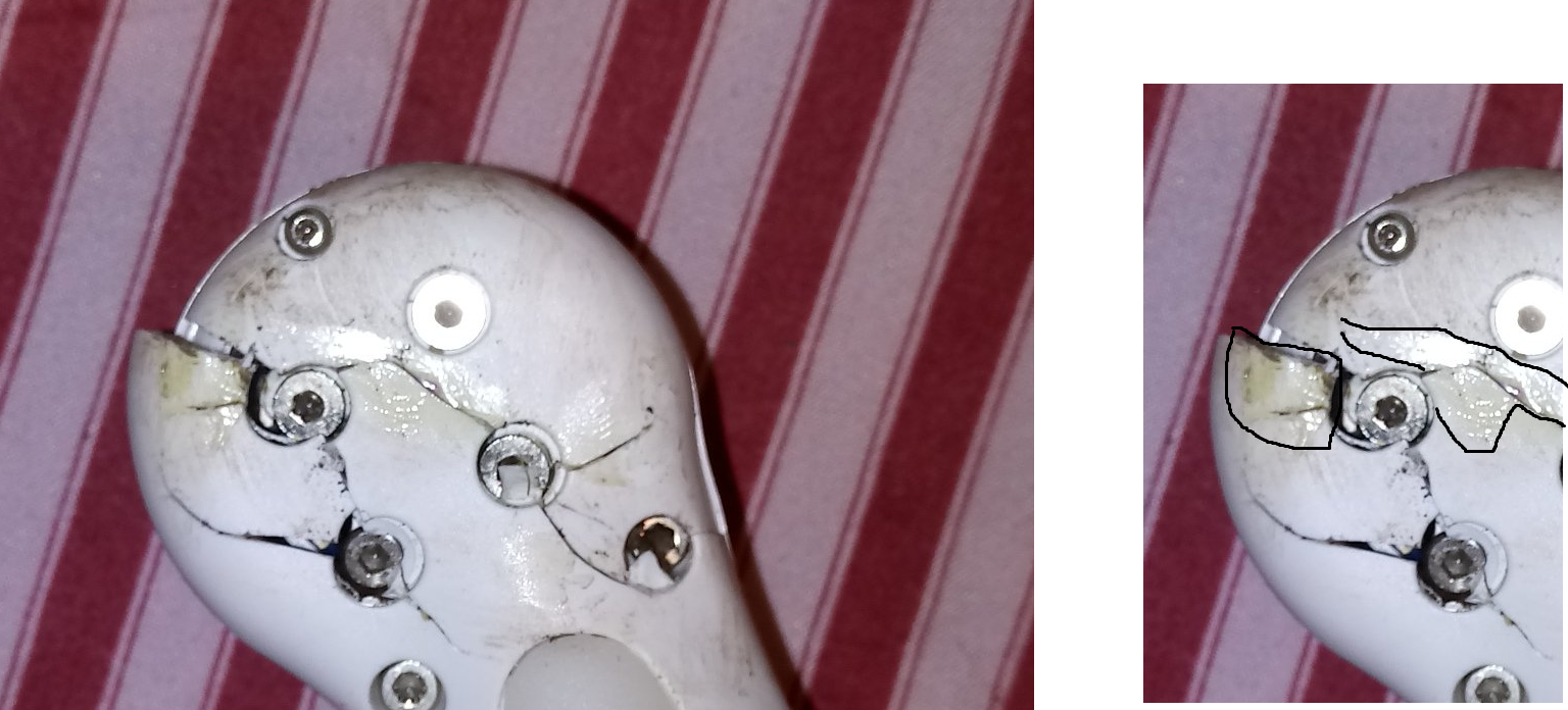

Those two arm ends are 'not good' to say the least. I have out lined two areas in black in the attached copy of one of your photos. Are the smears within those outlines glue?
If so, I wonder if at least one motor effectively broke loose and is the cause of your crash.

Ye Gods, were you flying with those "repairs" to the arms"? The motors attached to those arms would not be vertical and possibly were in contact with the edges causing malfunction or, has been suggested, came lose.
Reactions: porrascarlos80

Yes, appreciate that PF. Really meant that the "repair" on those arms are pretty crude and probably don't have the motor in its correct alignment.

As far I know this aircraft didn't have any repair with glue made to the arms. For sure I wont even attempt to do it :) .

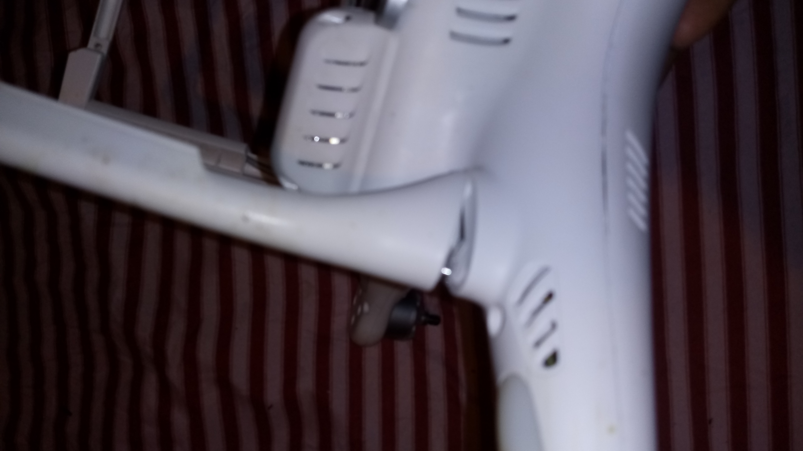

Now the failure of a motor makes sense because I heard like clash, a prop hitting aircraft fuselage and actually if you see the pictures one side of the aircraft top cover has a hit of what appears a black prop trying to cut it .... not sure if it was on the fall or the root cause. Now I was using firmware 0030, any known defect of that one? and if I upgraded how to roll back?
Sorry Parrascarlos80 but these (arrowed) cracks have definitely been repaired with Araldite or similar glue to try to hold them together at some time in the drones life! You can clearly see the yellowish tinge against the white plastic shell and I would suggest that this is the root of your problem, a failure of these repairs allowing the motor to come lose and the propeller impacting against the shell.

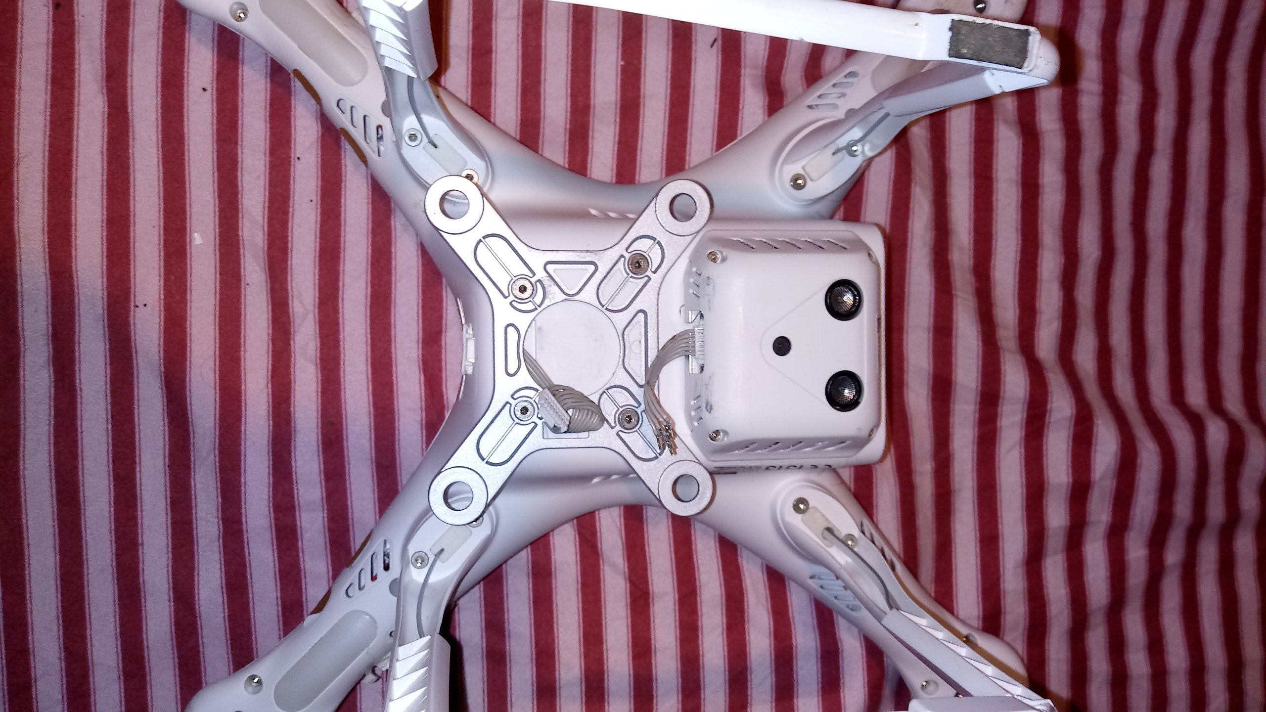

Can you post a photo of the mark on the top cover?
Your shell's lower half is beyond repair but they are new shells are available on the likes of Ebay and Amazon....HOWEVER since yours has the motors with coloured screw shafts you need, I think, the older type of shell, see New? Shell Differences .
